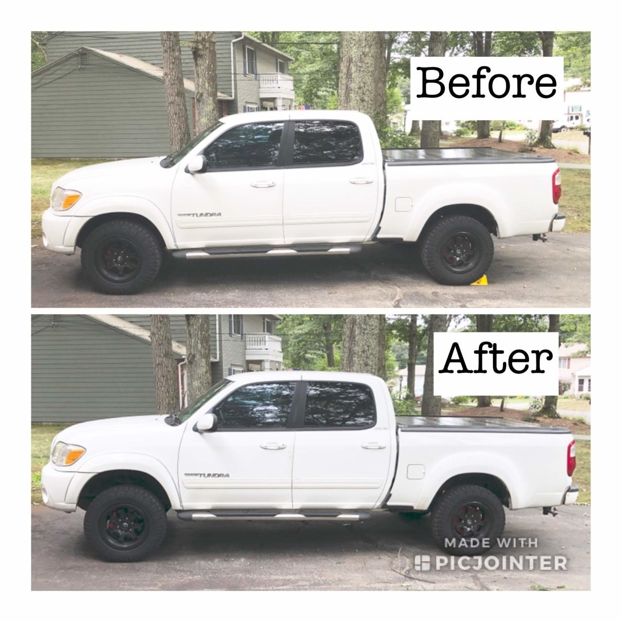

    Went with the 2.5" Rancho Quicklift Struts. Happy so far. Thanks to everyone for the help!
