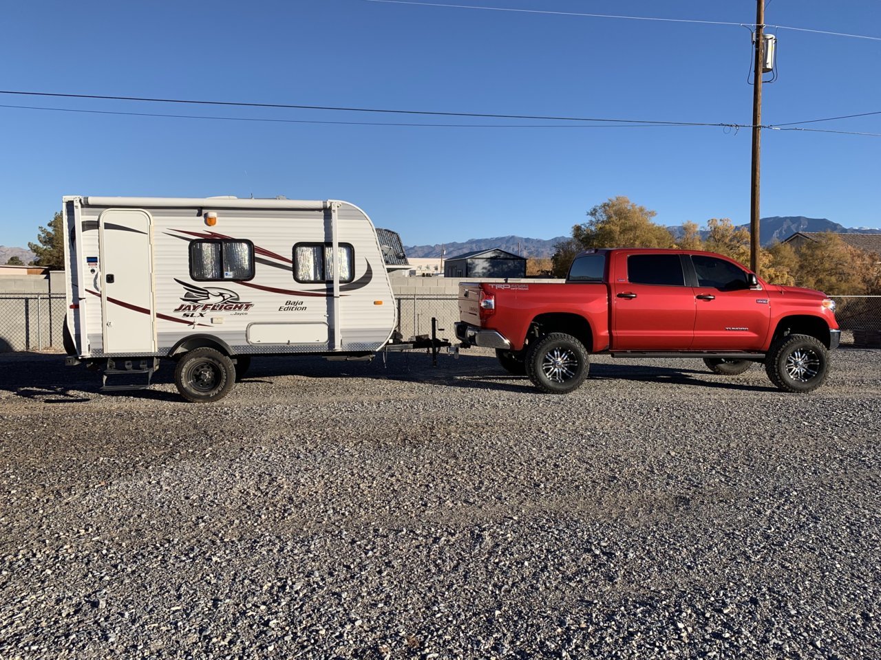

    I just purchased a new 30-ft trailer, my truck sags a bit so I purchased the Firestone ride right air leveling kit! However looks like I may need a spacer under the bags! Any idea on which size? I'm kind of unsure...
    Truck currently has a 6-in pro Comp suspension lift... 2011 tundra..

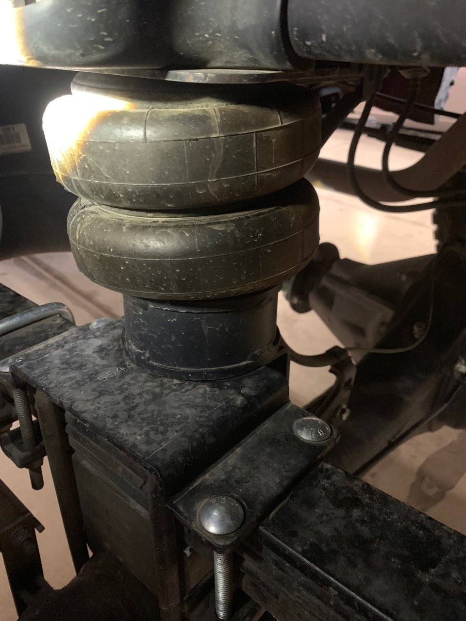

    2018 TRD Sport
