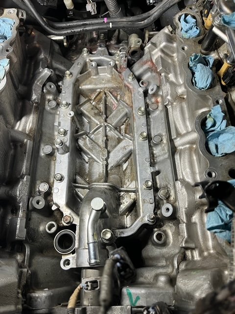

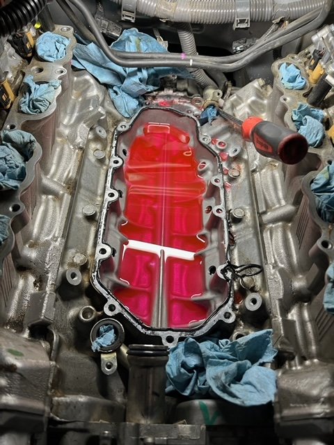

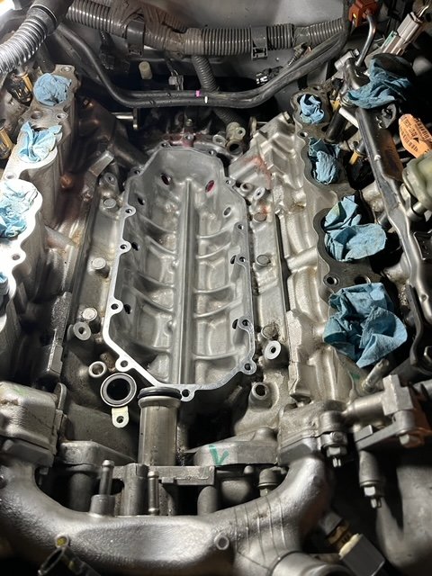

    In March '21, I bought my 2021 Double Cab, mostly as I wanted the supposedly rock solid 5.7L V8. I was well aware of the cam tower sealant leak issue and was assured by the sales dude that it was no longer an issue. Not that I completely bought the explanation, but it wasn't a deal breaker for me. Prices were starting to climb and inventories were dropping. Anyway, a few days before I brought the truck in for the 5k checkup, I popped the hood and noted that the coolant level in the reservoir was low. Didn't cross my mind that there might be a bigger issue - just thought somebody screwed up at the factory. At the 5k checkup, they put the truck on the lift just to take a look underneath and sure enough there was a bigger issue. Visually, there was quite a bit of coolant splattered all the way down to the transfer case. As was later determined when the engine was dismantled, there was a coolant leak near the heat exchanger buried deep in the engine block due to a FIPG sealant failure. I'm guessing some of you will have schematics and can better describe the issue. Feel free to chime in. Regardless, this was a major manufacturing defect out of the factory - not what one expects when buying a Toyota. My 2005 Tundra has had no major issues in 280k miles. I wasn't expecting to deal with any issue of this magnitude with the '21 Tundra for a long, long time - if ever.
    Since I bought my truck in March 2021, I'm guessing the engine was manufactured in February 2021 and possibly earlier. I also later heard the dealer that fixed my Tundra had another Tundra in the August timeframe that had a similar FIPG sealant issue. Based on these two data points, it would appear that Toyota had a manufacturing process issue between February through July at a minimum.
    Yes, the issue was fixed under warranty but still leaves some level of doubt in the overall build quality. I am interested to hear of other similar experiences and also the technical assessment of the folks here.

    Do you think this issue has the potential to be a slow reveal on x number of other 21's - similar to the cam tower leak? I suppose I'm glad my issue was identified early without any damage from overheating or other. But want to make sure other '21 owners are aware of this potential issue in case they suffer a sealant failure later on.

    Yes, I would be curious on the root cause of the issue as well. The tech that worked on my Tundra thought the sealant failure was due to surface contamination when the sealant was applied in the factory. But that was just his guess. Guessing some Toyota engineers are trying to figure out root cause and potential number of engines impacted. Not that any such information will be released to us. I just hope all failures are fixed under warranty.
    You're right though, I'm guessing/hoping the sealant didn't fail - as my thread title states. It's probably a seal failure that technically can be corrected. But from my data points, there's at least 6 months of production at risk.

    My initial comments were based on a relatively brief discussion with the Toyota tech who did the warranty work. And on top of that I'm no engine tear down expert or even a rookie. What I do know is that a lot of parts had been removed from the engine to expose a component in the engine that allowed the antifreeze to (as I understood it) circulate and assist in regulating engine temperature. I don't know all the specifics of the leak but the FIPG seal in whatever it might be called other than heat exchanger failed, which allow antifreeze to leak out onto the transfer case area. Frankly, I was so pissed off on having a major defect issue at 5k miles, I probably didn't hear all of the explanations or information provided. But I was hoping to provide enough information for someone who could fill in the blanks. Not looking like that's the case.
