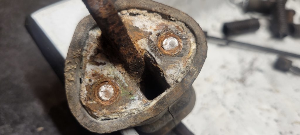

Figured out why my parking brake wasn't working..

    That’s what happens when you don’t use it.

    I was a big fan of the powder that floated out when I pulled the boot off. Some combination of mold, salt and rust.

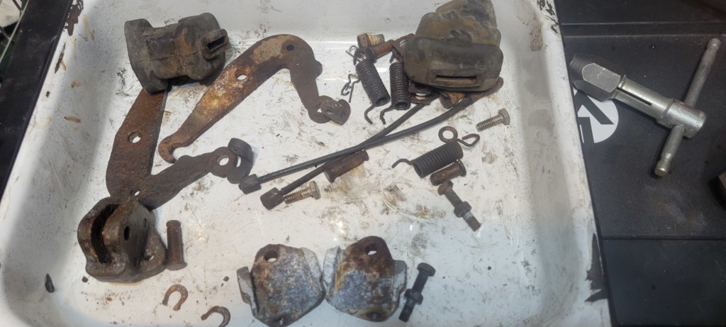

    It's aluminum, but not sure cast would have been much better in our region/salted roads. I did this when installing the new Dorman set. Pumped it full of grease.
    One of them actually broke in half when I tried to free it up. Had not moved for years
    https://www.tundras.com/threads/rear-brake-adjustment-theory-and-practice.99575/
    https://www.rockauto.com/en/moreinfo.php?pk=4199121&cc=1357938&pt=20057&jsn=629&_nck=HllVxRCey1+2aVRDo41oQXhbegy63eH0moU/LzS2Xgr8r9/c9JPjlgS8r6nZvnUyXMFmmnSDTK857VjxV+pLhHzh0scfnaArxfEM2XarFr1RPZG3UINj0x+m8z2VSE0m8ruEjJXiME5WUaUS7A8bV1GAkMU5V0tzBdByV3/F385GrV67+GlkXw9Dhlav6+BuR5BgsOcpelkWMJMoSMerwF3QfwryTdfjZqbs3QAO13W53SovrMBiQiTHLfbVIS0NEhLkwv+pC5ZolRhCXgQnt19yrBLBi7TrVNx/VNjQTjQ=
    I see you have an 02, so this set is for 2000-2002.

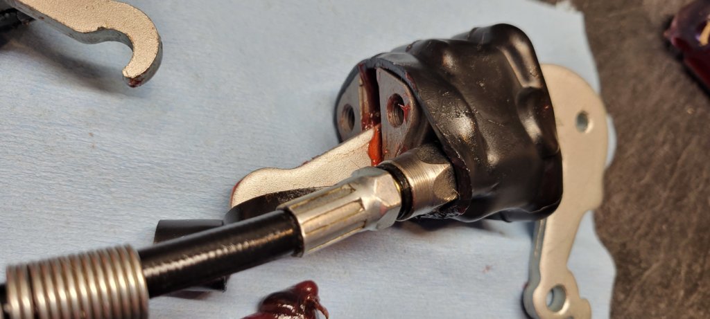

    Thats clever. I installed the Dorman set from O'Reilly's and greased tf out of it. That and new cables front and rear from RA, and I actually have a brake again! Not terribly difficult to do, couple a pita areas.

    I actually take mine apart, sand the rust off the pin and grease the whole assembly every few years when they stick.
