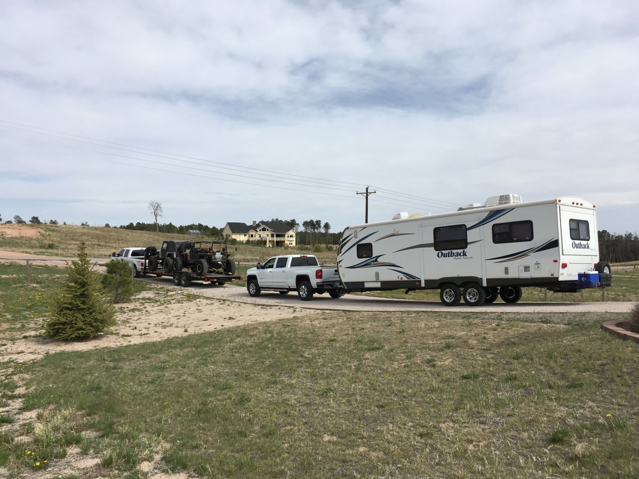

    Looking for some advice on fiberglass repair on an RV.
    There was a prior repair done, and I plan on cutting this crack out, using epoxy to set new fiberglass, then this is where my thought process goes to pot.
    I'm sure I use some resin to bond the two fiberglass pieces together, sand, paint, and then put graphics back on.
    @DecalsByDesign and I have been in contact for a new side graphic, and it looks like this is a promising way to go.
    I will upload pics from the phone to show the crack.

    I was quoted 3500 min for this job and that’s not happening.
    In back corner for reference.
