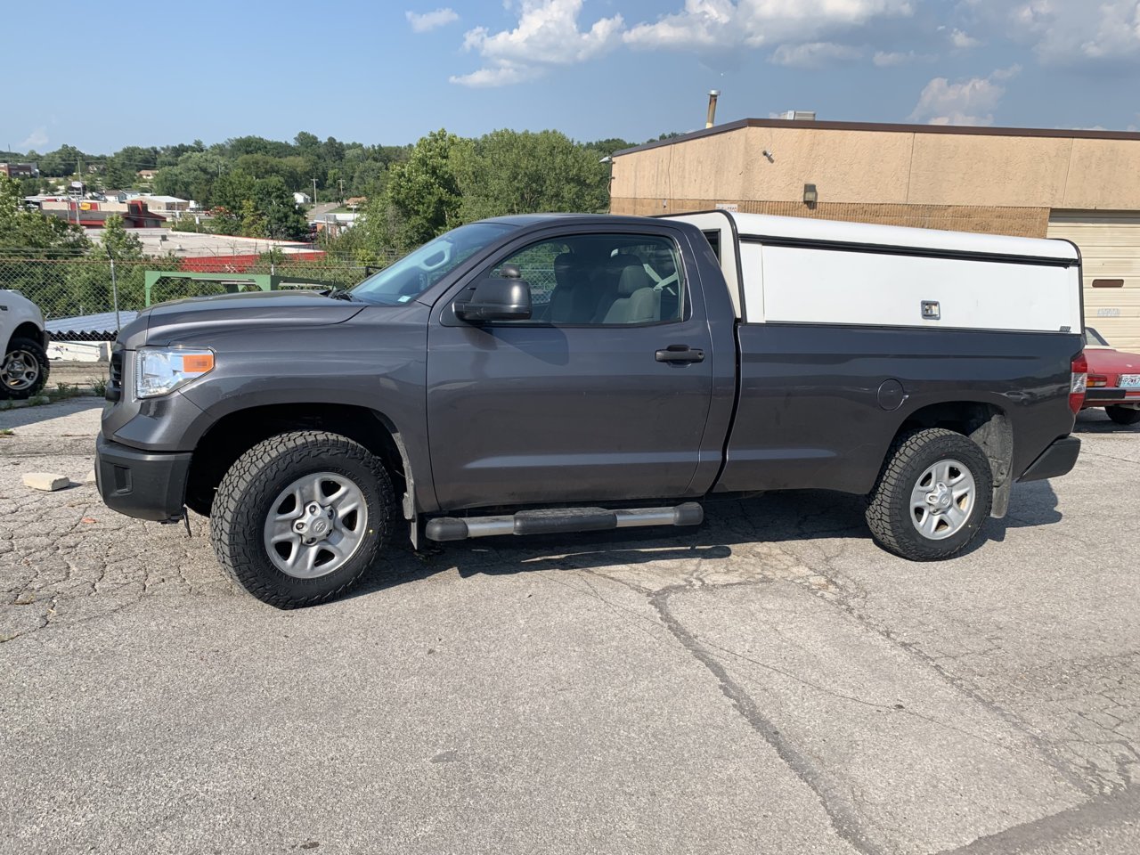

    I just ordered the first set of new tires for the Tundra. 275-65r18 Falkin Wildpeak AT3 116t SL. Any one running the SL loads? If so what tire pressures are you running? Just match the door sticker?

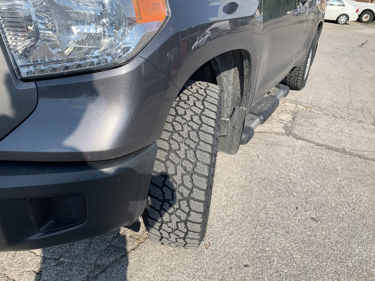

    Here is a quick before and after photo. I know the after one sucks but I will post a good one later. Thanks for your help folks!8B3965CA-0D98-4350-9782-C98E260E43FB.jpg022C094A-B19E-47F4-B43B-70729C993E19.jpg

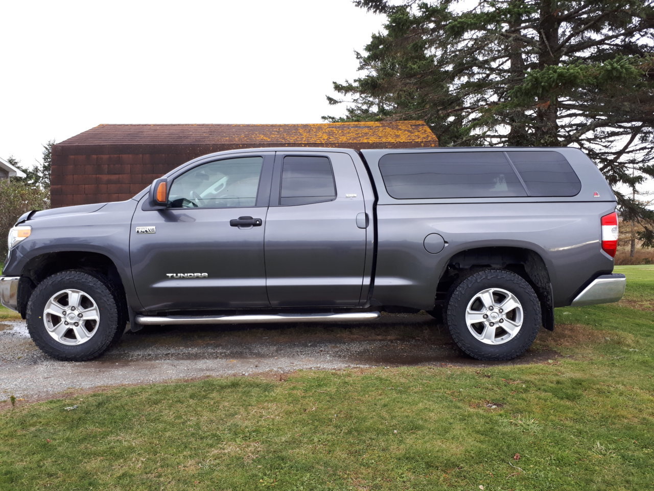

    Bought the same tires in 265 70 18...
    Only been on for 1k,I run 36F 34R. Have to look into the chalk test,never tried it.
