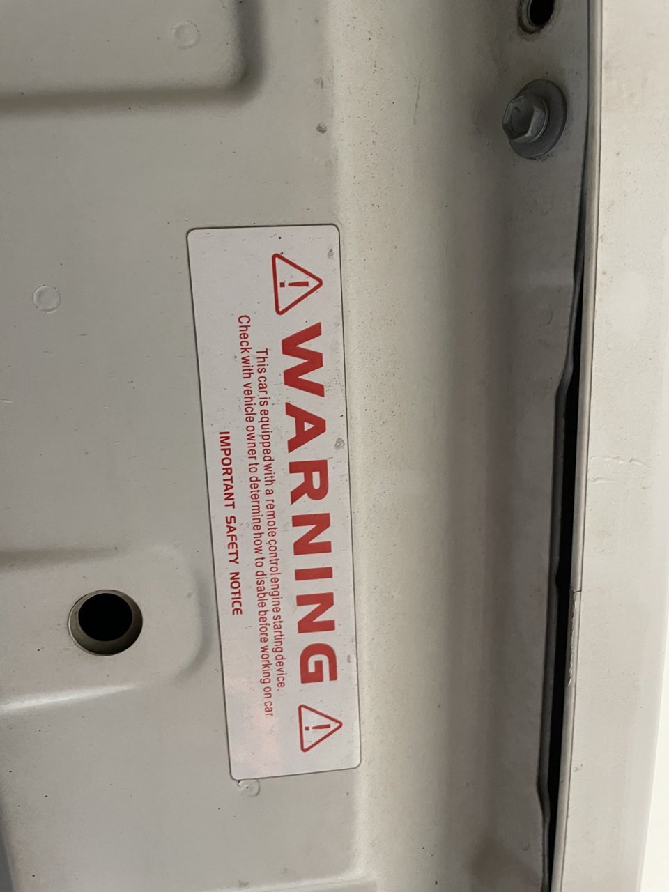

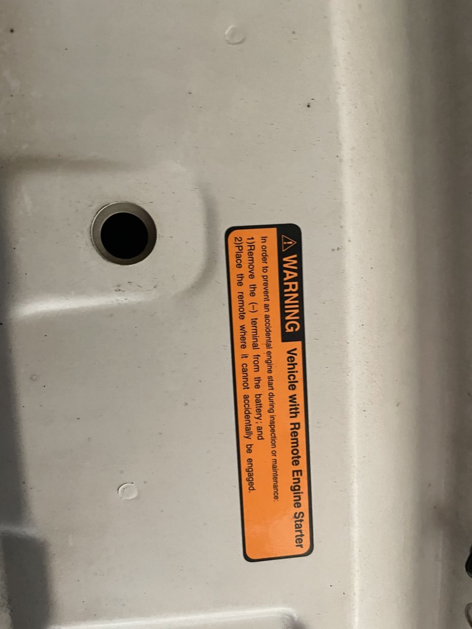

    Can’t seem to find a good switch.
    Also don’t see any signs of wiring messed with or an aftermarket module under the dash.
    there are two stickers under the hood, which I find weird. Orange seems to be factory, the other seems to be aftermarket.

    Are you sure it actually has a remote start still connected? Have you tried to locate it? My 2019 I installed an aftermarket remote start, it plugs in under the dash.

    ^that has merit. If the holes where those stickers are ever had the hood switch, it's gone now.
