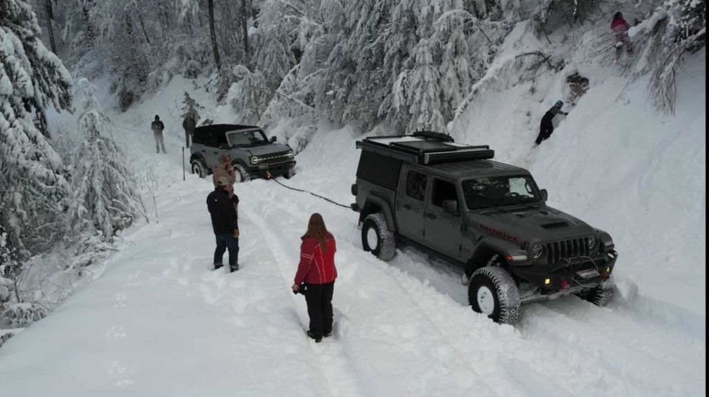

    We use Kinetic all the time, but each recovery method has its use and purpose. As a side note I find traction boards to be the least helpful in most of the situations I've been a part of, though they are on so many rigs. They are big and bulky vs a Bubba rope or static line. If you’ve got the room kinetic ropes are really useful as they can help when you have a vehicle stuck down in something and you need a little pop up to get them out; btw a safe firm tug not a running start to rip off a bumper. They’ve got more grace than a static line pull on your equipment as well.
    In snow you need momentum (especially in snow 30” deep) and if your winch can’t reach a tree and you use another vehicle as an anchor sometimes it will dig that car in as well. We actually did use traction boards as ramps to get the Gladiator out of the ruts it made from the pulling the Bronco. We still had another 5 trucks behind these and were forced to turn around given the time of day.
    Sand can behave similarly depending upon its moisture content.

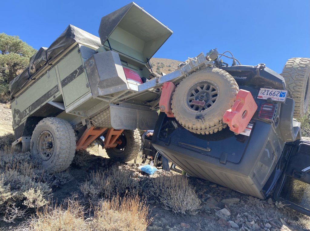

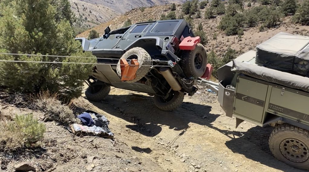

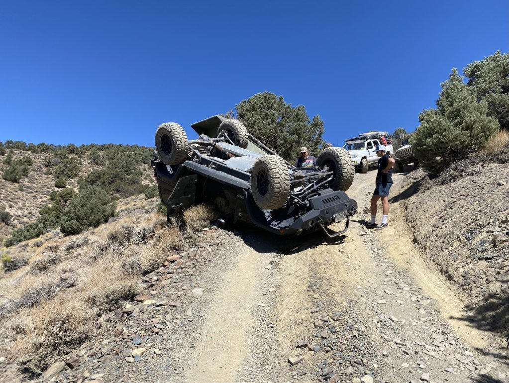

    This was just 4 days ago-
    Flipped Jeep Recovery in Death Valley

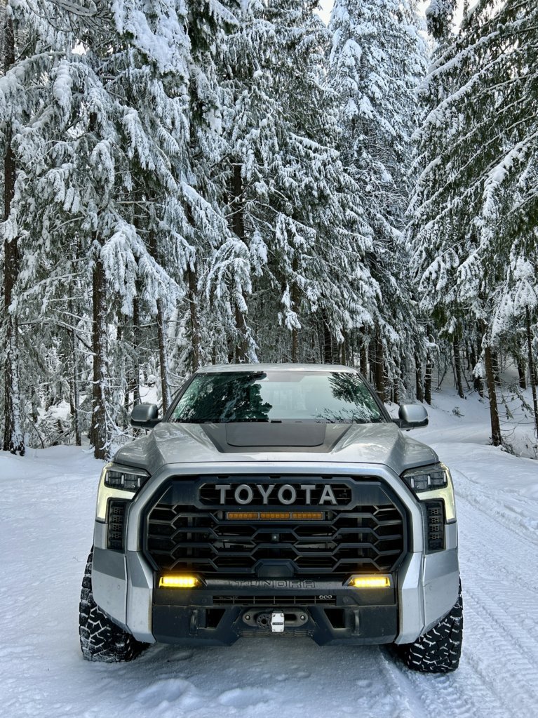

    This was just cuz :D

    I don't even want to know about that jeep up there ^^^. I see a wheelchair in the background. How in the heck
    they got all jacked around on that road, who knows. Getting them back on their wheels is good and lucky, I hope driving
    away was okay.

    To me it looks like the Jeep was going downhill, hit the brakes and the trailer pushed the Jeep towards the edge, driver turned away from drop off, classic jacknife.

    Pretty good guess. The Jeep was a very experienced off roader who has been paralyzed for many years after a street bike accident. He lifts himself up into his lifted Jeep, then hauls up and disassembles his chair and uses hand controls to drive. Really cool guy. We were on the border with Death Valley in between the Salt Tram and Cerro Gordo at about 7000 feet going down The Descents (that road is much steeper than it looks) and it was one quick mistake. He’s done the move a thousand times but with hand controls his left hand is gas and brake and his right hand steers. To down shift he quickly left go of the wheel to slap the gear shift down lower and the left front wheel hit a rock on the turn and spun the wheel uphill and the trailer pushed it over. We got him out without any injuries and the trailer’s lock and roll hitch helped us get his Jeep off the roof to the side, and then we winched it back onto its tires.

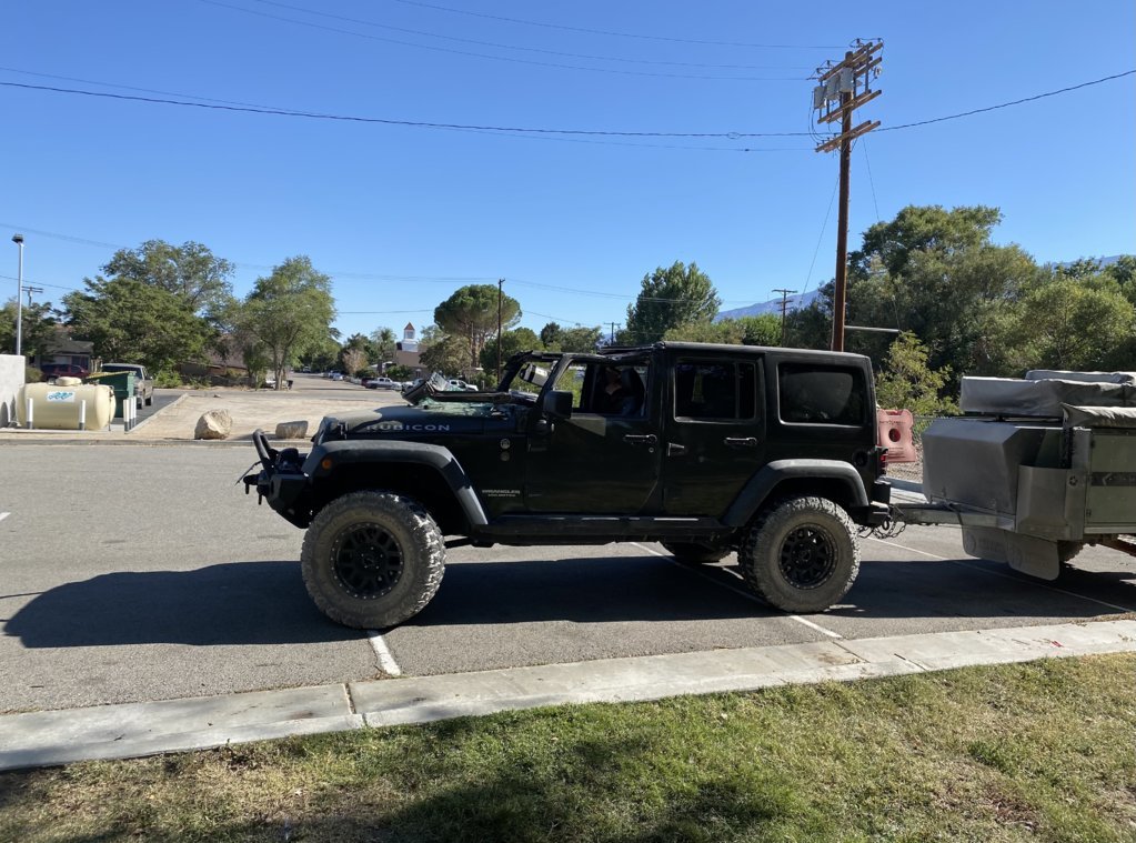

    We had to pinch one broken brake line with a vice grip, took off the front of the roof, laid the broken windshield down and I drove it 10 miles down the steep mountain with a rig in front of me as a stopper in case the brakes gave out. Got a nasty sunburn too that day.
    This was more of an extreme day but without the right gear it’s often the quick little trip where you get stuck that turns into an all day slog.
    not too bad
