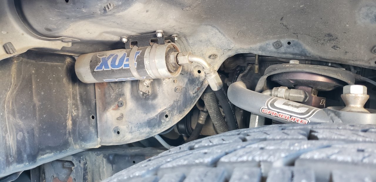

    This is where I mounted mine. I'm worried about the tires rubbing at full lock. I haven't messed around with the different setting on the UCAs yet. It might just be as simple as a different setting.

    I put 90 fittings right off the cans and mounted them up high on the inner fenders. I don't have fender liners or a windshield washer reservoir though, that would have been in my way on the passenger side.
    With yours, I might try to mount them higher on the frame and twist the can so that the line curls away from the tire.

    Thanks for the suggestions. Do you have pics of where you mounted yours?
    I'm debating eliminating the washer reservoir to make some more room on the passenger side, but there isn't a whole lot of room to mount them anywhere else. Maybe a different or modified bracket would help.

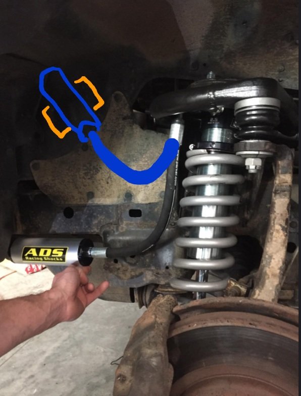

    You might be able to pull off something like this but the washer on passenger side probably needs to go to make it happen. That would get your can and hose out of the tires path.
    Excuse my Amateur Hand Model illustration, orange is the bracket.

    Just don't forget that you need enough room in front of the resi to remove the cap and get a chuck in there for N2 .

    Can always drop the can out for that but good call.

    That's very true, I didn't think about it. But I have gone through a lot of those clamps, probably due to over tightening with the cordless. Also, I use 3/8" shrink tubing over the clamps to keep from marring the resi can.

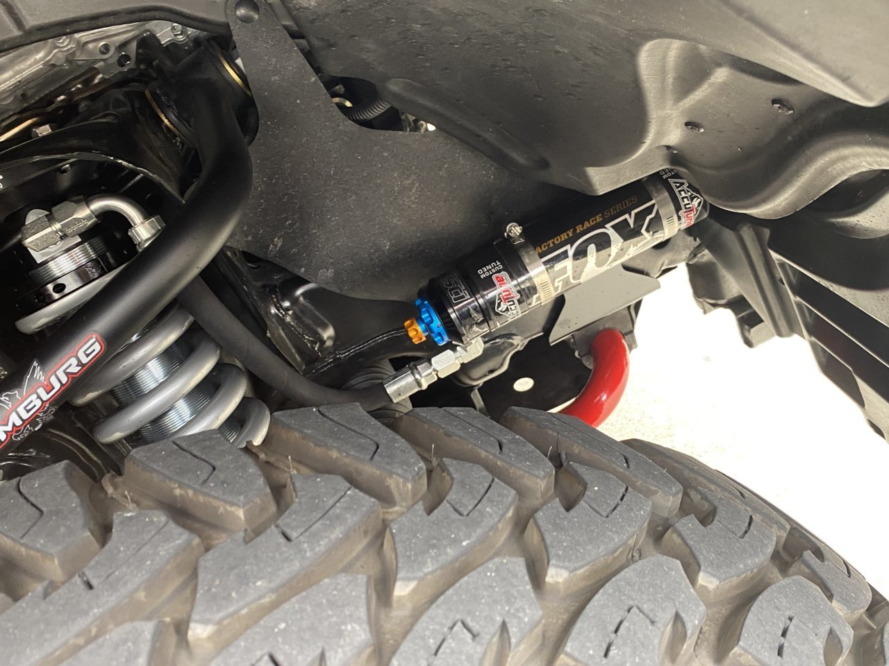

  14. Aug 15, 2021 at 7:07 AM
    Mallon3194
    Mallon3194 New Member
    Jul 29, 2021
    #66132
    10
    Conor
    Tundra2020
    Ran into this problem lately with my Fox 2.5s , the tire is rubbing the passenger res at full lock! Honestly i think it’s a bad place to
    Have them attached to the sway bar mount! Any off roading where the wheel is compressing into the fender and the res are getting ripped off!
