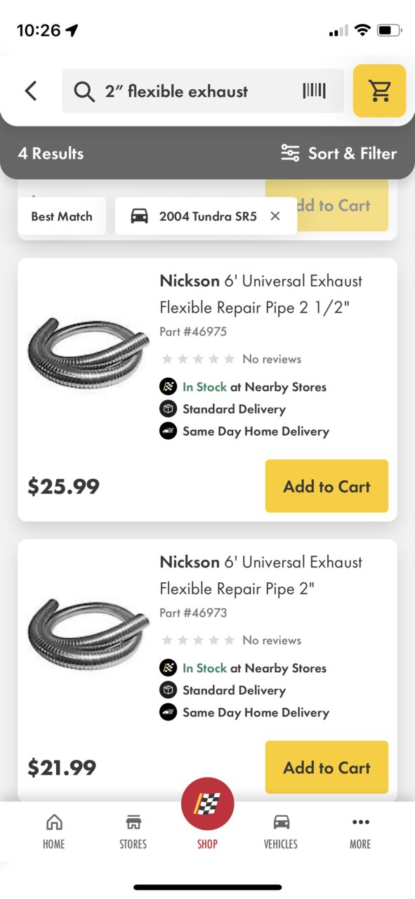

    I’m considering doing a new exhaust made by Keith at DD. He wants my cats to install in the new system. I asked the local muffler shop and they will not remove cats and install pipe temporarily due to emissions laws.
    can I get away with using some flexible exhaust from autozone and just clamps for the temporary time of getting the cats to Keith and getting the fabricated exhaust back?

    This is what I was thinking

    I don't see why not.
    If you do it, please put up pictures and video of what it sounds/looks like.

    What about the O2 sensors? Disconnect then and store them temporarily?
    I'm not sure that this will work out. I don't know how you would attach those flex tubes. You'll need a 3 bolt flange at the manifold on both sides, and you'll need to turn horizontal corners to meet the Y in drivers side. On the passenger side you have a shorter run to meet the Y. You'll need 2 bolt flanges to join the Y. That pipe is an oddball size as well, pretty close to 2.25
    Maybe call Keith and ask him what to do. I would probably leave the truck parked until you can fit the whole new system in.

    Please be aware that if it flexes it could leak. If it does leak then exhaust could enter the cabin.
    I know, I know. Somebody’s always gotta be the doom and gloom guy.

    Look up high-temp flue tape. A few wraps could seal it, but broken motor mounts would be an issue.

    @shoe07 I see, if you cut the cats then yes, you may be able to clamp something in place as a temporary fix, but be cautious of heat escaping.
    The O2 are upstream and down stream from the cats. If you're cutting the cats and leaving the bungs then yes, it will throw a code and might run rich.
    If you're going to cut the cats out anyway, may as well try it. Worst case you're down a vehicle until you install your kit.

    If you cut after the upstream o2 sensors and before the downstream sensors, you possibly will be completely ok. You will have to put anti-foulers in with the downstream sensors. The downstream sensors do not have any influence on fuel trims, so as long as the upstream sensors are present and functioning, I say it won't run like crap. It will throw a "catalyst efficiency below threshold" code unless you put the anti-foulers in, but that code doesn't put the truck into limp mode or anything like that. I say do a decent job sealing everything up and see what happens.
