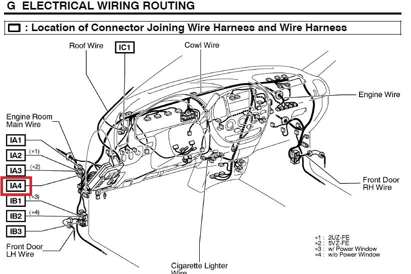

    The 10A ETCS does indeed come into connector IA4 drvr kick panel as it heads to ECM.
    If you had conditions similar to another member from yesterday, suggest you take a good look at the other connectors. That member had water penetration to that area, corrosive connector and broken pin.
    This thread---> Electrical Problems
