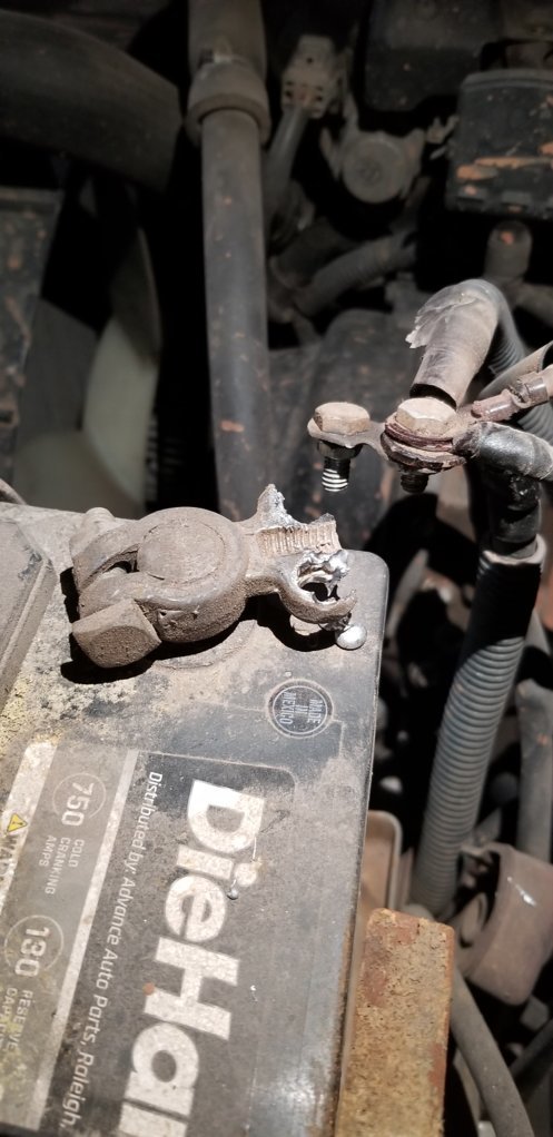

    About a month and a half ago, I went to go start my truck up after letting it sit for 6 or 7 days, and for the first time since owning it, it had a little hiccup but got itself going. I was in a rush and didn't pay too much mind to it. Drove about 15 minutes to my destination and shut it down. Went to drive home a couple hours later and there was no juice at all. Popped the hood to jump it, only to see this:
    (+) C clamp was melted in half, (-) side was fine. I disconnected (-), replaced (+) clamp, then attempted to reconnect both. With (+) back on, I attempted the (-) terminal only to be met with sparks and the starter motor instantly engaging, with no key in the ignition at all. The battery was reading proper voltage.
    Got it towed to a shop where they said the starter relay was stuck closed causing continual operation and a massive load therefore melting the lead C clamp. They replaced the relay and said that it was fixed, but it was now misfiring pretty bad and they also had to replace spark plugs and ignition coils. Once I got it back I replaced the battery for good measure and it ran fine, until yesterday...
