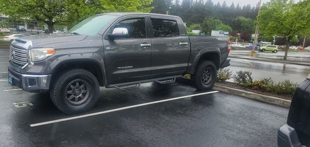

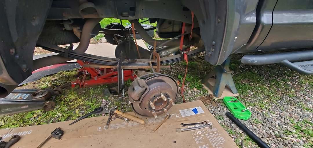

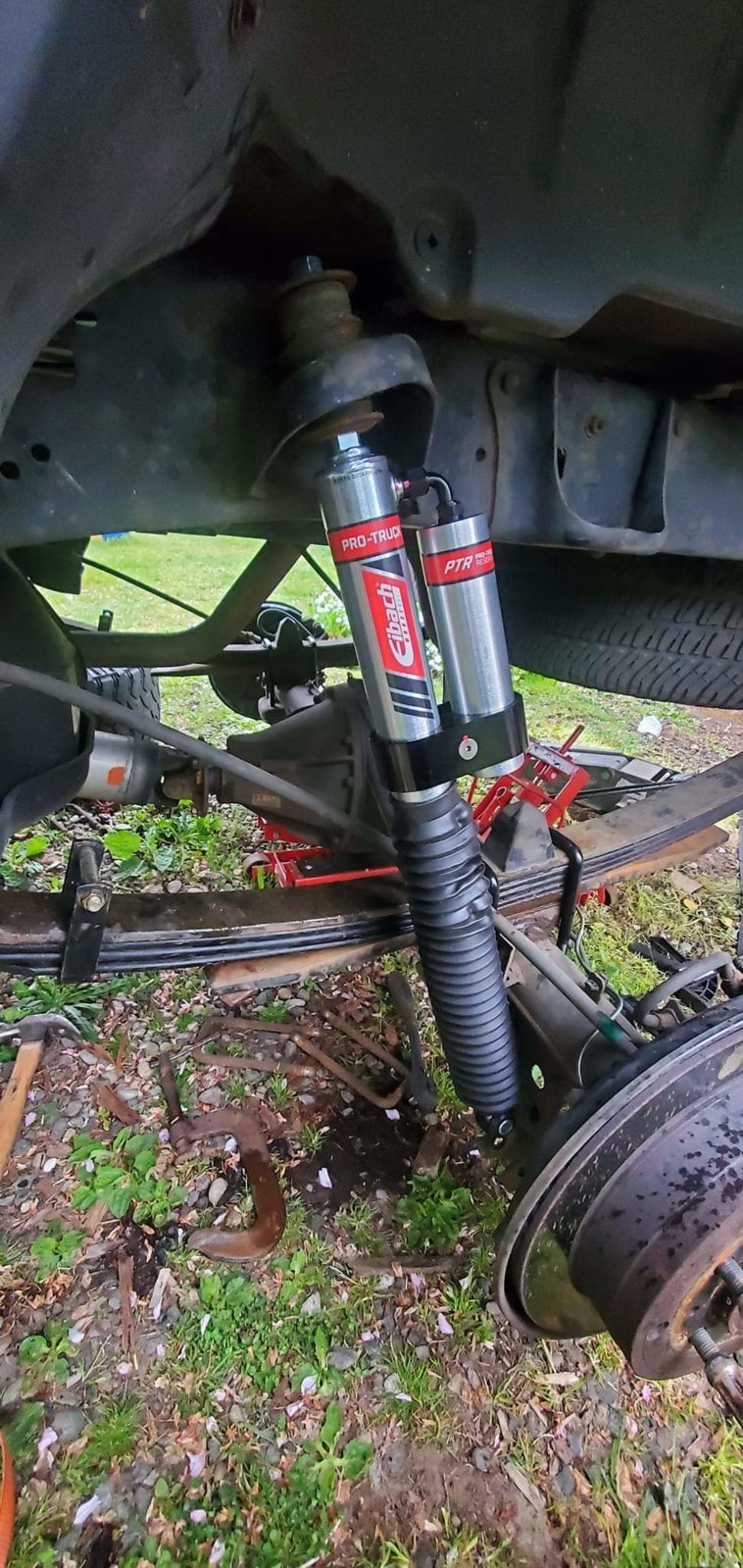

    I just installed Eibach pro truck 2.0r on my '14 crewmax and got 295-70r18 Kumhos. I also added the icon 3 leaf pack (found locally for like $100). Tires rubbed my lower fender liners pretty good. Previous owner had a spacer puck up front and lemme tell you: that was a royal pain to remove. I had to weld the pressed in stud to keep it from turning, and one of my coil springs was snapped. And the rear was left alone so it was lower than the front with and without topper. Topper pic is wheni first got mine, no topper is a couple days ago when I got tires.
    I thought the add a leaf wasn't any more difficult than a whole leaf pack, (I, too fully built a 1st gen tacoma) but it was a little different lining up and restacking leafs under the truck, on top of the axle.FB_IMG_1715029281699.jpg FB_IMG_1715029295143.jpg FB_IMG_1715029285009.jpg FB_IMG_1715029290079.jpg
