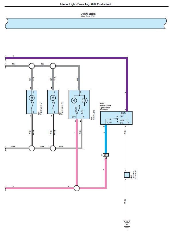

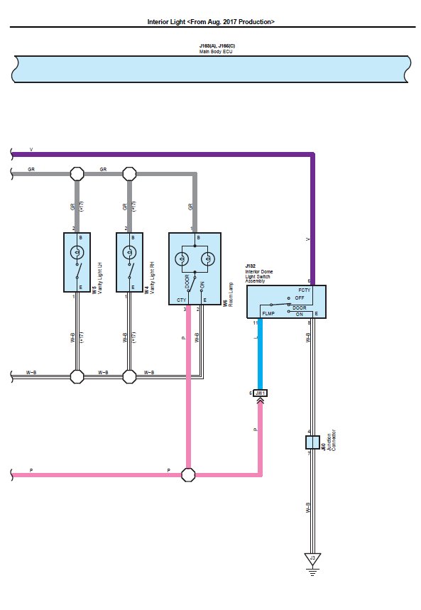

    Circuit looks pretty simple if you want to start digging
