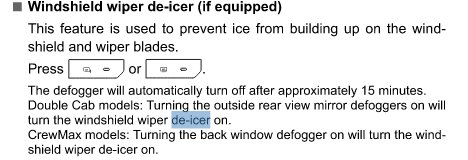

    No, I think it’s tied in to the heated mirrors switch. What it is actually called is “heated wiper park”. It’s designed to thaw your wipers free from being frozen to your windshield after sitting for long periods of time in snow/ice weather so they can swipe free. About 9 out of 10 Tundras will have the heated wiper park from the factory. I actually think it turns on when vehicle is cranked and times out after a certain amount of time. Not sure though.

    Heated Wiper de-icer comes on with the outside mirror defogger/de-ice switch or the rear window /mirror defogger/de-ice switch, which is on my Crewmax..and times out at 15 minutes..

    Just checked the sales brochure for my 2020 and looks like Windshield wiper de-icer is standard across all trim levels.
