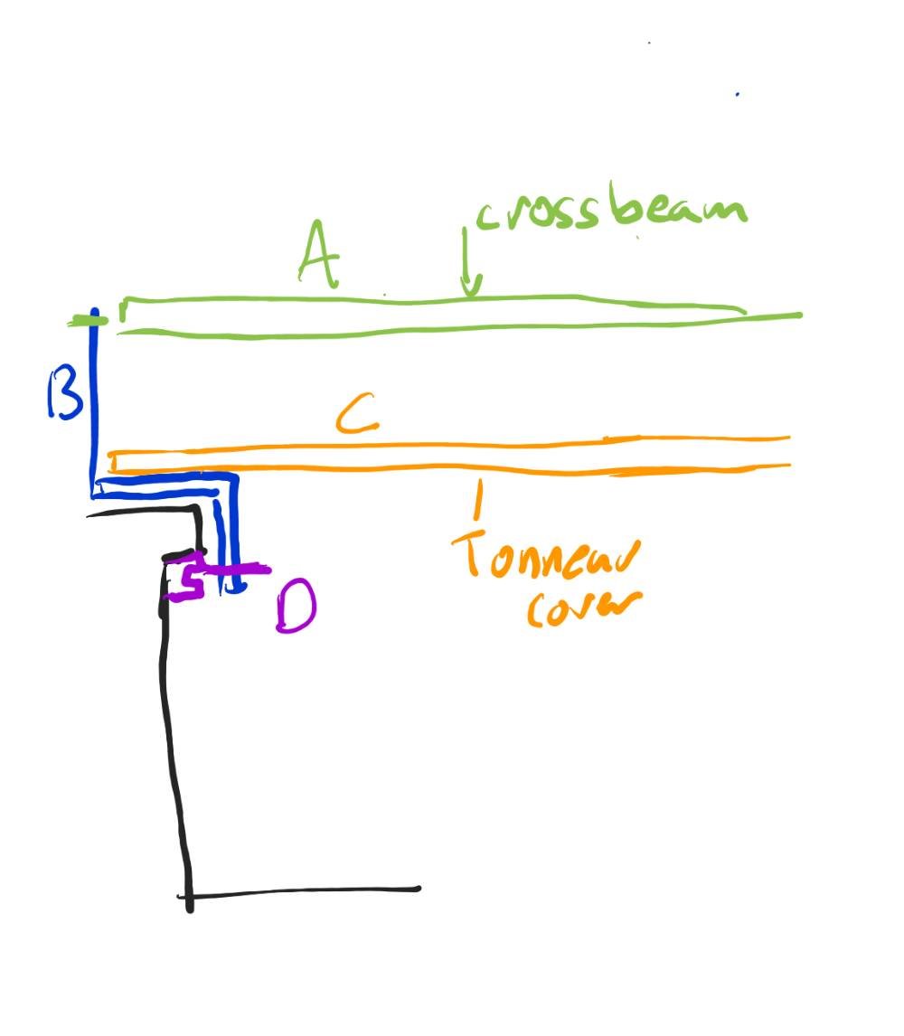

    Hello guys,
    I'm trying to make my own bed rack that will work with a tonneau cover. I really don't want to spend $500-$600 on something I will not be using every day. This rack is not designed to hold a RTT but a hi-lift jack, maxtrax, and water tanks.

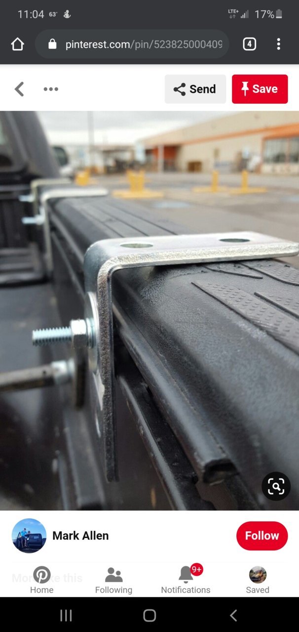

    I went through a couple of ideas and this was the first one:
    This particular example will not work since I won't have a way to keep the brace low enough for the tonneau cover and have a nut that can be secured beneath it. The only way this design will work is to have longer brace at the top so it will stick out.. this I do not want.
    This is the 2nd design I am going for:
    I need to know if a metal brace labeled B on the drawing is something a hardware store will sell or do I have to go to a fab shop.

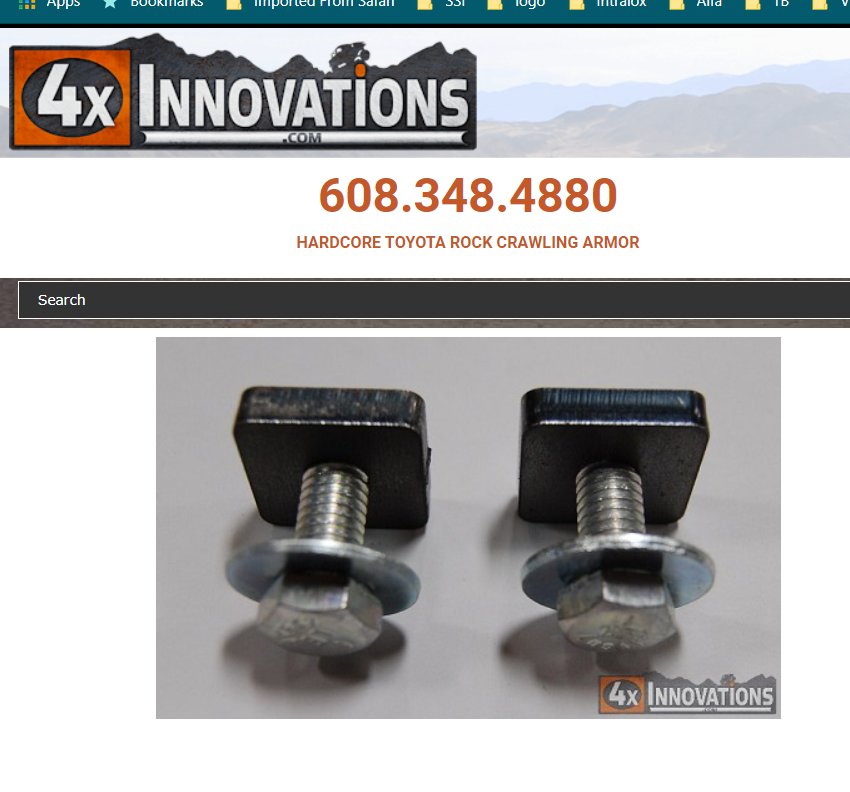

    I found a kit to hold the brace to the deck rail system I have and here is the link.
    https://www.4xinnovations.com/2005-...dra-Bed-Rail-Accessory-Hardware-Kit_p_21.html

    Vodoo makes the brackets for cheap. Why not but those and fab up your top you want?

    Did not know they sold the brackets separately. Aight! Let me check them out and see what I can do.
