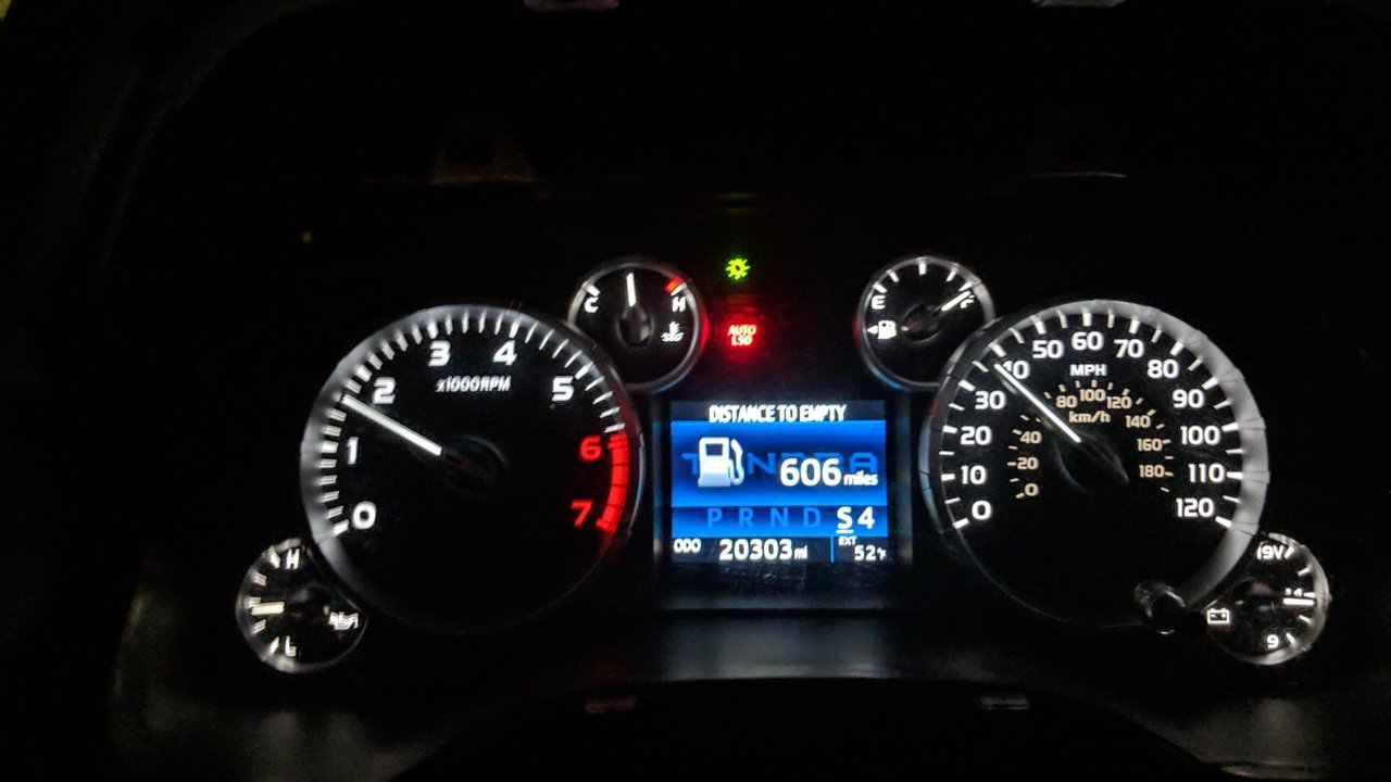

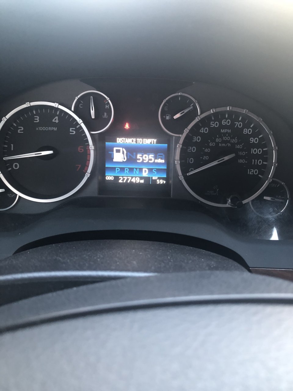

    Mine goes up to 600+ miles to empty when I unhook my battery. If I remember right it fixes itself before I go through 1 tank.

    Just about every time I fill up it goes above 600. Haven't reset it in months. I stopped looking at it and just drive. I use 93 octane.
