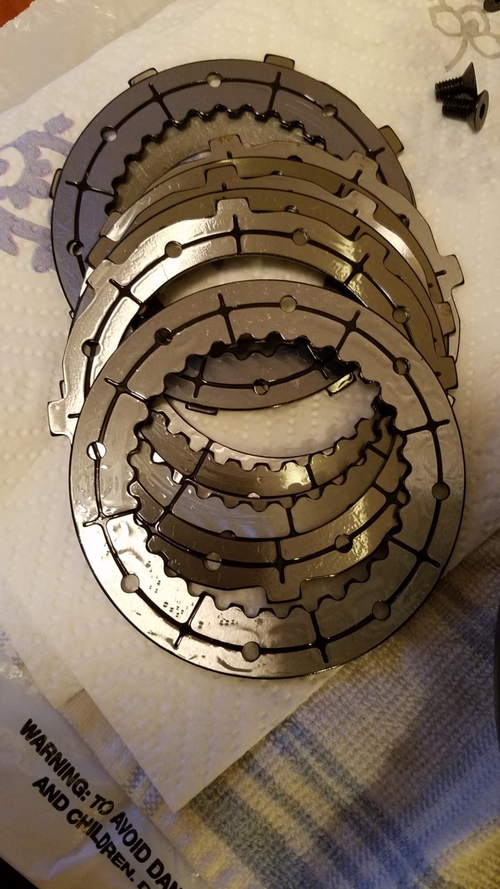

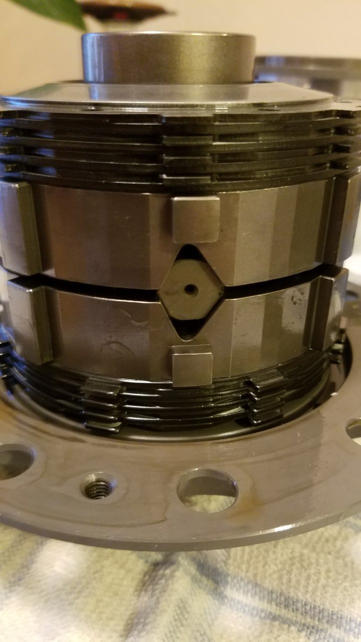

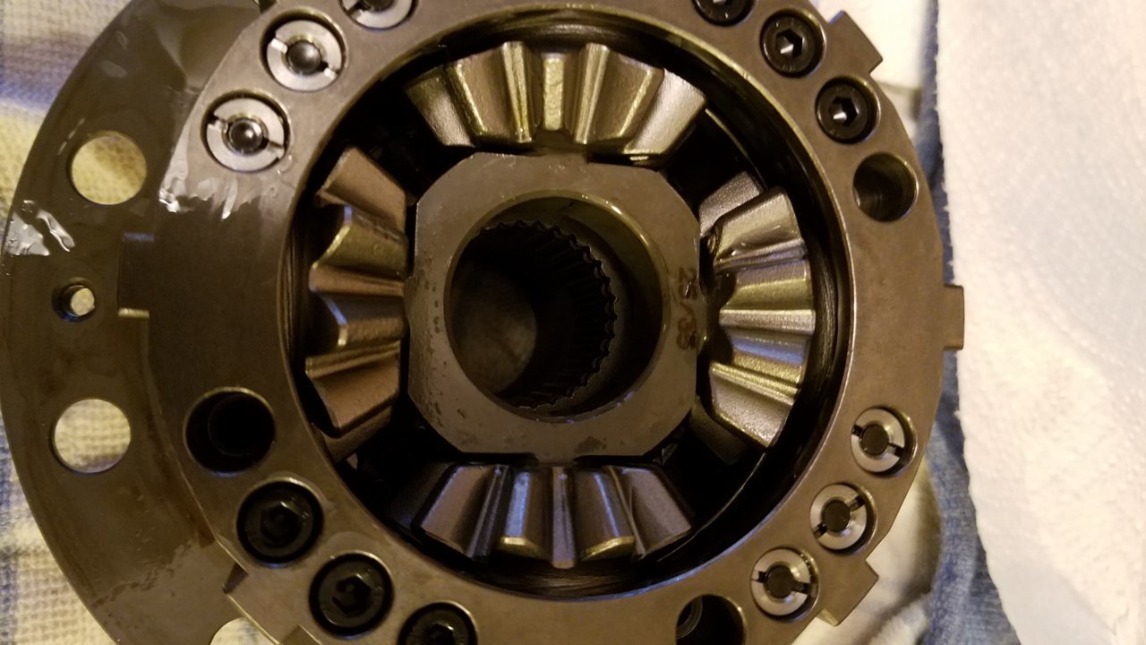

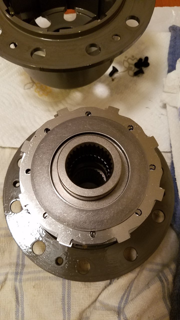

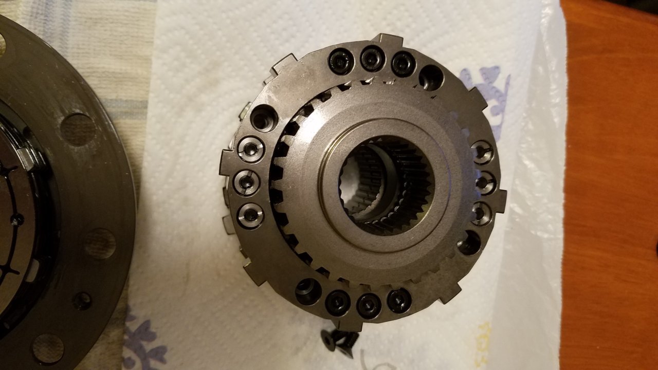

    And they'll also come with 4 pinion gears reducing the load on the shaft. I've had them in everything and have one in the case for the 350.
    Inside an OS-GIKEN Super Lock.
    20191226_161018.jpg 20191226_161434.jpg 20191226_161239.jpg 20191226_161951.jpg20191226_163830.jpg20191221_123605.jpg
