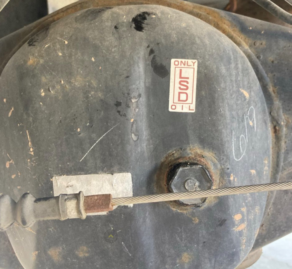

    I wonder if there would be an issue with just going 80w-90? I have a LSD sticker on my diff but I think it’s actually just an open diff. And I just ordered Lucas 80w-90.

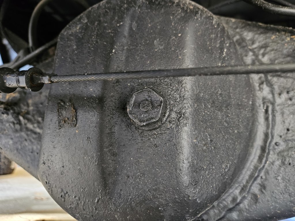

    I thought I was, because I did not see an LSD label on the housing. But I just looked closer and it looks as though there is some adhesive residue where there COULD have been something

    LSD sticker would be above the fill plug.
    And it kinda looks like someone painted over rust on your differential. What's the rest of the frame look like? Also a chance you have the LSD sticker, but it's been painted over.

    Easiest way to tell is to stick a jack under the diff, lift until the wheels are just off the ground. Turn one of the wheels.
    If the other wheel turns in the same direction , LSD. If it turns in the other direction, open diff.

    They definitely did paint over some rust on the rear diff, as well as a few other parts. I plan to remove it and repaint myself.
    The frame is actually in great shape. Thr previous owner had it taken into toyota for the rust preventative frame coating.
    There are a few small areas of rust but nothing significant. I actually felt pretty lucky about how rust free this unit was.

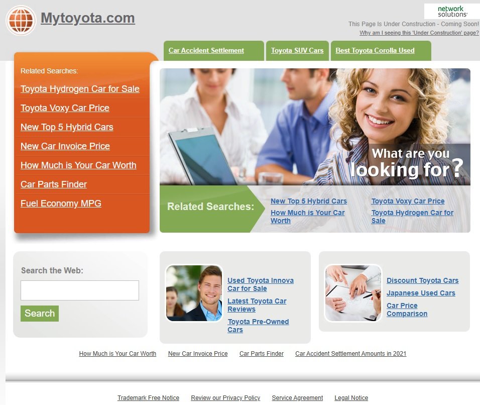

    When is last time you accessed the site or what does one click on to enter VIN ?
    According to internet wayback, none of their previous pages over the years will come back as if Toyota has shut it down ?

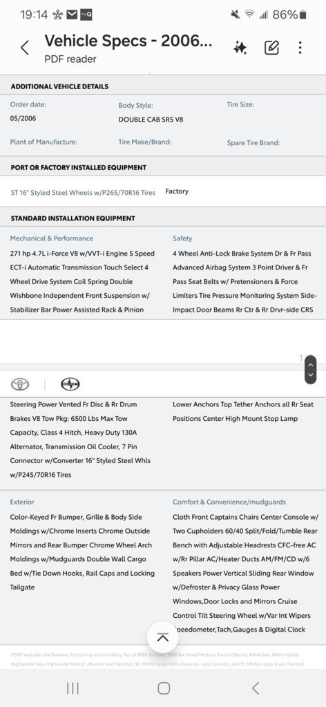

    No specific mention of differential specs. All I see is "standard installation equipment." I assume this means that I have a standard diff, but i will jack it up and spin the wheels to be sure.

    Accessed just now. My bad it’s Toyota then login

    I’m curious if anyone has had a LSD sticker on their rear diff but doesn’t actually have one? I have the sticker on my rear diff but I’m pretty sure I remember wheels spinning in opposite direction when lifted off the ground.

    If the OEM LSD is worn out it acts like an open.
    I have a LSD oil only sticker on mine from when had 4.10's w/OEM LSD. I've since pulled that and have a Torsen LSD which no longer requires fluid with friction modifier. Just like an open diff.

    That’s definitely a possibility. I’ll be swapping the fluid today so hopefully that changes things.
