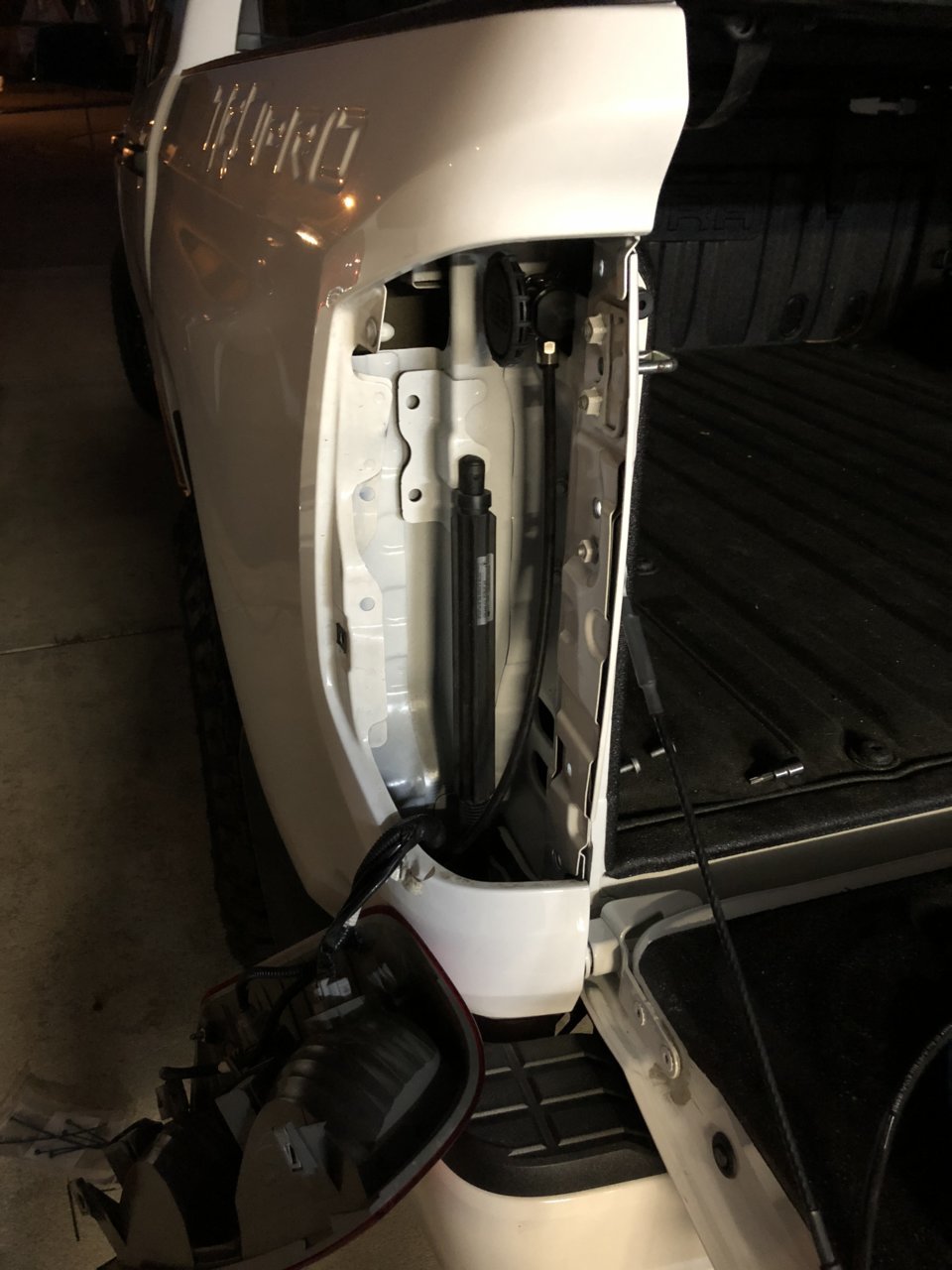

    I figure they put the front diff breather up in the engine bay the rear should at least be the same. Do it! There’s a good write up around here somewhere. most people put it up behind the tail light on the driver side.

    About halfway down my build pictures is where I put mine behind the drivers taillight. Easy mod.
