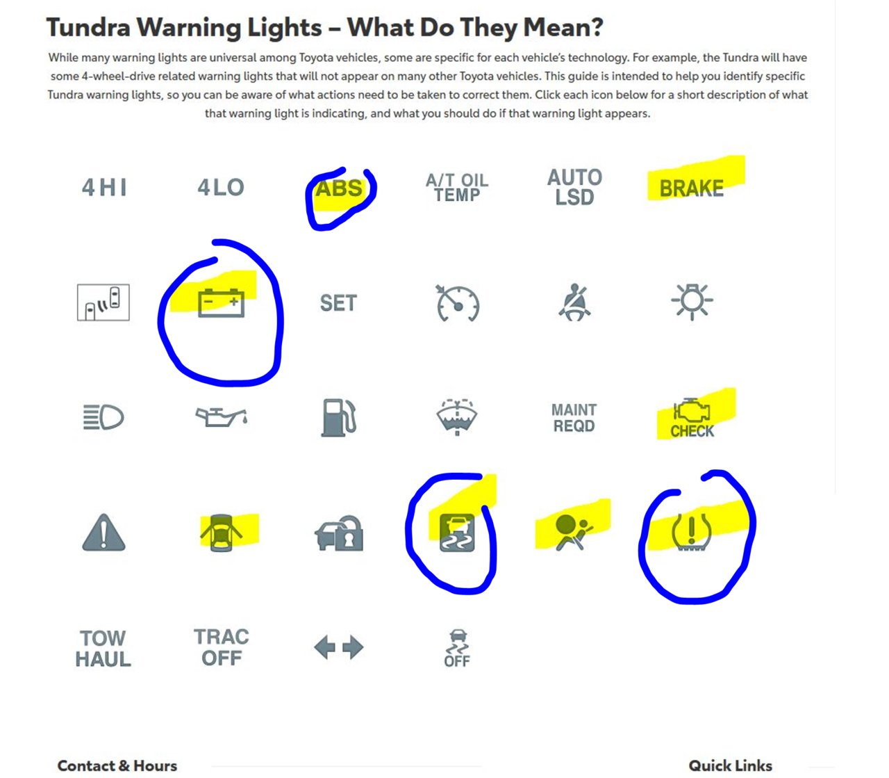

    Saturday I went to run an errand, got back in my truck, and got several warning lights all at once.
    (The ones in circled in blue were the first lights to come on)

    Additionally I've come to realize that the power steering is out, the radio wont come on,
    and ive also got the check engine light on and all the others highlighted in yellow.
