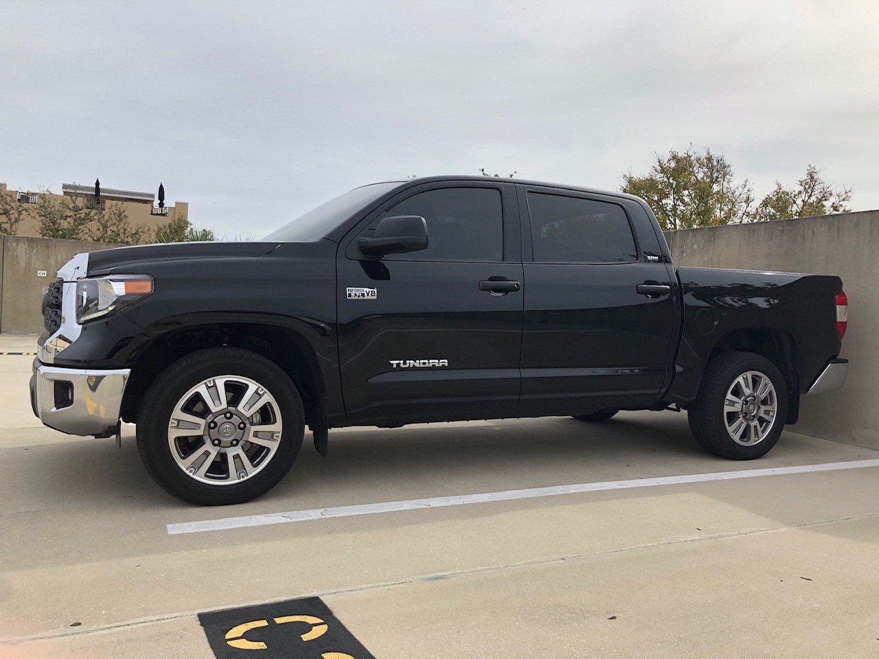

    Hey Friends,
    Still somewhat new to the forums (already introduced!), and Tundra's in general - have worked on Jeep's most of my short life so far (24 ha). Forum was a huge help with sourcing what I wanted to spend $$$ on and for the install. This past weekend I leveled the truck with Bilstein 6112 (1.9") and threw some SCS Ray 10's on with 285/70/R18 Nitto Ridge Grappler's.
    First off, Darren @BOSS4x4s was awesome to work with, same can be said of @SCSPerformance - great guys and definitely recommend working with them.
    All went well with the install, and love how it turned out. Was able to get a pretty solid decent alignment, but definitely took them some time. My Caster is the only thing not in the green, though total toe is 0.30...
    Now the problem, can anyone help me diagnose this sound? Its almost a clicking noise, and its hard for me to diagnose since it only happens when driving and seemingly not due to any one type of motion. Linked a video w/ 3 short clips of it below (may need sound up), sorry to add additional clicks! Really appreciate anyone taking the time to chime in, included some pics so there is something to look at!
    Attached alignment specs since it came up. Still some work to do.
