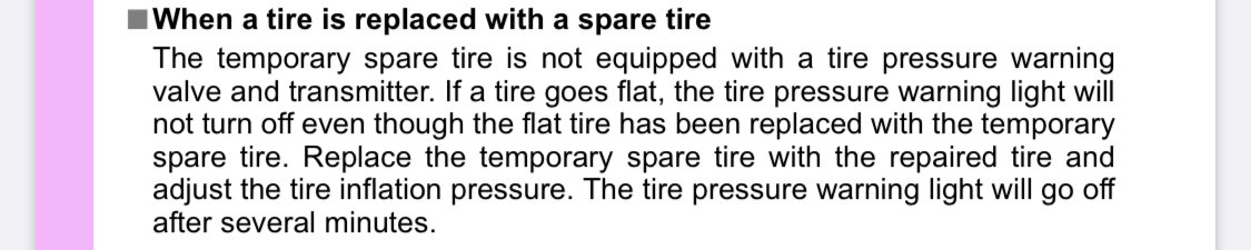

    I’ve read newer Tundras (2018+) don’t have a TPMS sensor in the spare. I’ve actually not verified this on my 2019 (yet).

    Confirmed: Per the owners manual for my 2019, no TPMS sensors in the spare.
    (yet another reminder to self: RTFM!)
