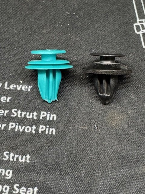

    Hard to tell if you have now damaged your bulge or if it's still in original shape minus the clips.
    Lots of us have had this issue, and replaced the black push clips with these. Resolved the issue and have held up great.
    Here are the clips I used that are holding much better than the stock ones that came in my bulge.

    Once you get a new bulge, probably wouldn't hurt to jump straight to the grean/teal clips I linked.

    Those green clips and JB Weld fixed mine and I just drove through a 40mph head wind at 70mph and it stayed solid.

    Not really sure. The look the same minus the color but they work when the oem black ones didn't. Probably a slightly different plastic and maybe a hair larger. It's still easy to install and remove the bulge if needed but I'm going a few years with these new push pins and have had zero issue. For the price, definitely recommend for piece of mind.

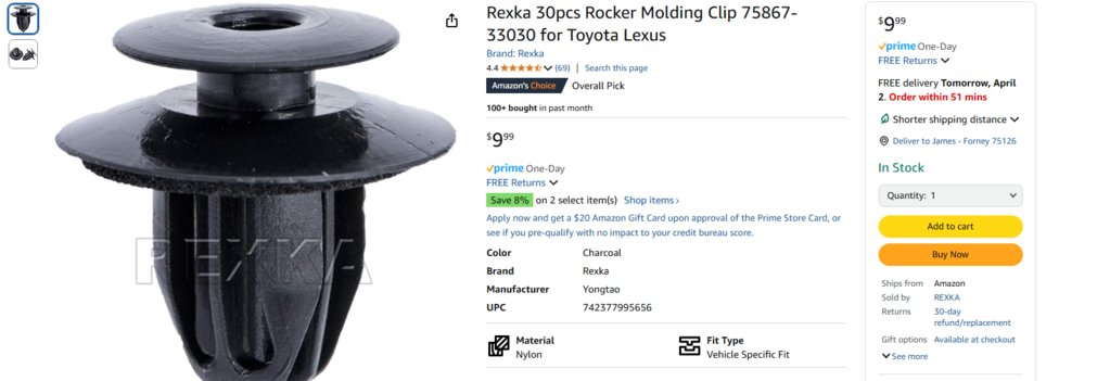

    I use these, they are flatter.
    Amazon.com: Rexka 30pcs Rocker Molding Clip 75867-33030 for Toyota Lexus : Automotive
    Replaced mine last week because the winds were popping it out of place.
    Hasn't popped out since.
    I've tried them both.
    For me, the green ones seem to leave more of a gap between the hood and the bulge.

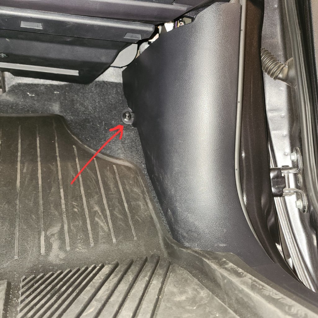

    If you ever remove the kick panel between the floor and the dash, these are a must.
    I ordered 25 and then gave half of them away on the forum..
    Amazon.com: Rexka 25pcs Cowl Trim Clip for Toyota Lexus 90467-09212 Avalon, Camry, Sequoia, Tacoma, Tundra : Automotive

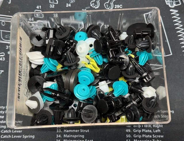

    Trying to see if Amazon has a 20 pack available for 9.99 :D to add to my Tupperware that I never gave back full of clips :rofl:

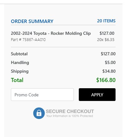

    75867-AA010 - 2002-2024 Toyota - Rocker Molding Clip | Sparks Parts
    Let's see, 20 from sparks - $166
    30 from Amazon - $10
    Corndog123 likes this.

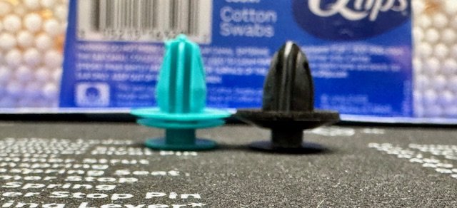

    Hey all just FYI. With the broken middle bracket and only the two end bolts holding, I used the green GOOACC clips from Amazon. Huge difference! I went through a car wash and the multi high pressured dryer blowers did not effect the hood bulge at all! It didn't even budge, let alone pop out again. Even with the broken middle bracket where the bolt goes, I don't think I'll have to replace the bulge. The clips are holding strong.
