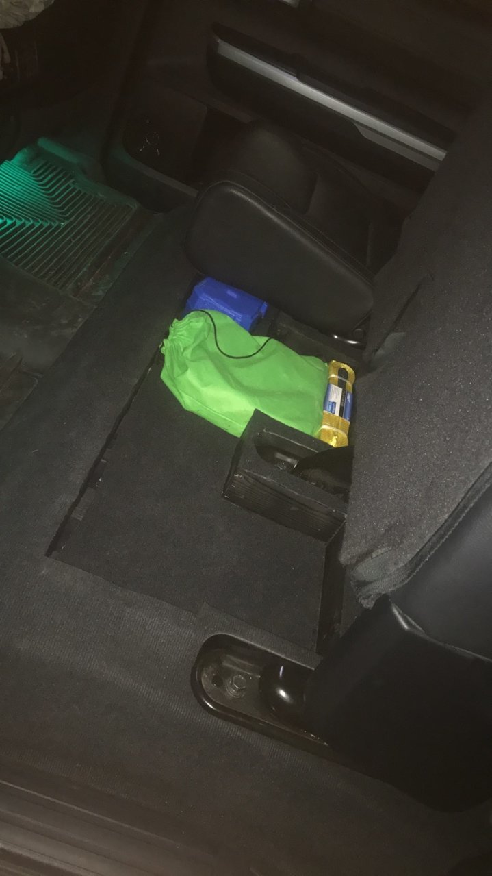

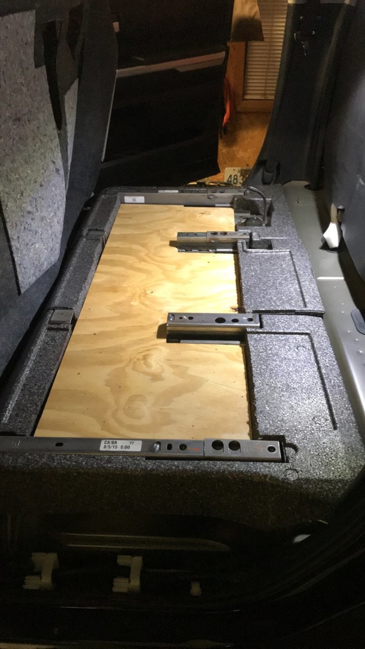

    Been reading and looking at the options out there for the underseat storage options. I can’t justify $700 for the ESP full length storage. So I decided to make my own. More to come. But here’s where I got to tonight.
    So far I’m in this for about $60
    3 1”x4” pine boards
    1 4’x8’ 1/2” plywood
    1 3”x24”x3/16” flat metal
    (Thicker metal is needed, I went back and added 4”x1/4” pieces under the 3/16” pieces I first used because the bars were flexing. They do not flex now.)
    Step 1:
    Remove the negative battery cable, don’t wanna run the battery down.
    Step 2:
    Remove the 8 17mm seat bolts.
    Step 3:
    Remove Seats. May require two people
    Step 4:
    Remove Factory Subwoofer, 3 10mm bolts.
    Step 5:

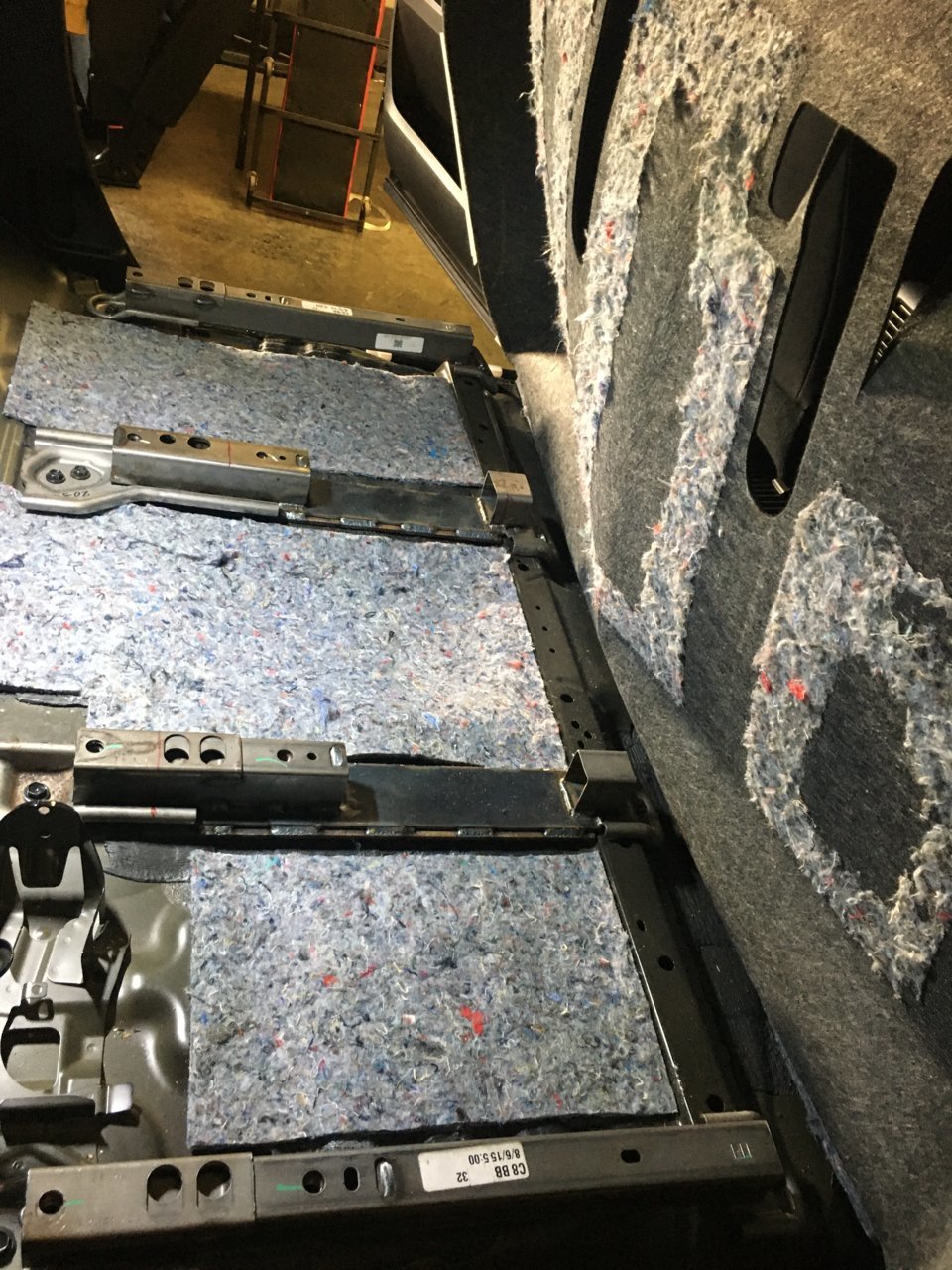

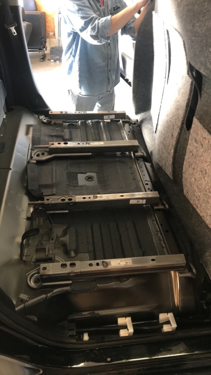

    Remove the plastic door sill trim pieces to be able to peel carpet back to reveal the seat brackets and the foam filling pieces.
    Step 6:
    Remove the foam first and set aside and then the two middle seat brackets. Should be 5 14mm bolts.
    Step 7:

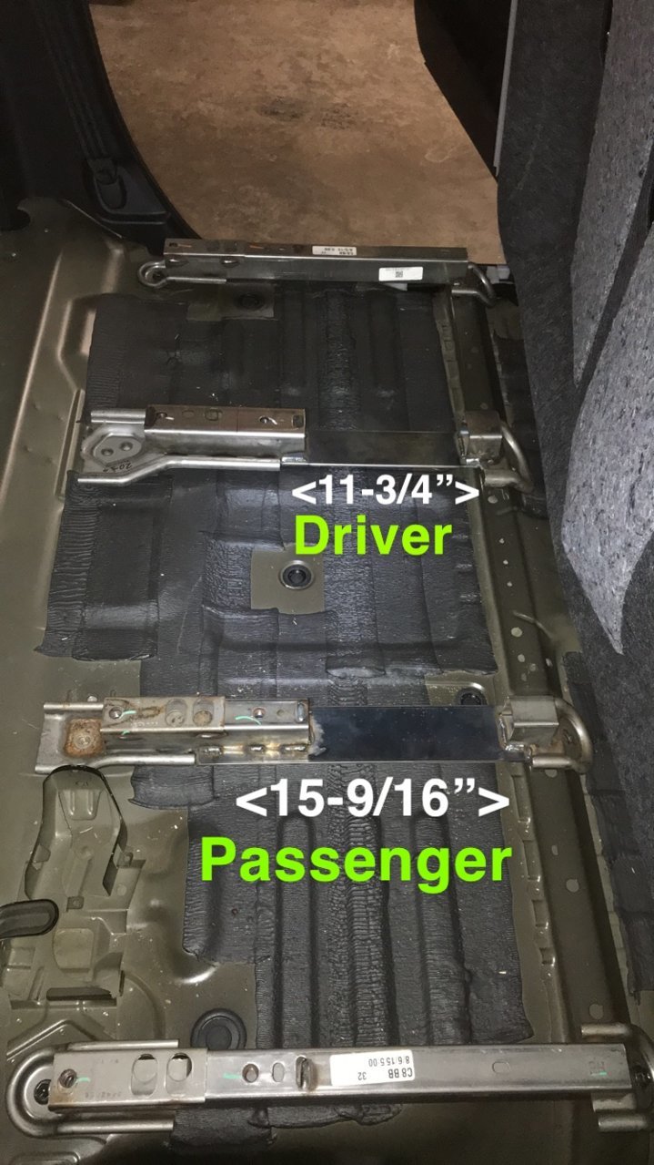

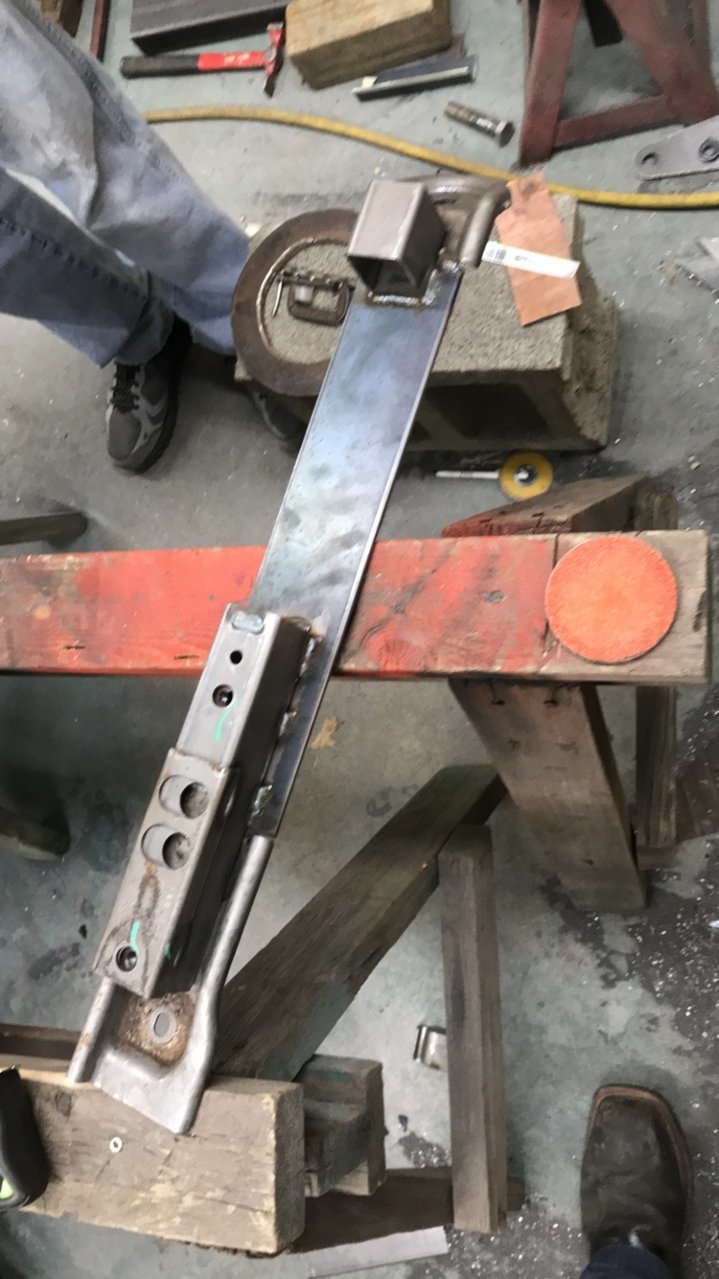

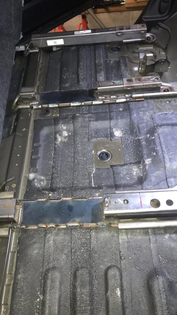

    Flat metal will be needed for the floor supports. I used a piece of 3” wide by 3/16” thick. Looking back I recommend 1/4” or 3/8” metal just for strength. (UPDATE, I did go back and add a piece of 4”x1/4” metal under the existing bars I added for strength) Here is what the seat brackets looked like once I got them cut and modified.
    Here is the measurements for the lengths of everything once cut and replaced.
    Step 8 and Step 9:

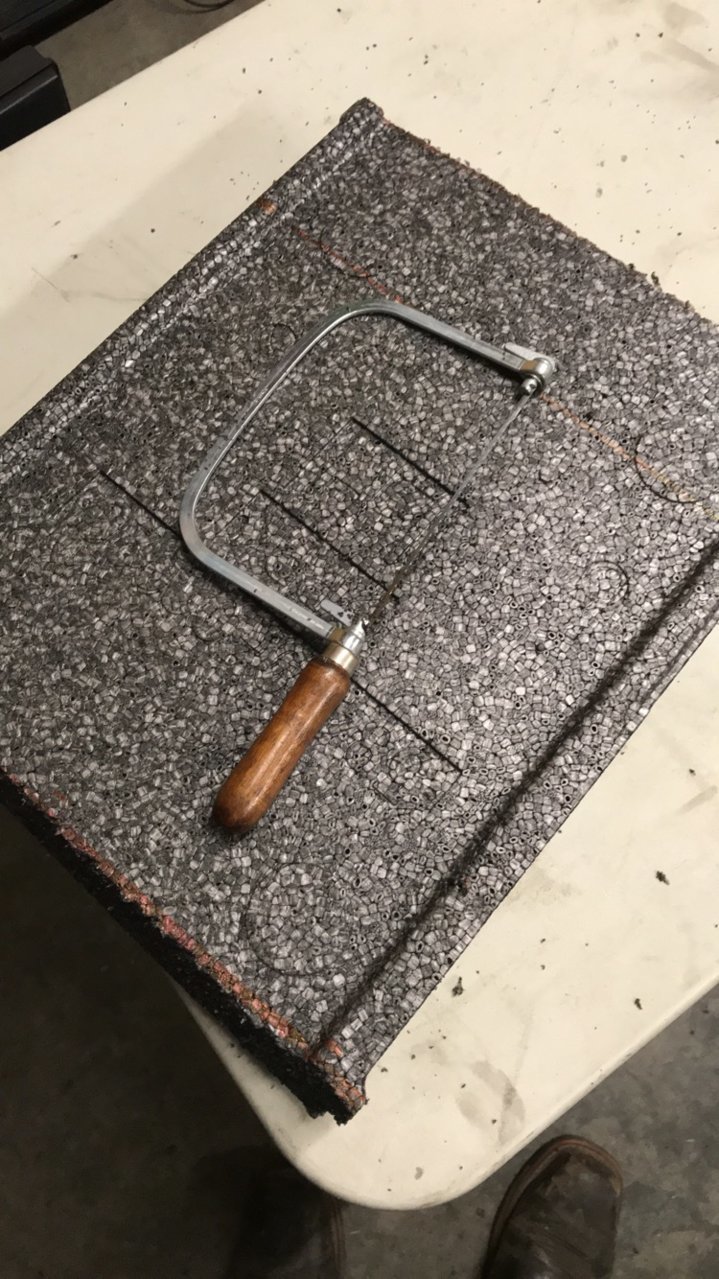

    I used 1/2” plywood as the bottom. I used a Coping Saw to cut the foam down to fit the bottom of the box.
    The dimensions of the plywood bottom are 48” across the front, and individual pocket dimensions are 13” wide and 17” deep I believe. I’ll double check that tomorrow and correct if I’m off.
    This is as far as I made it for tonight. More to come after Christmas.

    One question, why did you leave the square tubing on front? I was thinking of using flat steel all the way and weld onto the front part that bolts into floor.

    Good question, the length I left will set the frame of the box under the lip of the seat when it’s let down. Didn’t want it to be accessible without the seat being raised up. I haven’t gotten that far yet but once the box is finished Thursday it’ll make more sense hopefully.

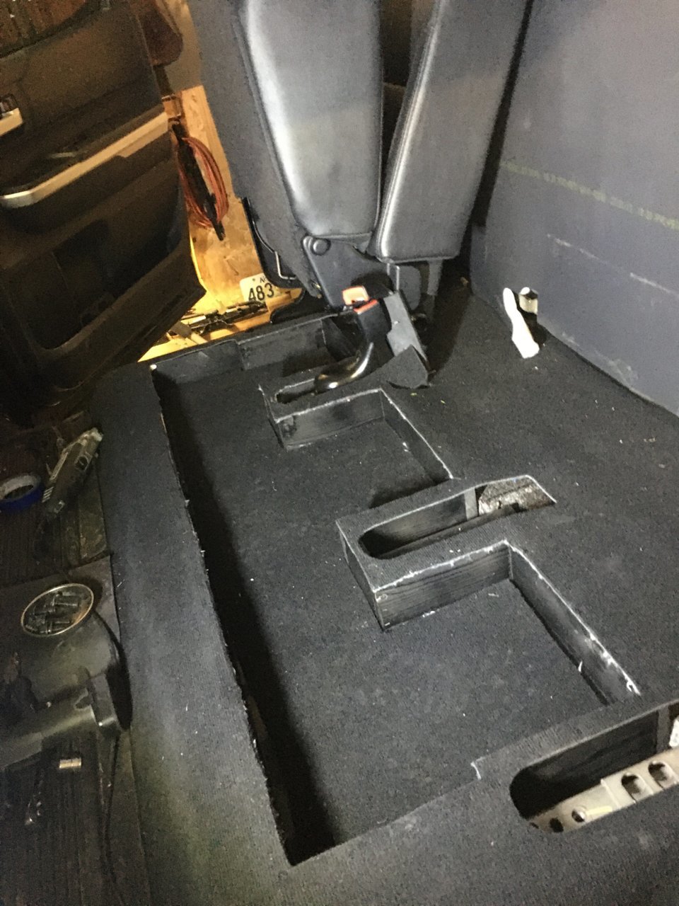

    Today’s update,
    I used the padding under the carpet and lined the floor underneath the box for sound deadening.
    I painted the box black, and got it installed. I stapled the carpet around the edges of it and trimmed the inside out for the bottom of the box.

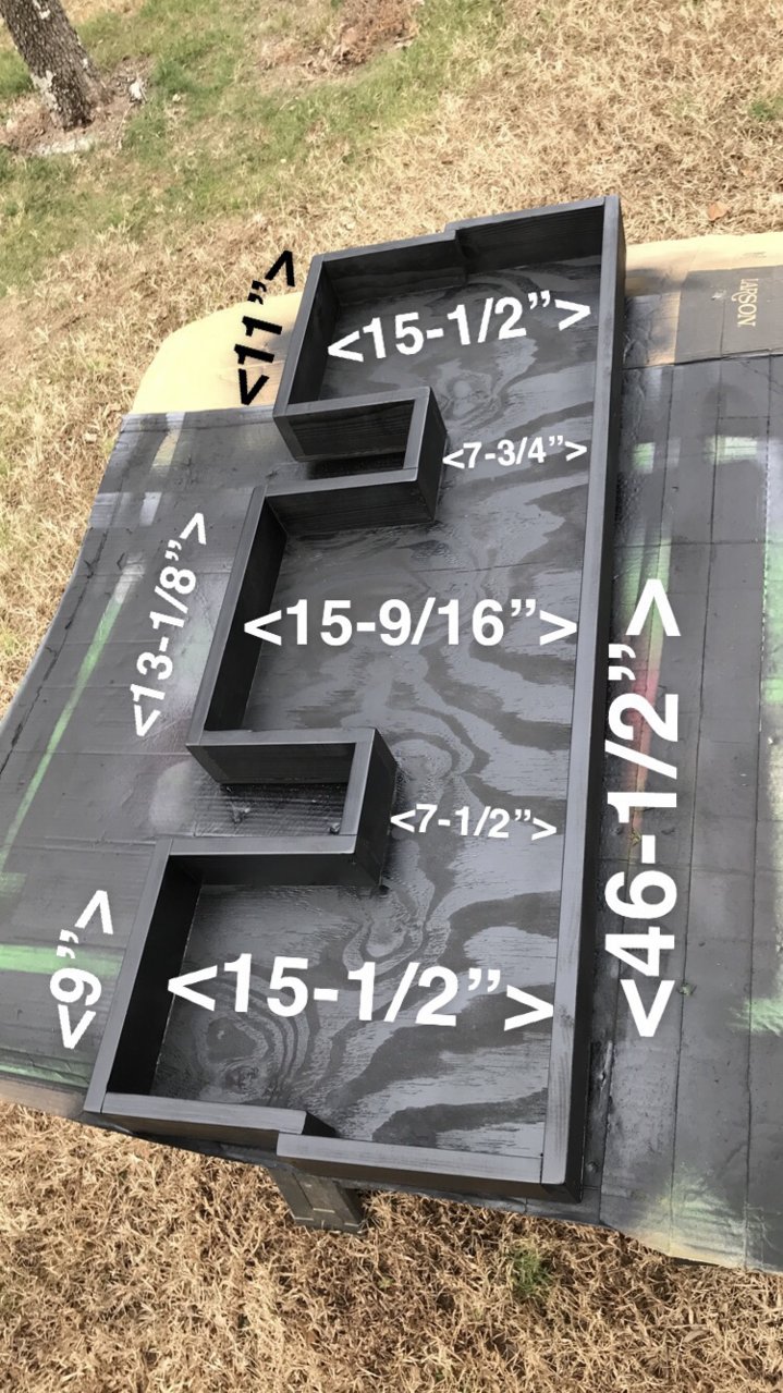

    Here is the box measurements
    And here is the finished product!!!
    Those are the inside dimensions by the way^

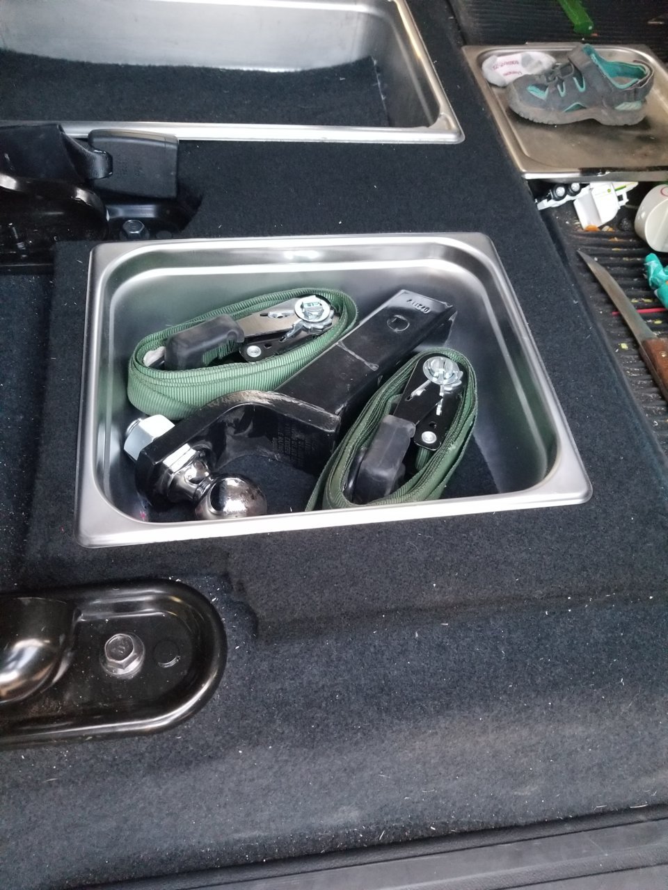

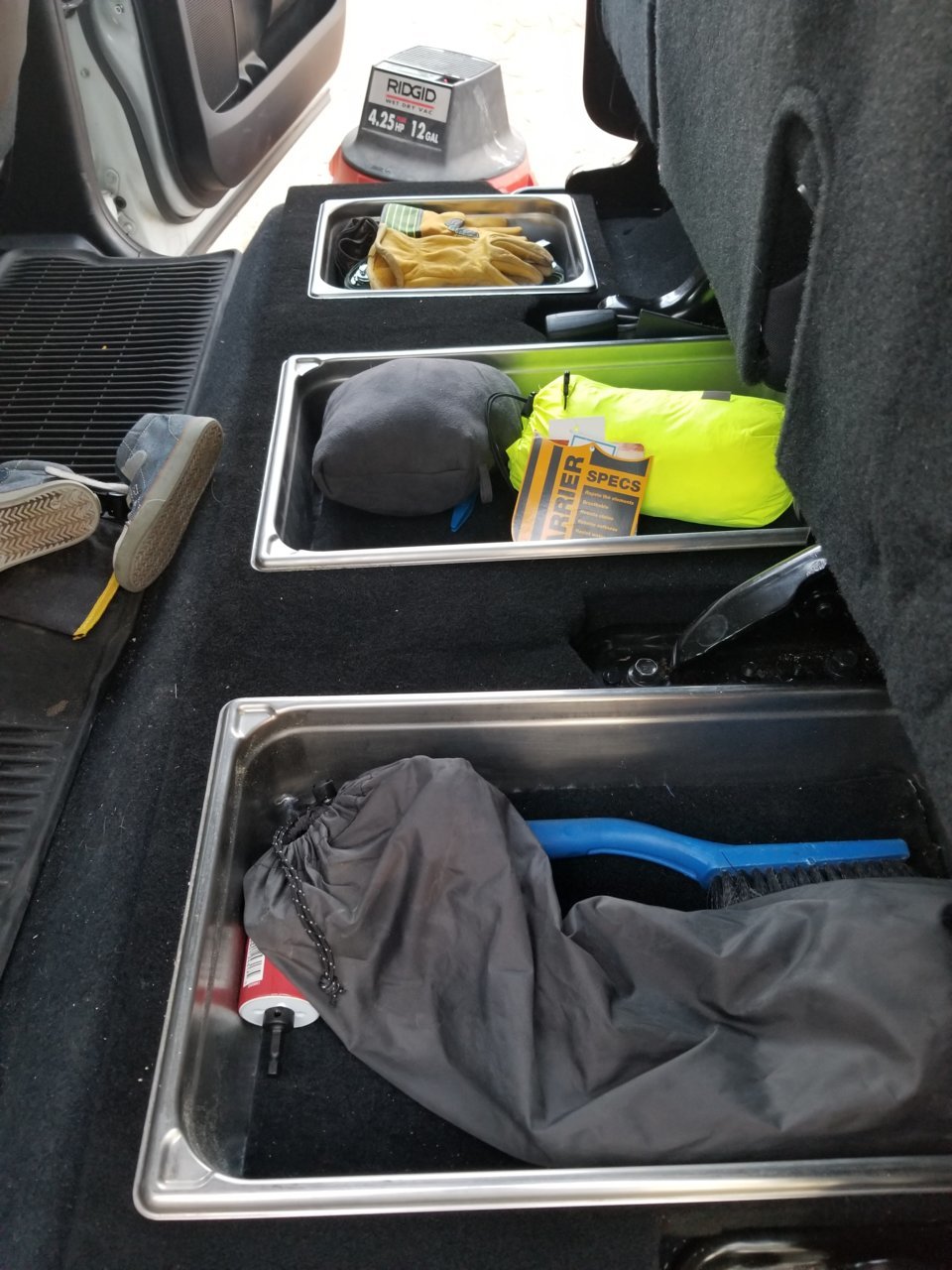

    Awesome job I used food trays for my set up
