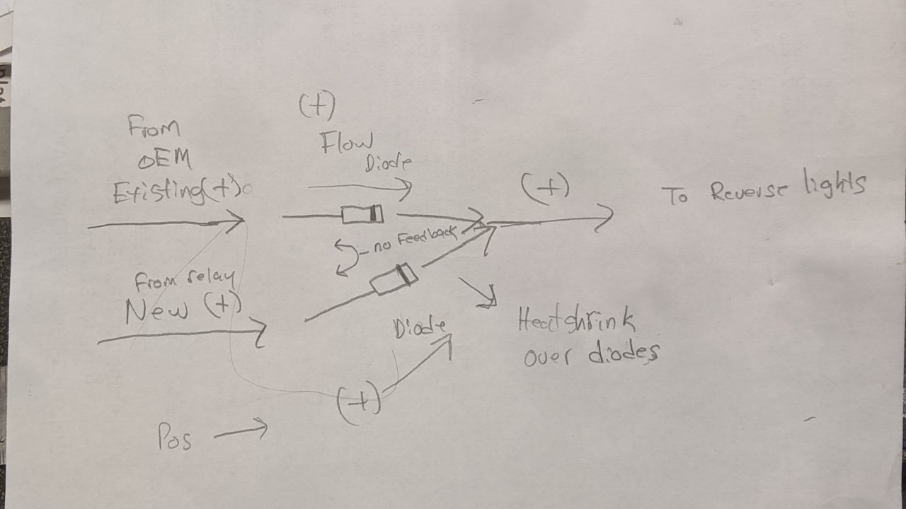

    Here's a pic

    That diode isn’t doing what you think that it’s doing. Those are what’s known as “fly back diodes”. When the power is shutoff to the coil the magnetic field collapses and can send a voltage spike back through the system Known as an “inductive kick” possibly damaging sensitive components. The diode prevents the voltage spike from occurring.
    to prevent back feed the diode would have to be placed in series with the circuit.

    Yes, two separate, and different isolation applications one at the relay, the other at the tap to the existing circuit (in this case the reverse). The point is the same however, to protect both the vehicle and the circuit integrity.
    You just insert the diode into the connector before you crimp it. In a premade harness you would solder it.

    The circuit placement is a little tricky if you don't understand how it works or why you are doing but so... You need to first know the polarity of the circuit (positive or negative). If positive, then you will have to install two diodes to isolate the circuit.you put them at the point of splicing into the wire. This is a "rough" sketch..lol
    These diodes will be probably 3a or 5a (or more) based on the load of the circuit.
