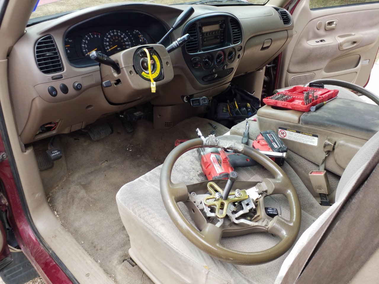

    What part is that? I've got my old steering wheel just sitting here. If it's a part off that maybe I can help.

    its the piece with the yellow wire hanging off on your column

    I had a feeling. Well OP, if it ends up being a piece off the wheel let me know.

    I had a busted clock spring for ages on my last Tundra after a repair shop botched a steering rack install.
    I finally swapped it out and it took maybe 15 minutes.
