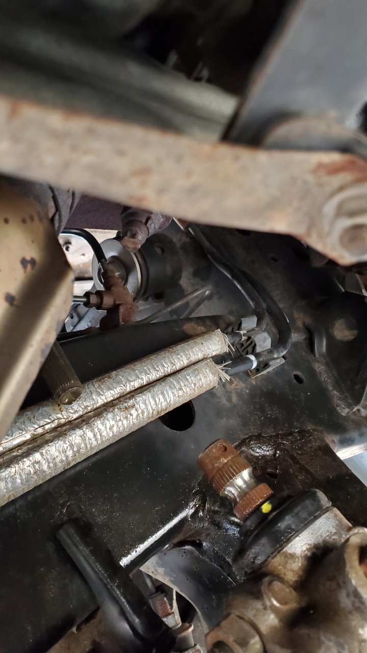

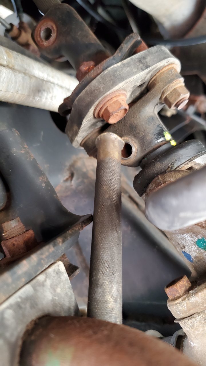

    Alright, I'm to the point that I need help from the sensei's.
    After replacing my steering shaft seal in June my steering wheel was slightly cockeyed. Just enough to be annoying.
    I tried correcting it last Sunday and now it's far worse. The truck drives straight but the wheel is way to the left.
    The issue I'm having is that the coupler only goes on the steering shaft one way. I can't get it to slide on the splines any other way.
    I stole these pics from the sticky thread so you can see what I'm talking about.
    My next steps I thought about are getting the front end on jack stands and making sure the wheel is straight before I try to adjust the coupler.

    2002 AC TRD 4x4 V8
    I pulled off the coupler and now I went too far to the right. Before the wheel was cockeyed to the left. I'm getting a feel for it though. About to try again.
    What I'm finding is that the coupler will only slide onto the shaft in one position. So I'm having to leave it connected to the shaft and make tiny adjustments with the steering wheel. Hope that makes sense.
    But you're right, I clearly misaligned it before when replacing that seal.

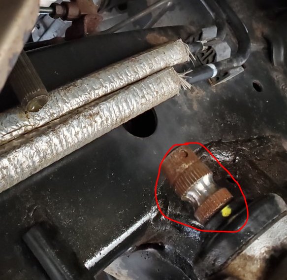

    2002 AC TRD 4x4 V8
    Jacking up the front end earlier was completely unnecessary. I have no idea why I thought I needed to do that. I'm able to turn the shaft from below. I'm not ready to mess with the airbag yet. I think I can figure this out.

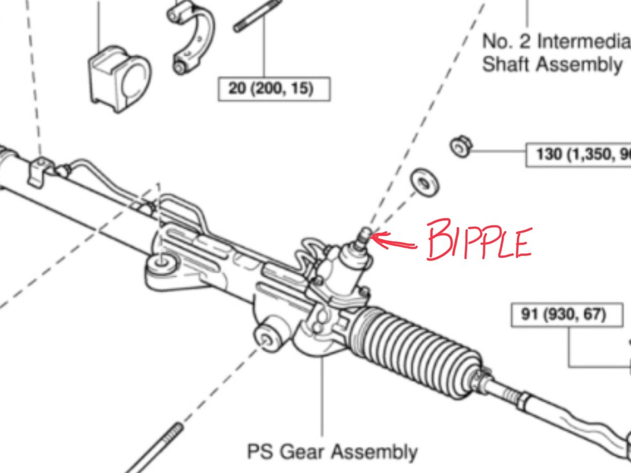

    I just made another minor adjustment and I'll drive it tomorrow to see if it's right. It seems one or two splines makes a huge difference.
    What is the correct name for the circled part that comes out of the rack?

    Hand Protectors
    That part is called the Bipple (aka Big Nipple). Did we mangle the splines? I hope not as that part isn’t easily replaced without New Rack Time.
