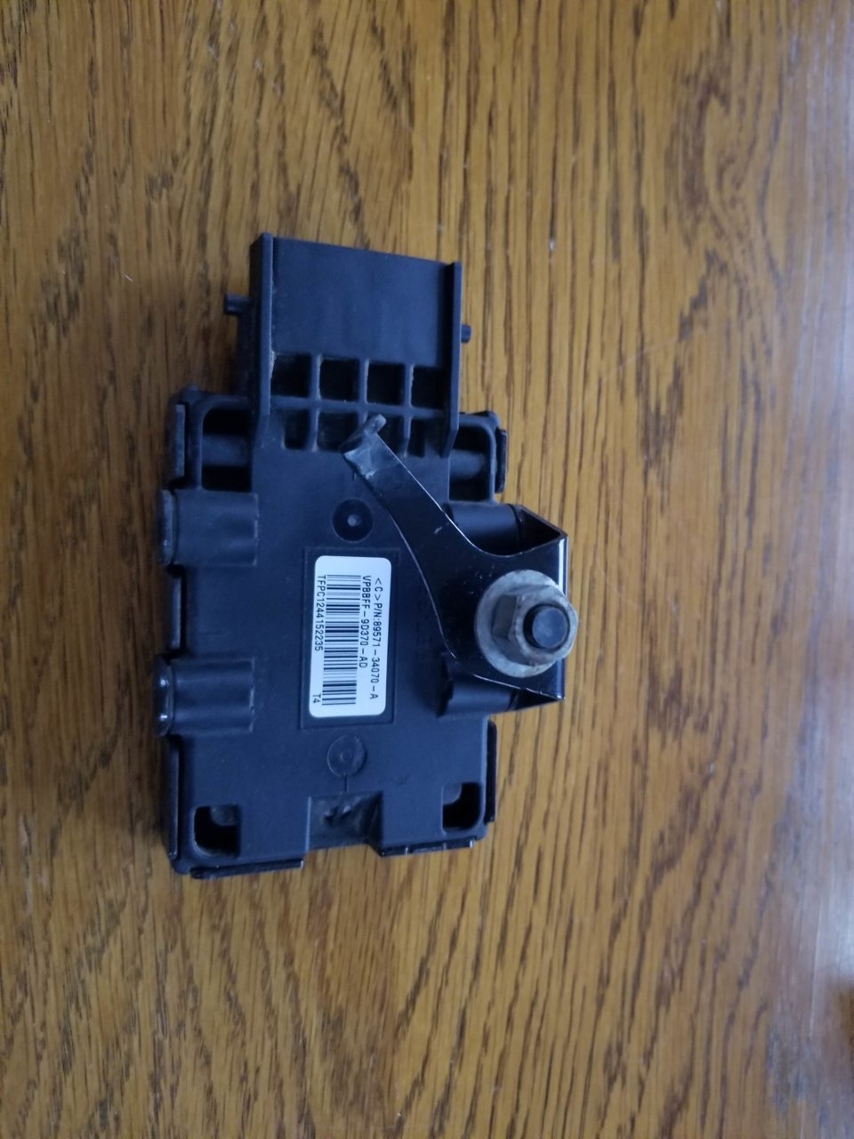

    Did you visually inspect the fuel pump ecu? I know some guys especially up north had bad corrosion and dirt build up all around the ecu. Its mounted on the rear frame rail and can be subject to pretty harsh environment.

    It looks okay (see picture). Albeit I've got a new one on order, I plan to bench test this suspect one today.

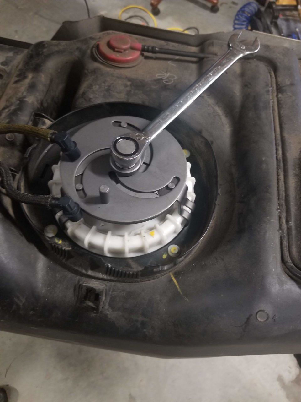

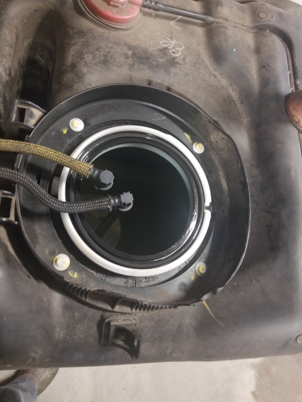

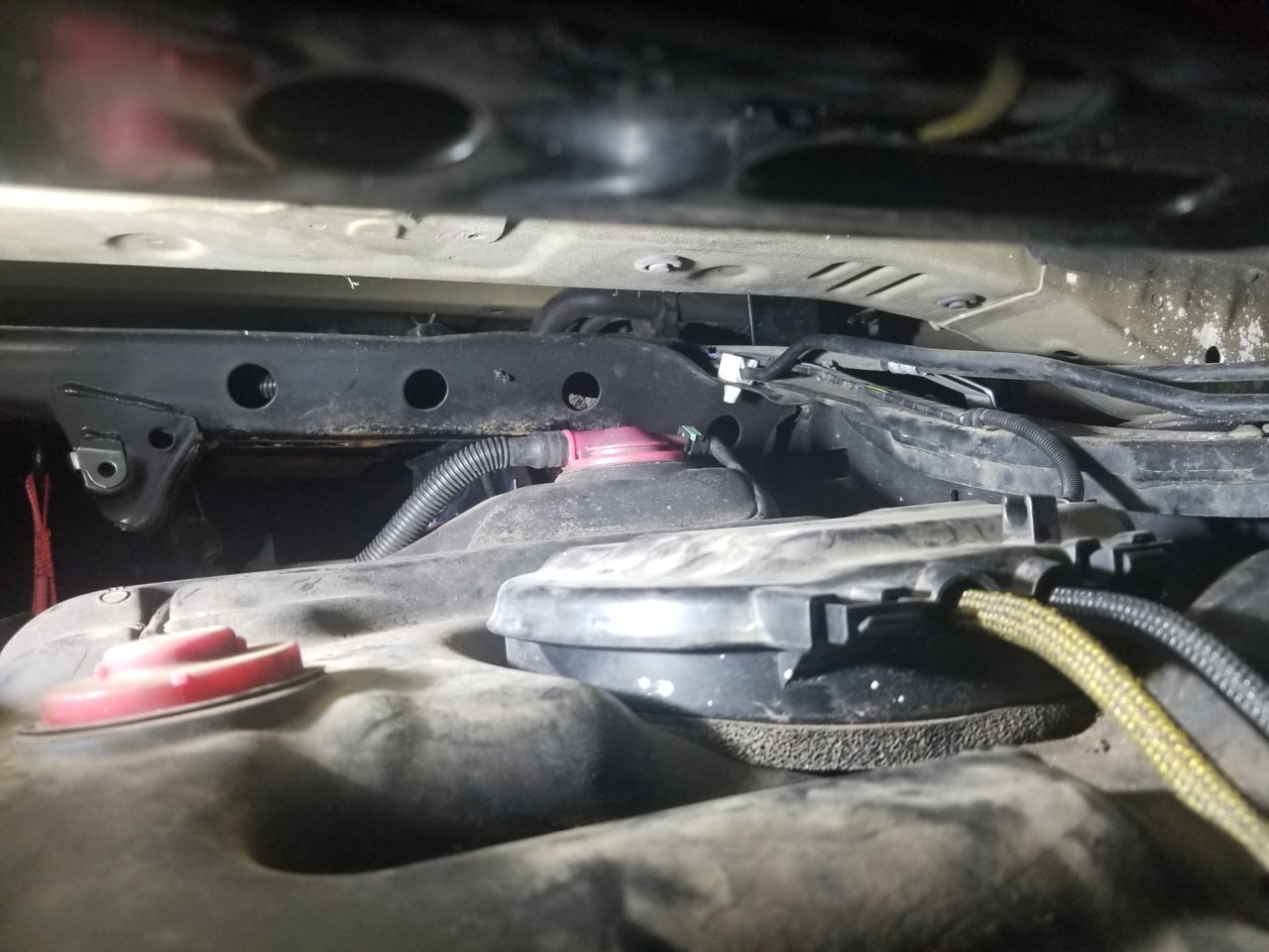

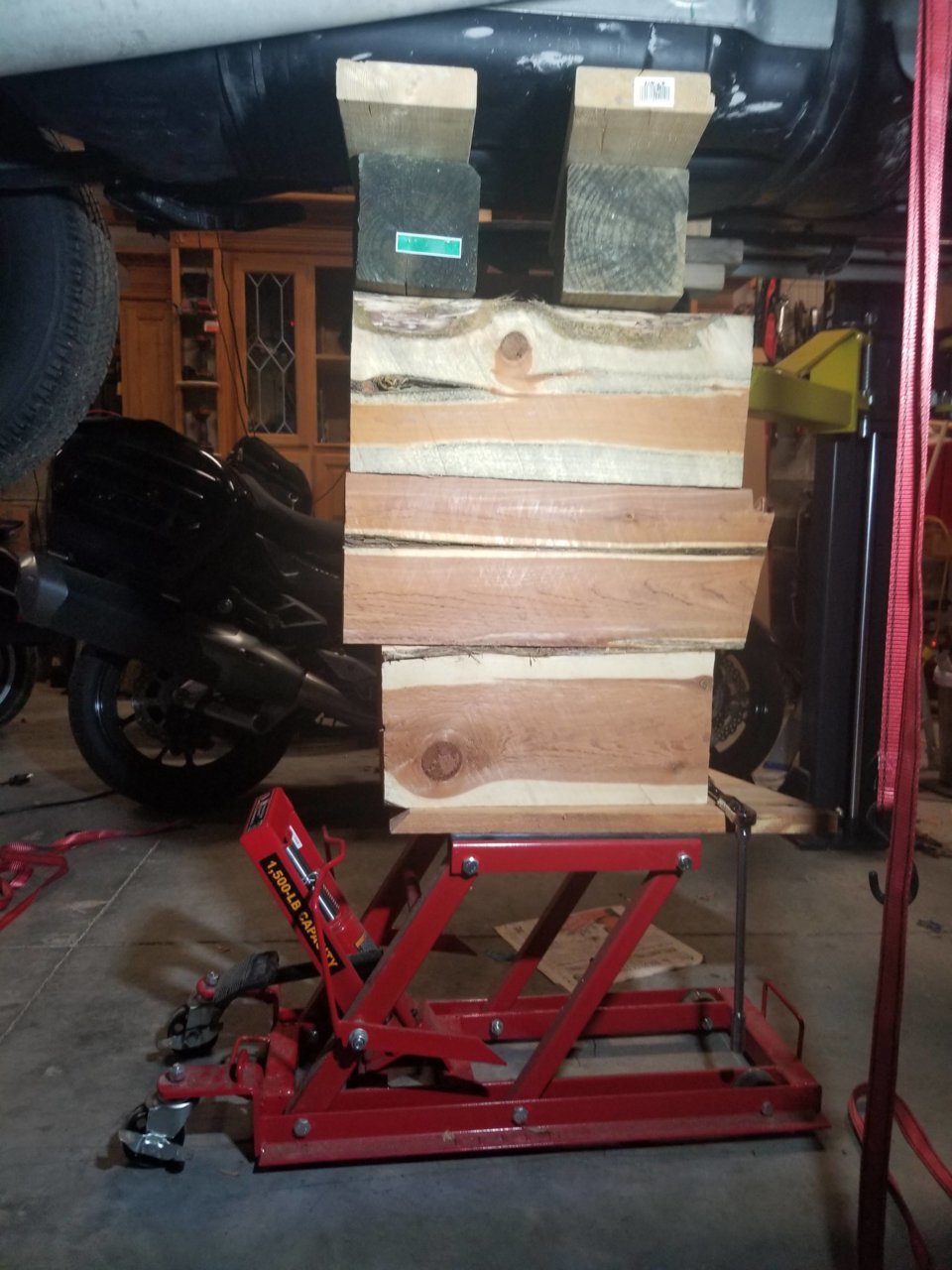

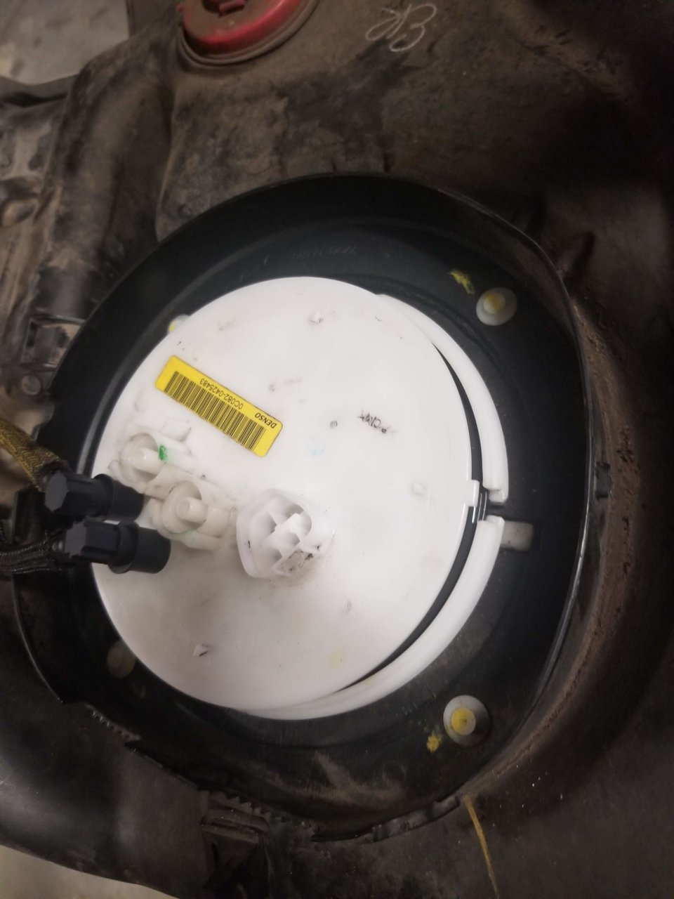

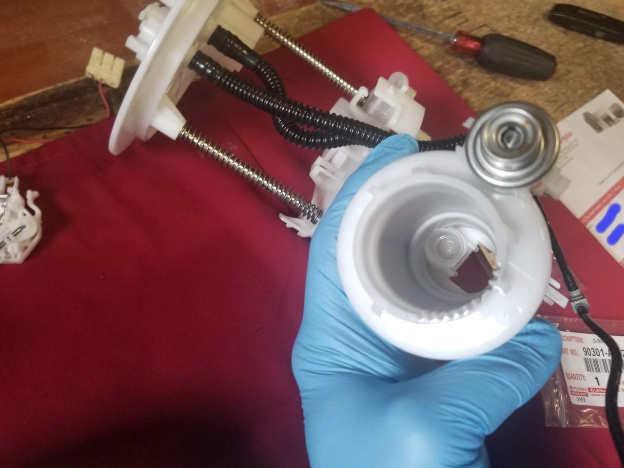

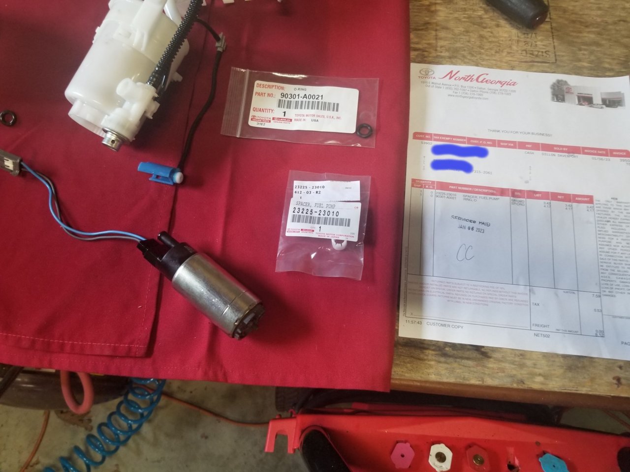

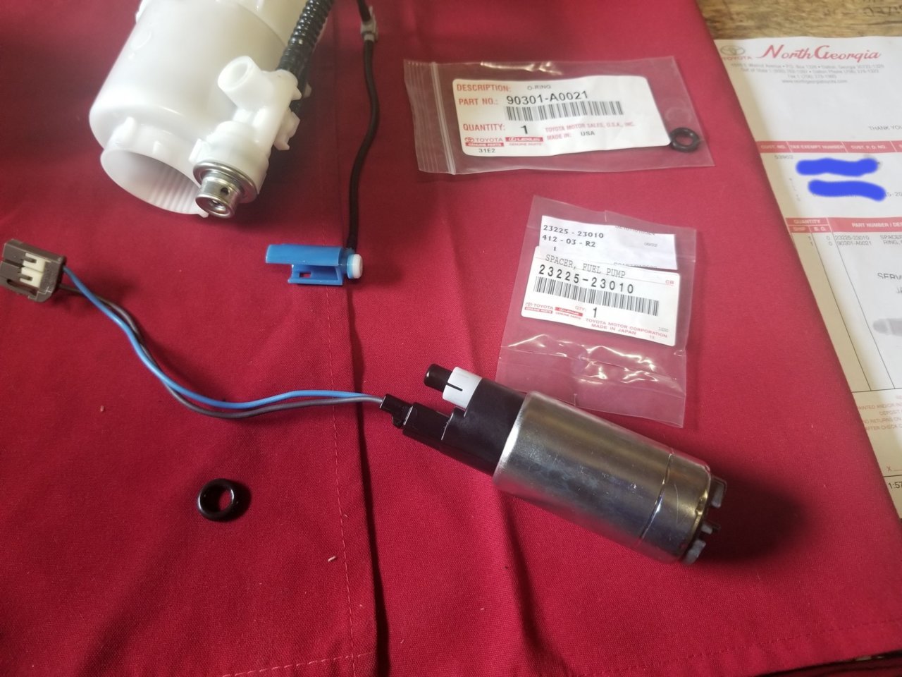

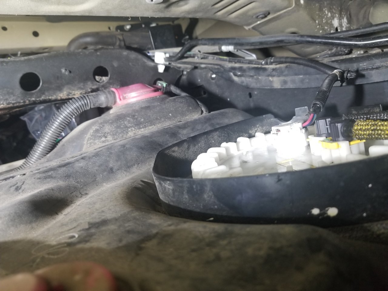

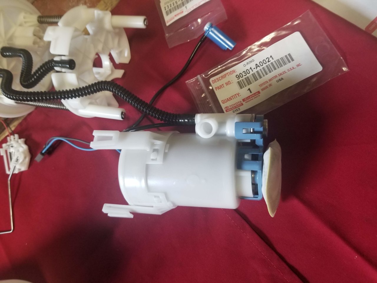

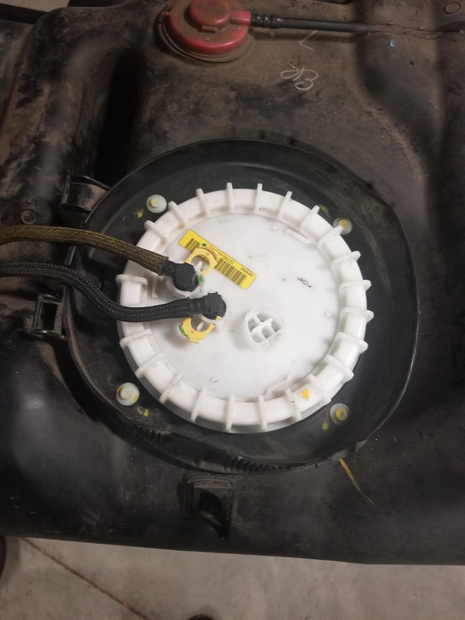

    January 4, 2023 (Removed FP and inspected)
    o Discovered the FP Spacer p/n 23225-23010 was missing
    o Highly suspected this was cause of low fuel pressure and lean codes, so order FP Spacer p/n 23225-23010 and new FP O-Ring p/n 90301-A0021 (for good measure)​
    January 8, 2023 (Installed new FP Spacer & O-Ring)
    o Now starts immediately when cranking as it should
    o Checked “live data” while idling. LONGFT1 read 0%; and STFT ranged 2% to 9% when moving slowly in Drive and Reverse.
    o Believe all is good now. Will make a final post after more extensive road testing.
    o Attached several pictures that may be of value to someone​
