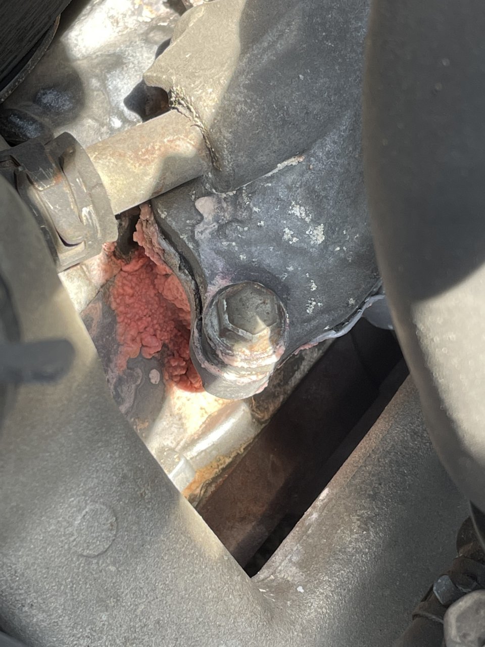

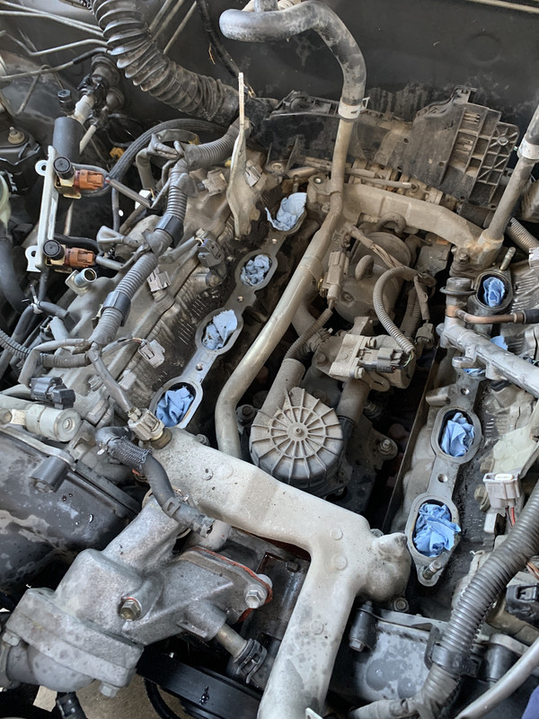

    I noticed this while checking fluid levels this evening. It appears that coolant has been seeping out around this fitting. What would be the best way to seal this? Is there a gasket p/n somewhere?
    not even sure what it would be called.
    right in front and under the black plastic cover over the intake tube. Right behind the serpentine belt. I believe it is the coolant return fitting.

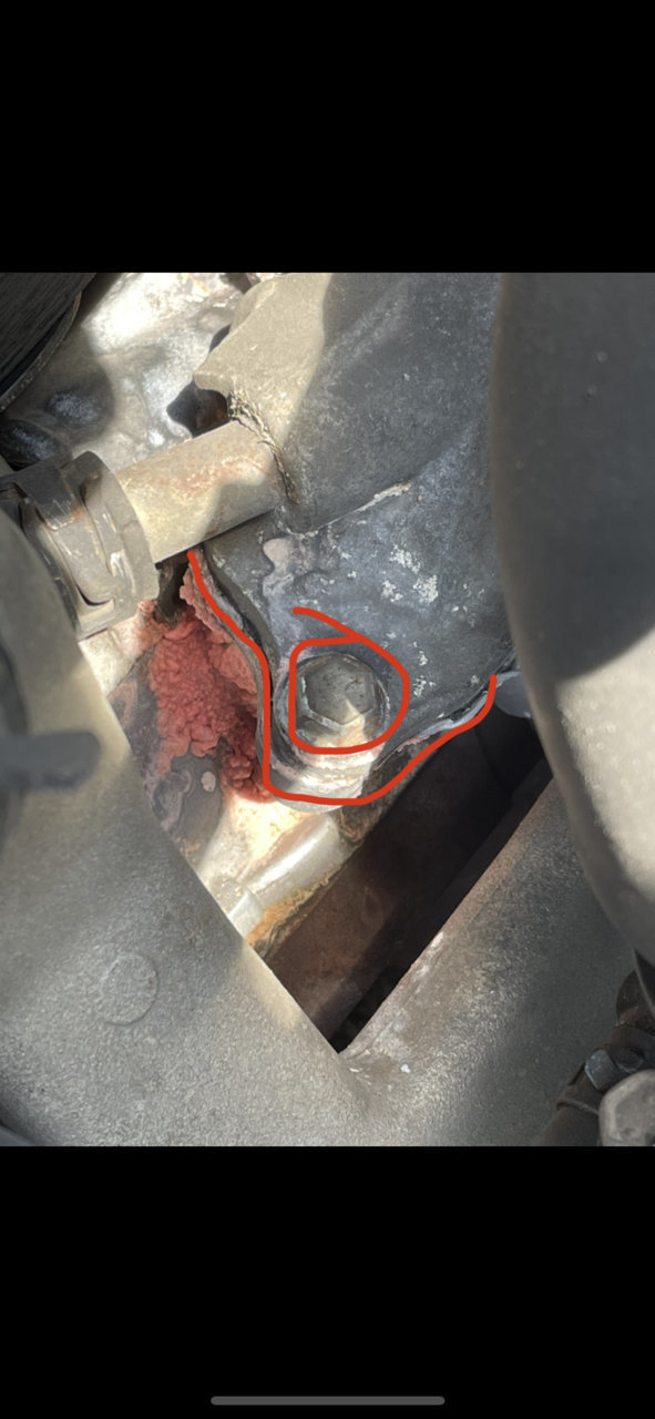

    Further back

    That looks like your water pump.

    That’s your water pump

    Thanks. I thought the water pump was down lower than that.
    would this just be removing that and replacing the gasket?

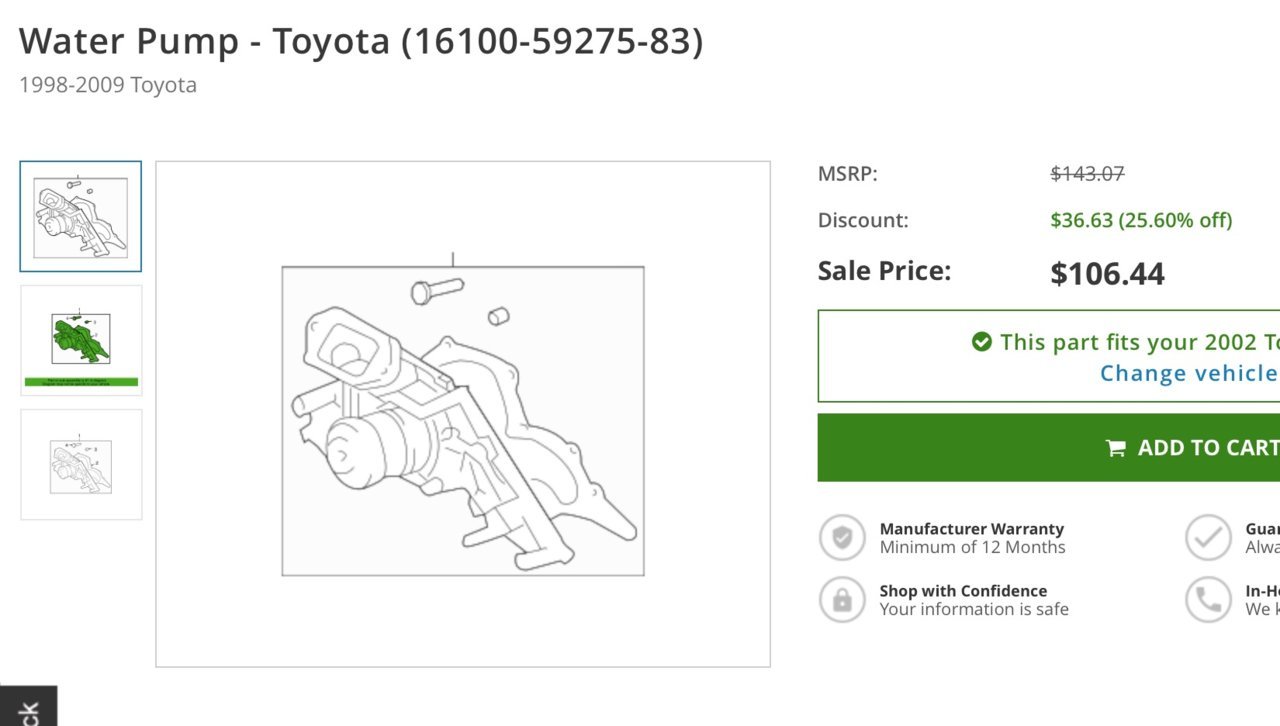

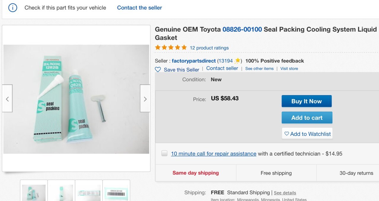

    Yeah. Was thinking WP was lower, too. I think that leak is on the Thermostat housing to block assy. Might need a new gasket or buy some Toyota Green FIPG for Coolant and make your own ($33 on fleebai).

    looks like it’s coming from between the us manifold and what I assume is the water pump.

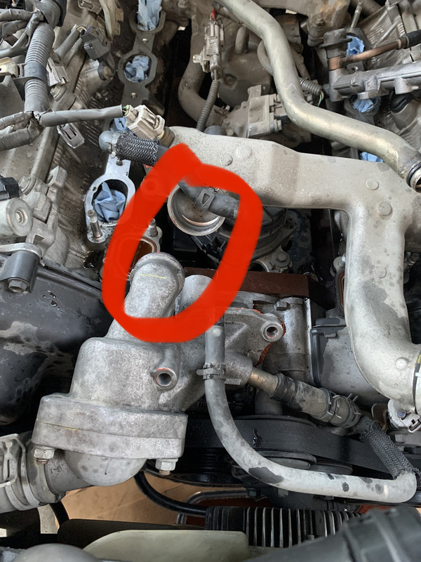

    Hard to tell. My years ago WP leak seemed lower than that as there is a manufactured slot for the leaky coolant on the bottom of the Assy for such purpose.
    You’ll need to start pulling shtuff off and fix it whatever its coming from. :annoyed:

    I do t think so, it sits more at a 45’ angle rather than parallel with the face of the engine

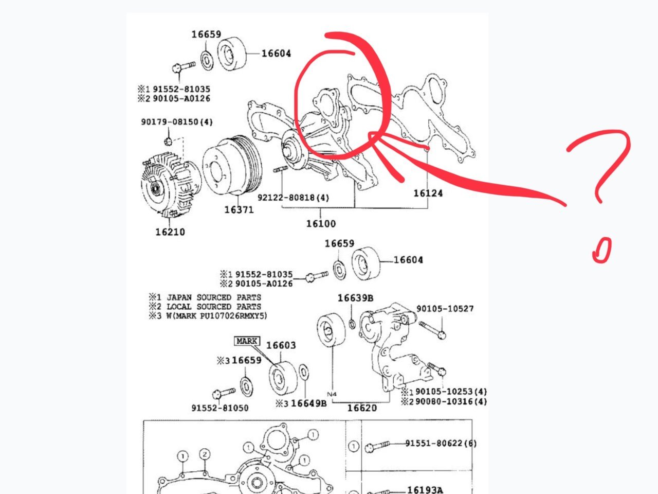

    Yeah. This is the only diagram they provided. Ours is more 45° and rectangle shaped, but same principle.

    Here is from another site. Do your own research before buying parts etc.

    Wooooo price shot up from $33 last year.

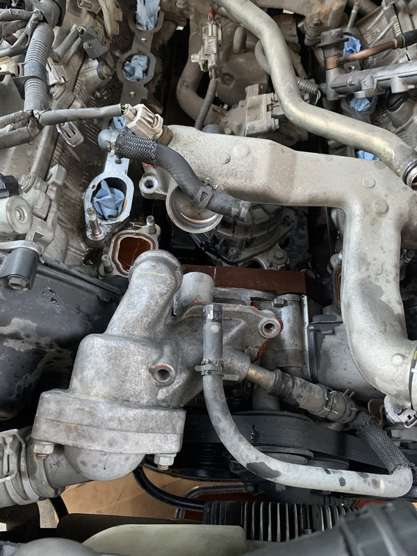

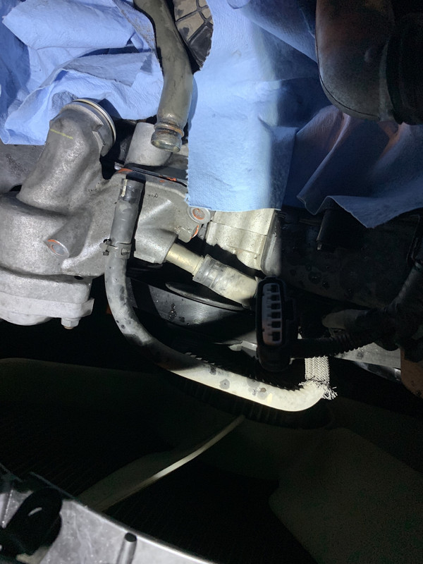

    that is your thermostat housing, it the part right after the the thermostat that meets up to the water pump. Below are some photos of when I had mine off. You can see the orange gasket

    Thanks for the info fellas. I’ll get parts and really want to get this done before our big road trip in 2 weeks time. Doesn’t look like it will be too terrible to get off.

    Remove t-stay housing with 2 bolts. Clean old gasket off throughly, put new FIPG on, tighten, let cure for 20minutes to an hour, add coolant, bleed and likely be leak free. Someone probably did a rush job
    Cleaning the surface when doing the t-belt

    Not pictures but you might want to buy a new o-ring to where it connects to the bypass. My o-ring was shot.
    This should be the part number - 96761-35035. Double check

    Thanks for the help. I ended up trying threebond 1186? Sold as Honda/yamabond 4.
    it was like water coming out of the tube, not at all what I was expecting and the next day the leak was worse.
    I then bought permatex the right stuff. Now it’s been two days and no leaks.
