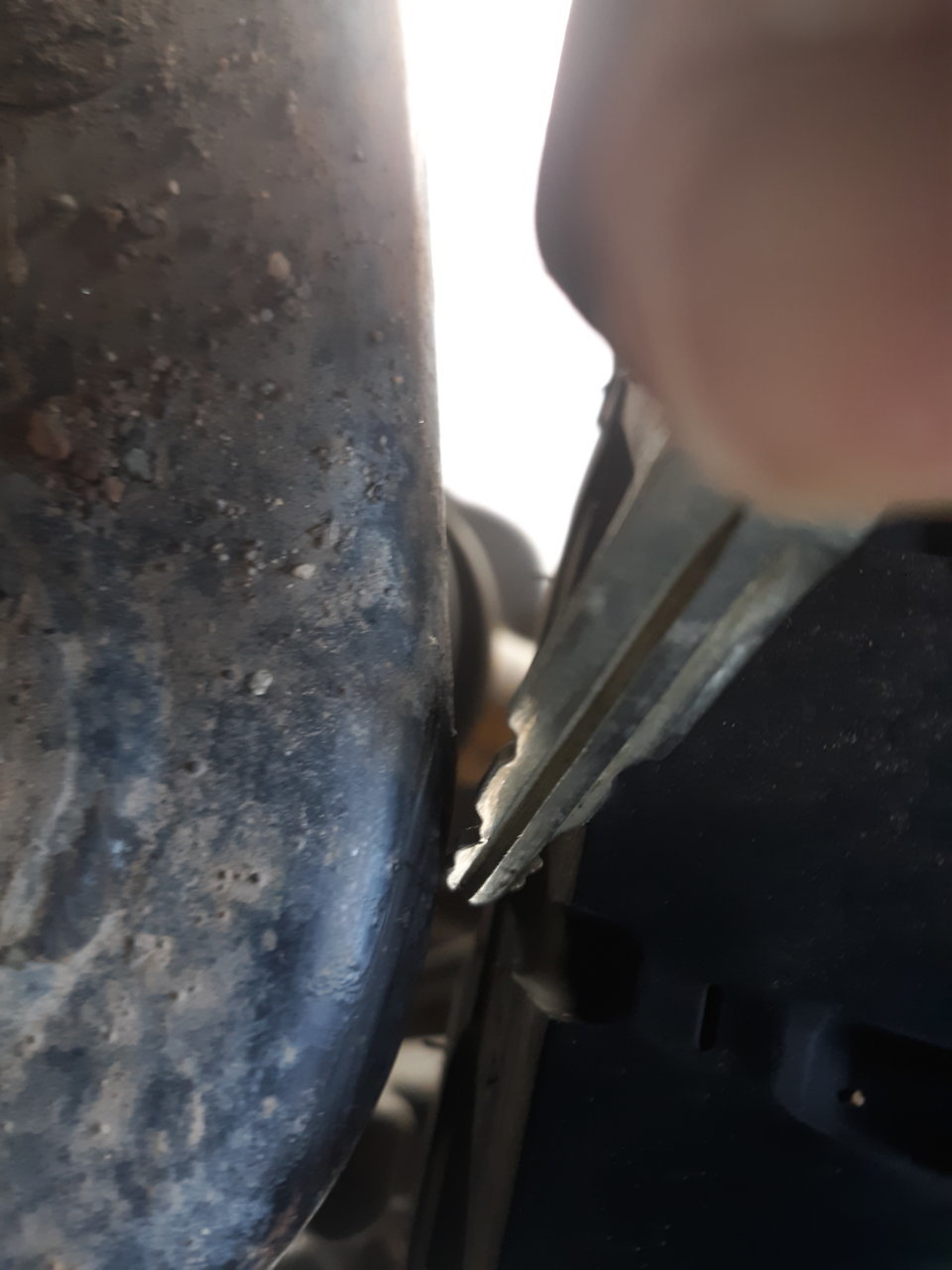

    this is a key between my UCA and tire, the UCA on the left and the tire on the right. the key does not fit in the gap

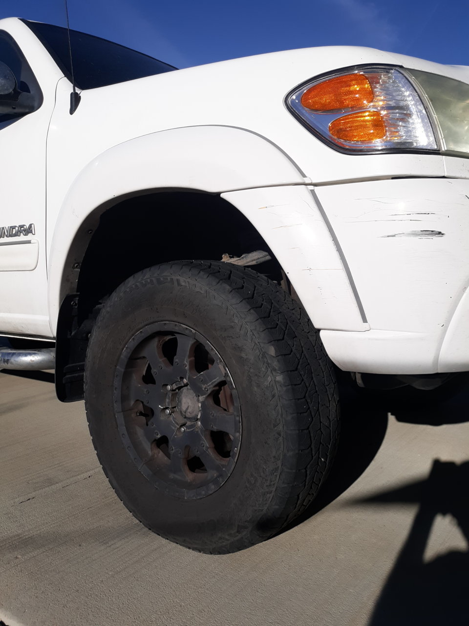

    Snap a pic of the wheel and tire from the outside as well. Sounds like you need either wheel spacers or different wheels.

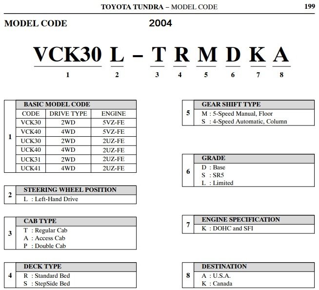

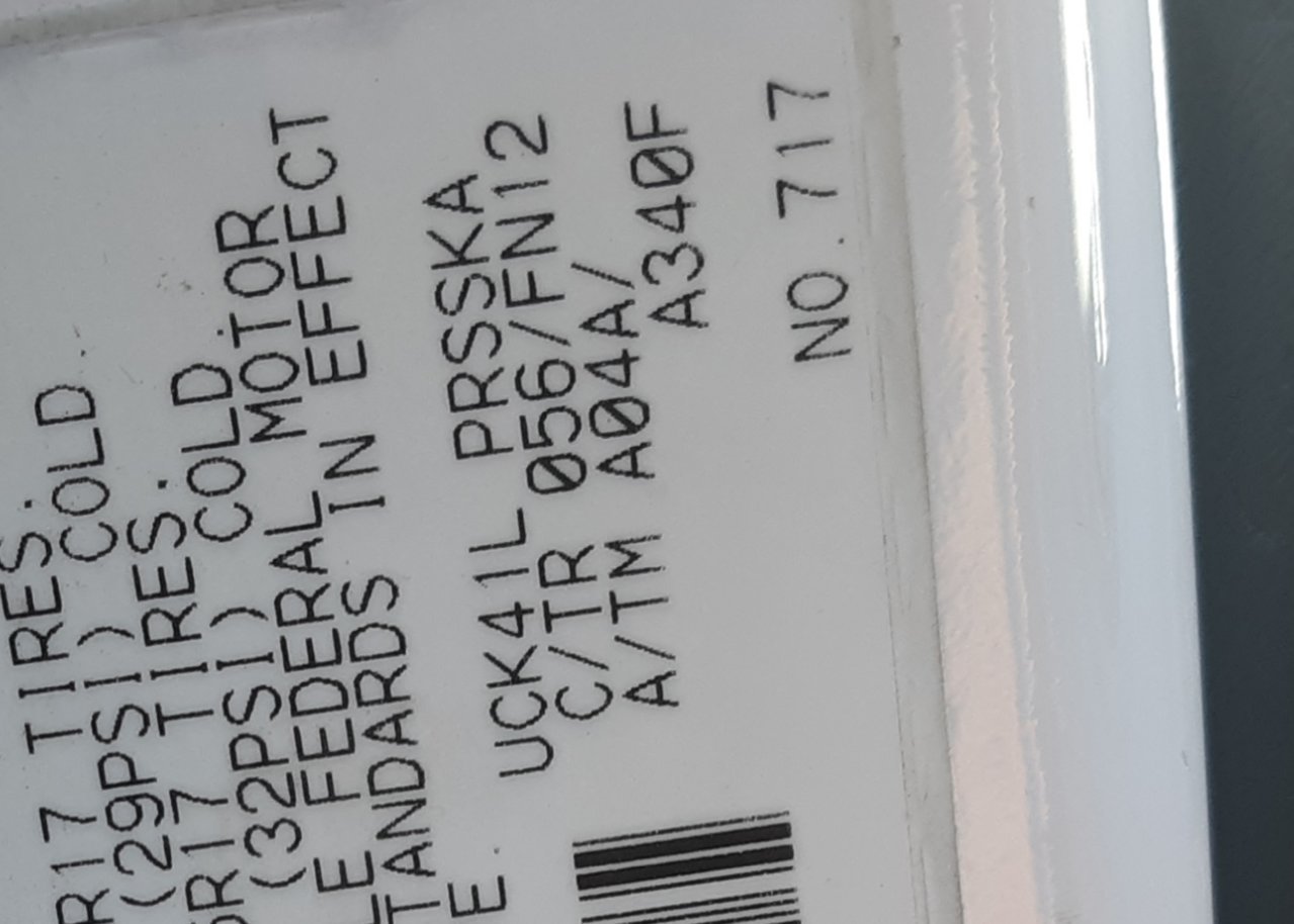

    If unsure and while others help with your control-arms, take a look at driver door frame. There is a sticker like below. Either look up the number in chart or tell us what it is and we can tell for sure. We don't need/want the VIN # but the Model code(numbers/letters in rectangle) is unique to your vehicle and it will tell us what it is. If you post a picture of sticker, try to mask out the VIN # since it's somewhat personal to you.

    it is a 4wd left hand drive double cab standard bed 4 speed auto sr5 . thank all you for helping point me in the right direction to gather info on this. as y'all can tell i don't know anything about this but i want to learn.

    so im not sure if i measured my rim width correctly but i measured from one lip to the other lip on the inside of the rim because the tires are still mounted on the truck. i came up with 9". i don't know if this affects the tire size? like can i still put a 265/65/17 tire on a rim that is ....lets say 7" instead of 9"? i went through a link on this forum and saw stock rims for my truck are 7" or 7 1/2 " i can't remember but it wasn't 9". would getting 7" wide rims help me solve my problem?
