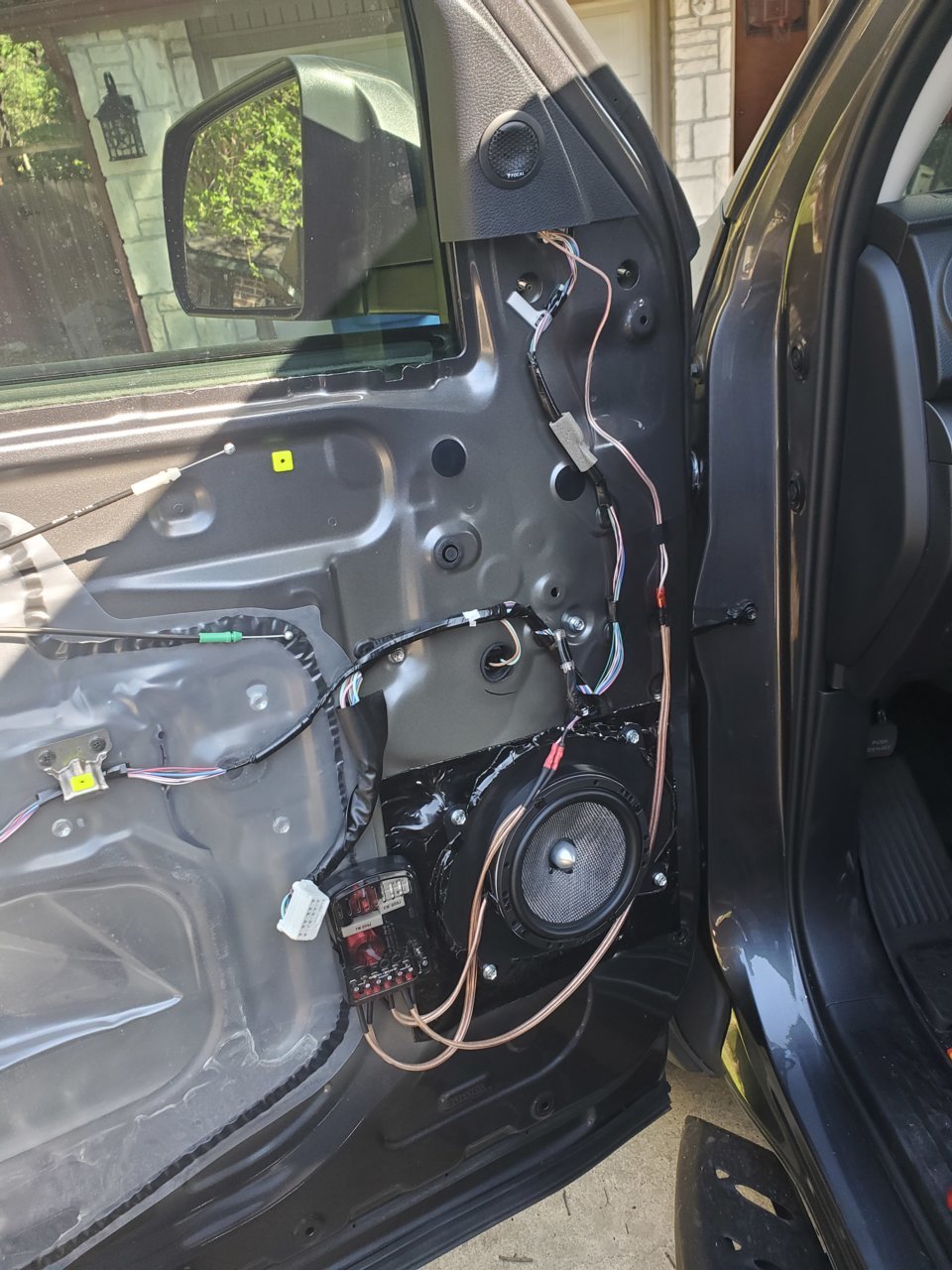

    hey guys. First off, I am no noob to car audio. I'm a bit older at 37, and was an installer back in the day at Circuit City(remember that?). I do installs for myself and friends now. I've done some complicated stuff, but this has me stumped.
    OK. Background checked, here's my question. I have a 2019 sr5 non jbl with tweeter and center dash speakers. I installed an alpine 50x4 amp for my highs. Sounded great with factory paper speakers.
    That said. I just installed a set of $400 component Focals in the front door. Woofer sounds great and hits. My new tweeters in the sail panel
    suck. Hardly any sound, but sound is there. My polarity is correct, and I even switched it up to check. Question is, do I have to place them in the factory dash location? Is there some sort of built in crossover coming to the main door speaker? I know the factory tweeters have a crossover, but my component set is ran straight from the input of the door speakers running a true 50 watts...Any help is appreciated. I've installed plenty of amplified components before, and the tweeters can be piercing, but this focal set is a dud so far. Thanks.

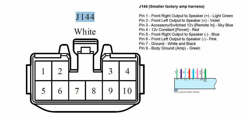

    You shouldn't need to touch the wiring in the dash, just the stuff under the seat. I actually used some solid 16 gauge wire to make jumpers to test out the idea, then got this kit from AutoHarnessHouse: https://www.autoharnesshouse.com/41112.html
    I'll see if I can find the wiring diagram I used.

    These are the diagrams that'll get you the wire positions, but the colors probably won't line up.

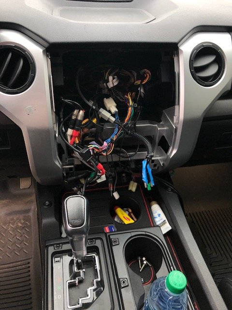

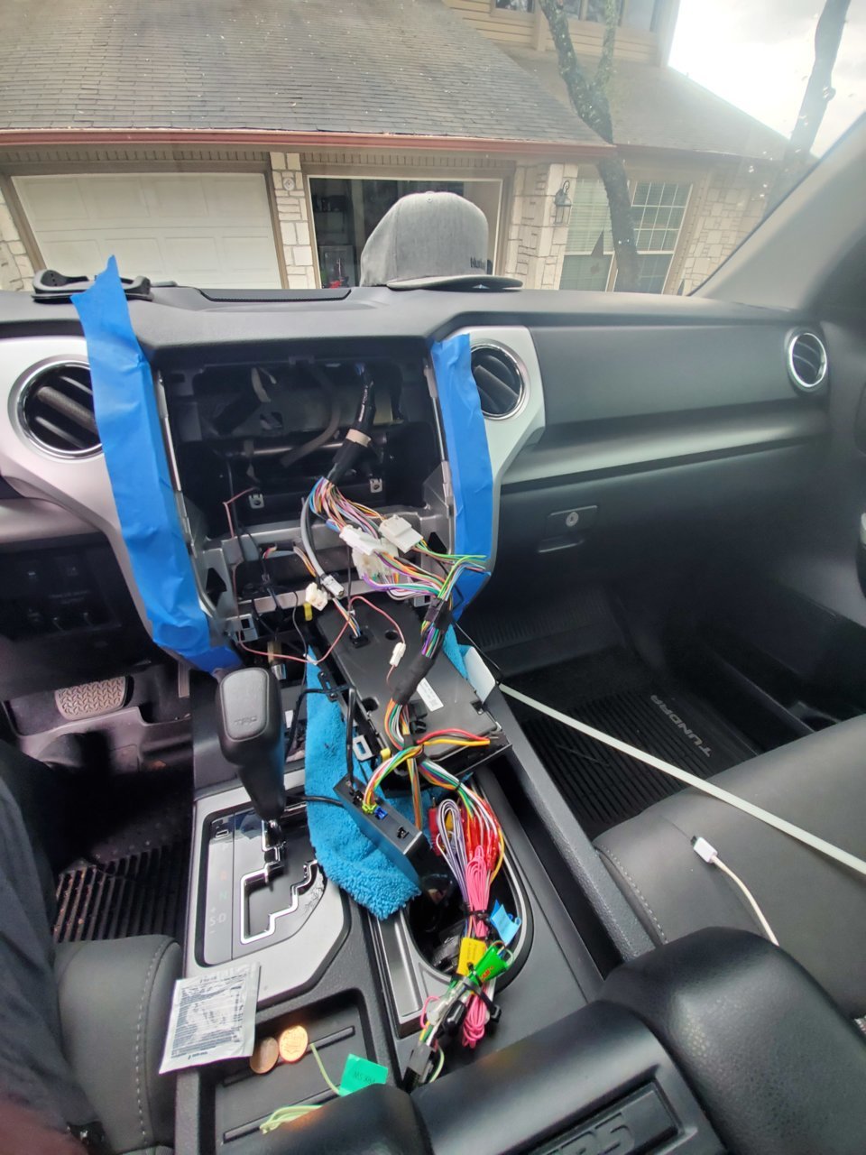

    If I understand everything correctly, the best thing you could do right now is take that harness, use @TRDFerguson wiring diagrams and bypass the factory amp.
    Or run your own speaker wires from the amp to the doors.
    But I'm not sure how you wired it.
    Did you go
    RCAs to the amp from the Alpine.
    Speaker outputs from the amp back to the wiring behind the HU?
    What did you do with the back doors?
    There is plenty of room behind the HU, you just need to tuck it all up..

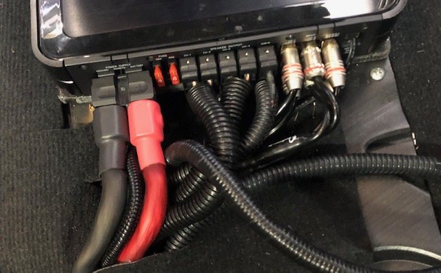

    This is my setup:
    Aside from the normal power wire,, remote and ground..RCAs to Kenwood from Alpine for signal. Alpine harness is cut and capped only at door speaker connections to bypass the for signal at RCAs. Alpine speaker outputs have wire ran to Maestro harness. The Maestro harness is basically the same as the factory harness coming in.
    I don't see a maestro in there hehe. There ain't no more room...

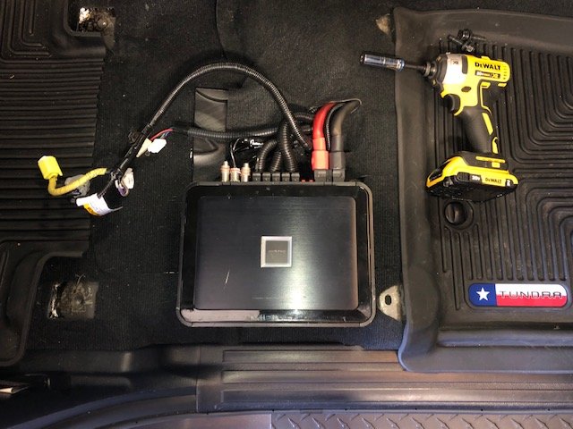

    I think we need to see picks from under your passenger seat....is the factory amp still there? If so that is likely the source of your issue. The only thing speaker related that will hook up in the dash behind the HU is where you clip off the the white and grey RCA speaker wire ends to wire into the dash speakers. Everything else speaker related for the doors will need to be tapped into the wiring harness that is plugged into the factory amp under the passenger seat if you are using factory wiring to run your door speakers. Here is a diagram for my Kenwood and hopefully yours is similar....my tweeters for my focal components are in the dash and when I first hooked them up, the dash speakers were not working because I didn’t have those 2 RCAS clipped and hooked into the front channel behind the HU (I also have the maestro). But your 4 channels from the amp will need to be hooked directly into the the wiring harness under the passenger seat to get the correct sound going to your doors.

    Thanks, but I'm just call it a day for now. Basically, I now know that the factory amp is hindering the performance. I didn't even know there was a factory amp in the first place. I'm using an alpine power pack that is stashed in my glove box. I tied into my speaker wires from the factory harness(meastro) behind the dash for my output. Just for reference, I did not touch anything under the seat. The snipped RCAs you pointed out were done on the maestro harness on install. I installed the Maestro and Kenwood like 4 months ago without one hiccup.. Everything worked pefect. I know its something simple, if my Kenwood made a huge difference in sound after install. I'll most likely mess with it sometime down the road. I have heard just way to many wiring setups and variables. I'm over it for right now haha. Help is greatly appreciated though. Sound is still pretty good, just not so much from the focal tweets. I still get sound out of my dash tweeters. Sound is still better than stock.

    yes that’s your issue. Order the harness adapters for tech12volts, completely remove the amp under the passenger seat and wire your speakers accordingly and then you won’t have an issue. (Or shouldn’t). Make sure to run a new remote wire though directly from the head unit....when I used the remote wire at the factory amp location I would get weird power pulses cussing the amp to pop but other than running power, remote, and ground under the passenger seat it’s simply Hooking up the correct wires from the harness to your amp the the 4 doors.

    Just a heads up;
    You could have installed that wanna-be amp under the passenger's seat with the harness suggested, using all the existing factory wiring.
    In the process bypassing, and REMOVING, the factory amp that you didn't even know was there..
    You wouldn't even have had to run a power line from the battery, and you'd still have all your glove box space.
    Yes there is plenty of room behind the HU if you know what you're doing,
    I even have my XM tuner in there.
    Perhaps not knowing what you are doing is part of your problem.
    Next time do your research before you install equipment.

    Did you check to see if your speaker is centered in the opening in the door panel?

    yeah my dumbass didn't check to see if there is an external amp. I mean, I didn't get the premium sound so you got to cut me some slack for not knowing.
    Big thanks to the help I received on here
    Yeah, I'm sure the factory amp is hindering performance since it is still there. I'm just going to order the harness from tech 12. I'm gonna put everything back to "normal" and just take it from there. I'm just gonna remove the factory amp under the seat and place my new one there with the harness.
    A few people mentioned that I was pretty much clueless when it comes to car audio. That is hardly the case, although it is freaking hilarious that this mickey mouse amp gave me such a headache. Here are some install pics from my previous 2017 f150 with non premium sound. There was no "external" amp. Those were found only in the premium sound models. This is a full custom job performed by me and only me. It took about 2 months to complete. I first amplified my highs, then threw a powered sub just to get by at first. When it was all said and done, I was running one 12 inch w6
    ***factory 8 inch syn3 retained, JBL gto front and rear speakers at 2.3 ohms, JL audio RD 400/4, JL audio RD 500/1, LC7i, brand new kicker 16 Guage wire ran to all speakers (that was actually the hardest part). I have since sold my f150, but there is still a video on it on YouTube under Night Stalker.***

    The wiring schematics on these trucks isn't the most intuitive, and there are about 3 or 4 different configurations out there that I'm aware of... So don't sweat not knowing exactly what was going on in this situation. Also, there are about 50 million different ways to upgrade the sound system and make it sound great. At the end of the day, if you get it working the way you want it, awesome. Don't worry about other people on here making assumptions on your knowledge or what you "should have done instead."
