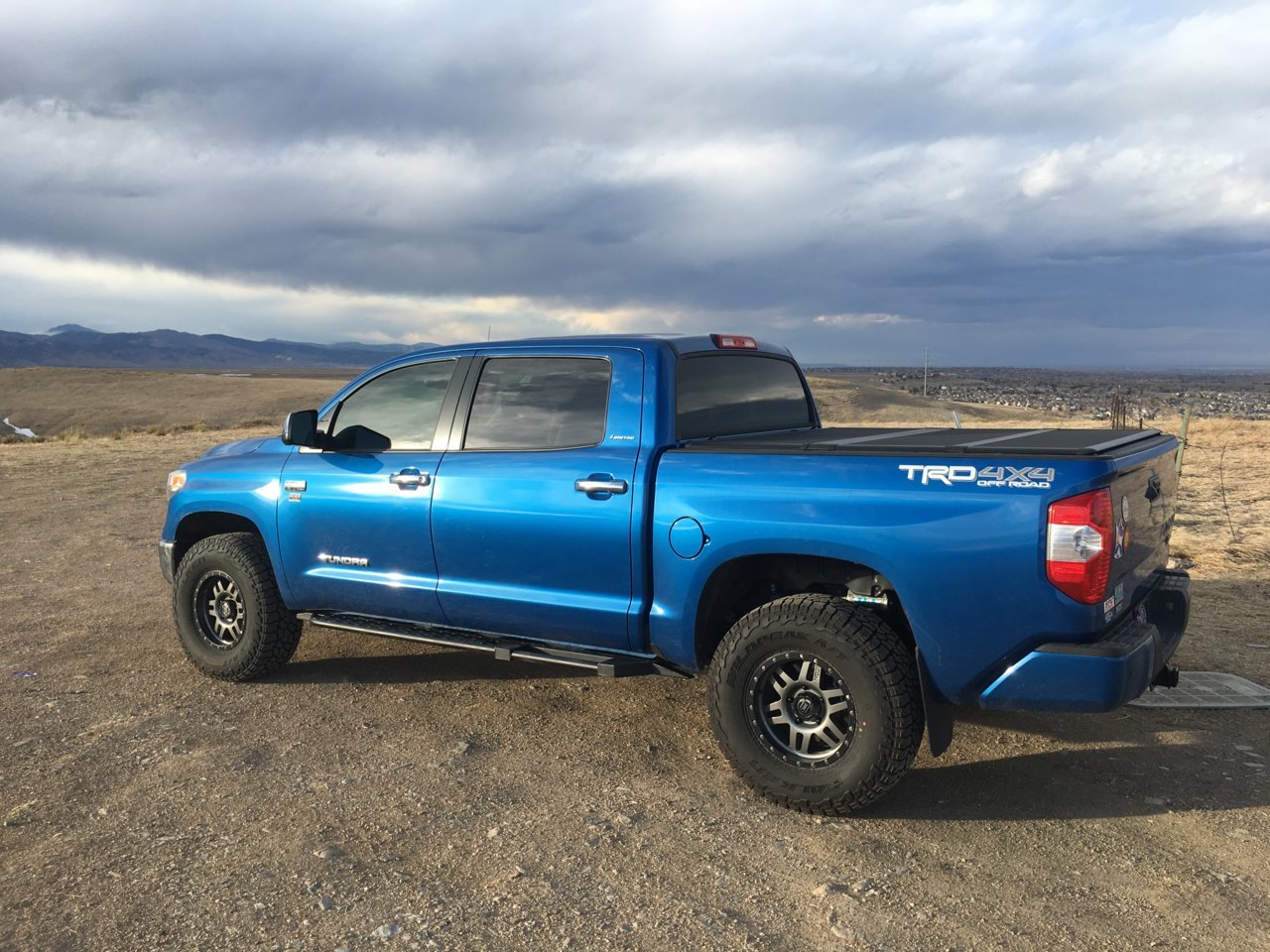

    Started with this. Stock other than Spidertrax wheel spacers.IMG_2672[1].jpg
    Here's where I'm at now:

    Some pictures from King install. One of my buddies came over for an afternoon and we installed ourselves. Should have taken more pictures, but it started to get dark and cold and was taking longer than we anticipated. Overall, the install went great and I'm super happy with it.
    Started with the rear, installing King 2.5 remote reservoir and Toytec shakles, installed at the second hole.IMG_2786[1].jpg IMG_2789[1].jpg
    Then moved on to the front. King OEM 2.5 with remote reservoir. Changed out the UCA's to SPC at the same time. Had looked at the Total Chaos and Camburg UCA's, but advice was to go with the SPC's from multiple sources. Passenger side went on relatively smoothly. Was expecting the driver to be better since we knew what we were doing. Instead, we ended up spending twice as long trying to get everything to fit and in place. Not sure what we were doing wrong, but it sure was wrong. But took a break and figured it all out.IMG_2804[1].jpgIMG_2794[1].jpg
    Front lift was a bit under 3 inches. Rear a bit over 1. Was left with a rake of about 1 inch.
