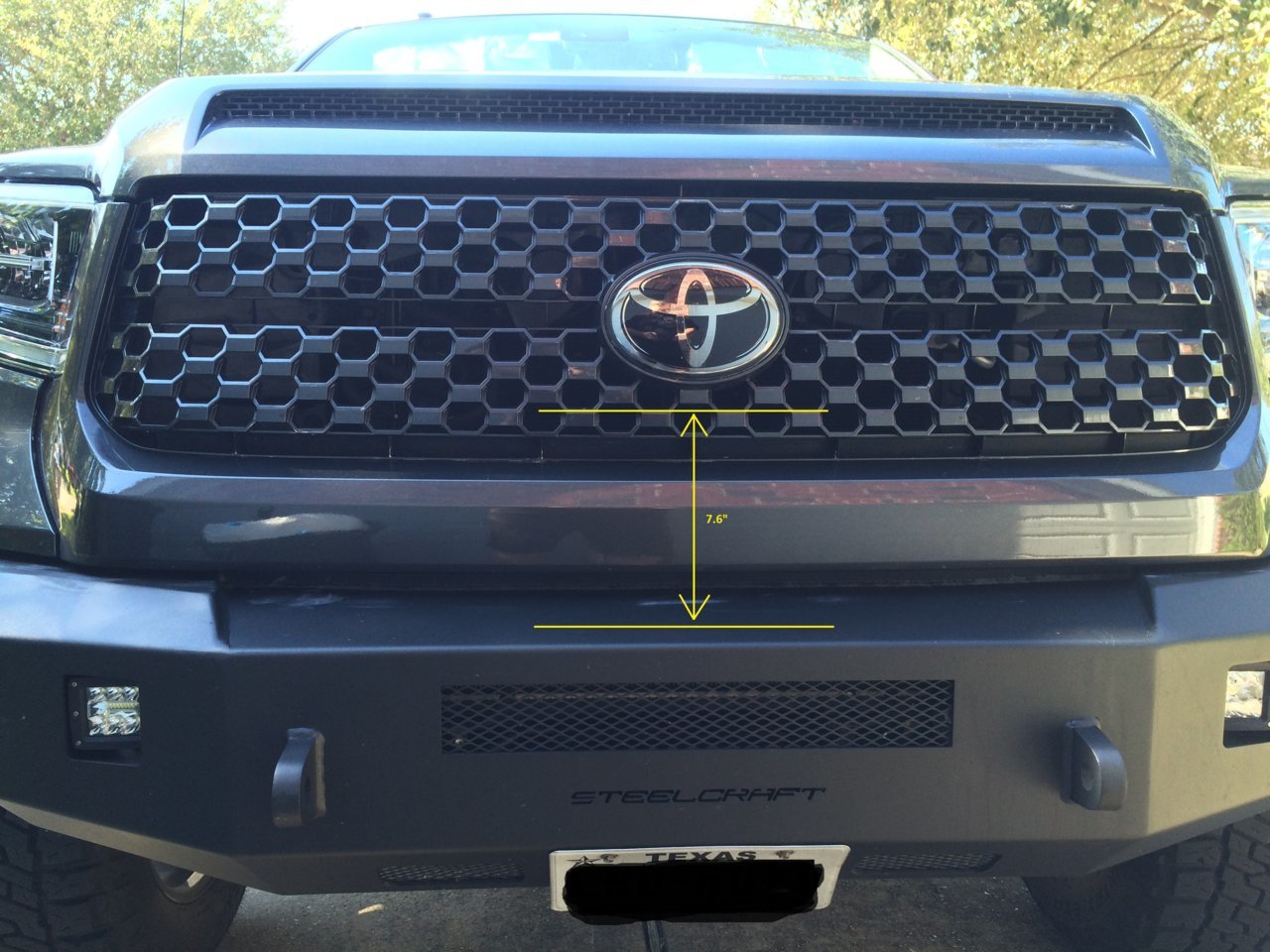

    I am getting ready to install multiple LED pods on my 2018 CM but I need to figure if I am going to have an issue with the bumper LED's creating any obstruction to the collision radar sensor in the grill "T" emblem. I am looking at some pods that are 7.6" tall:
    After measuring, it looks like I will have about 3/4" of gap between the top of the pods, to the "T" emblem. Those of you whom have experience with this, do you think that I will be in the "clear"?

    As long as there isn’t anything directly in front of the emblem you shouldn’t have any issues.

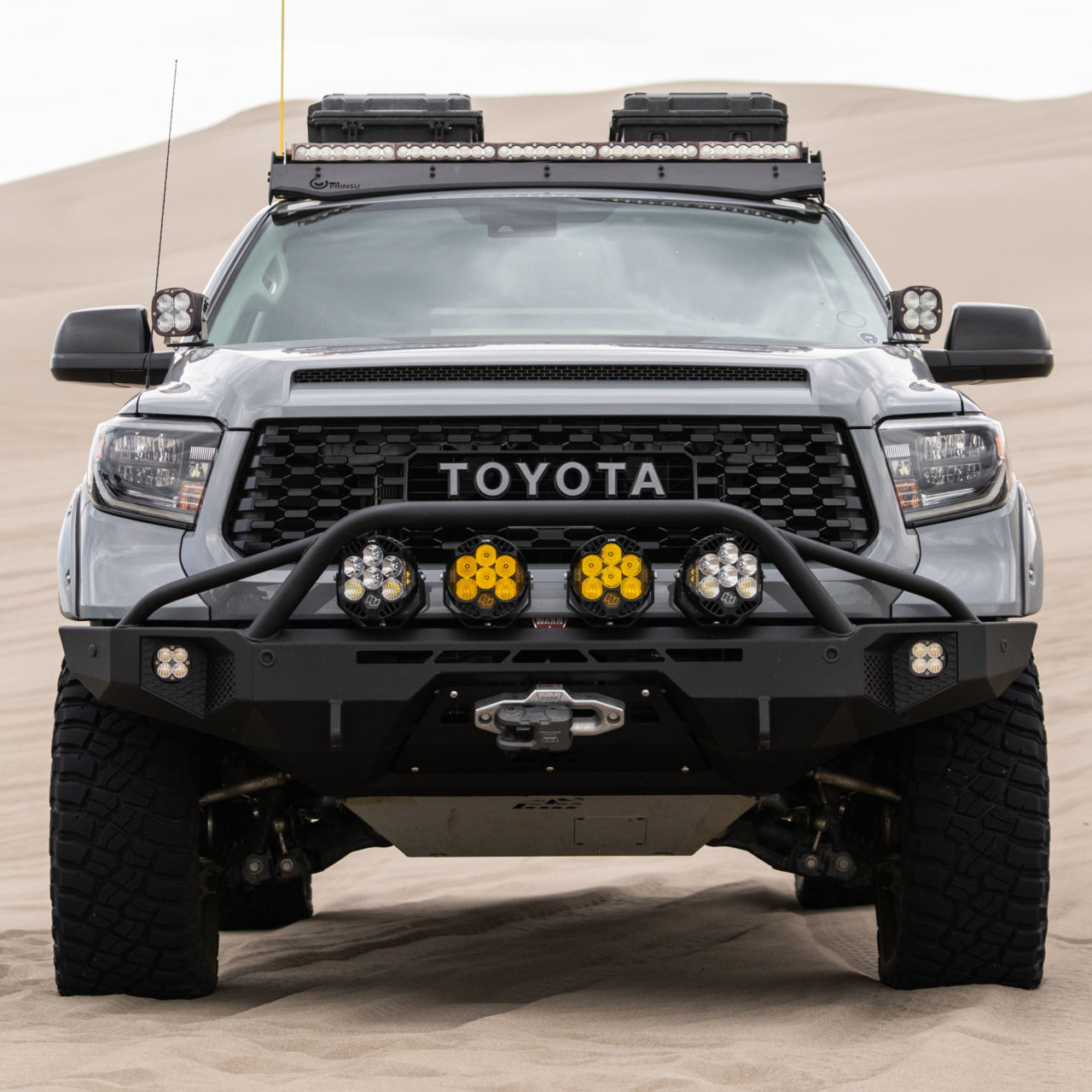

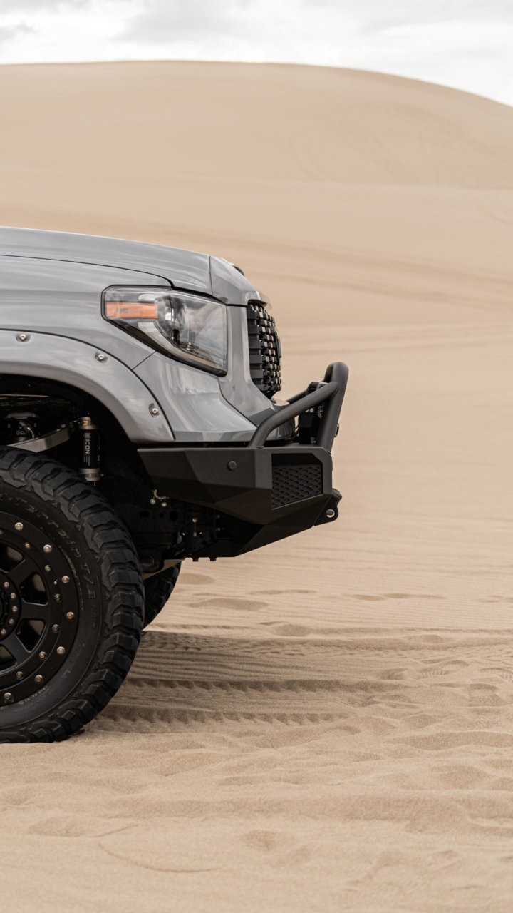

    I just ordered a bumper and am having the same concerns.
    I have the Limited grill, we shall see in about a week. Not my truck in the pic.

    That will intefere, most likely.

    I did some measuring, I'll find out, if so, Ill just swap grills and relocate the sensor. CBI, whose truck is in the pic said it did not interfere with the Pro's sensor location.
