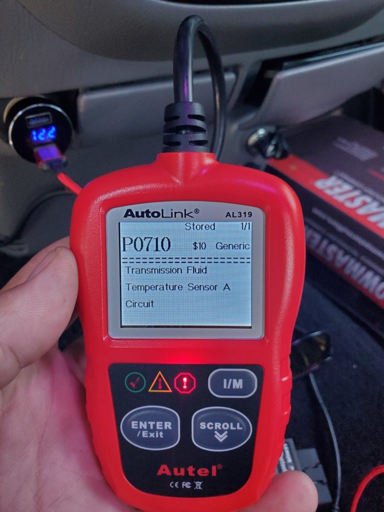

    My check engine light is on because of code P0710. I changed the sensor yesterday and deleted the code but the engine light came back on for it. Truck shifts great and no trans issues to report. It is has a 2003 tranny swap. Anyone have any ideas. I used the search bar before posting this and didn't find anything credible.
    thx
    Drew

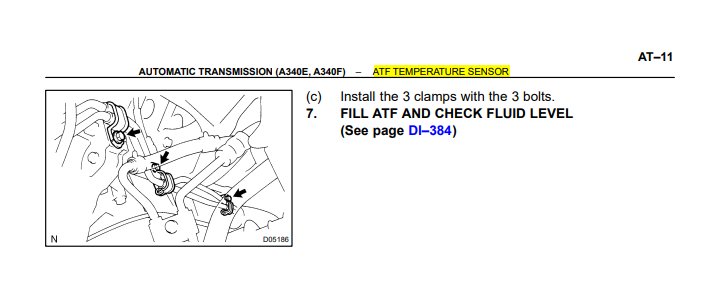

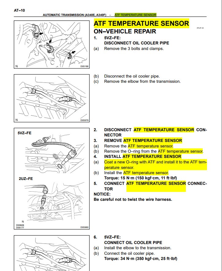

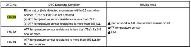

    Double check that you followed the proper procedure when replacing the ATF temp sensor. Check the wiring for a short and then if all good, it's an ECM issue.
    A340E/F INFO DUMP | Toyota Tundra Forum
