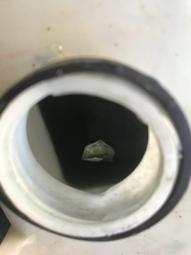

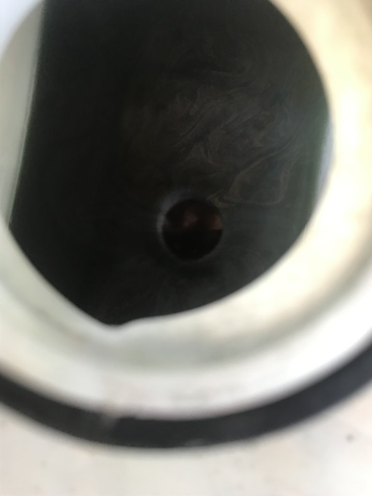

    Anyways I did notice the coolant was blue when I checked a few weeks ago, and knowing it is supposed to be red I wanted to do a flush and get some Aisin red in there but I haven't gotten to it. Engine temperature has not changed at all, it never gets hot, stays at slightly below half always when driving, so I didn't make it a huge priority. But then I checked today and the coolant reservoir level was much below the needs fill line and was no longer clearly blue, it was pretty solidly black. and had shiny look of oil or something similar. I'll attach pictures. There is also one of those little foil seals from a bottle or something in the reservoir (!??).
    I just recently changed the oil so I don't wanna drain it, but the dipstick looks normal and there is no white foam or anything anywhere.
    Thoughts? Do as good of a flush as possible and see what happens? Any other diagnostic tests or similar I should do? Radiator has lots of miles who knows when it was last replaced.
    Drove 60 miles today just fine with a half cord of wood in the back, same temp as always.

    I recently bought a Camry, and it had blue coolant. Blue is for Hondas, and has more or less the same HOAT composition as our Red and Pink coolants. But I'm AR, and it just bugged me..."it's not supposed to be blue!"
    So I bought a bunch of distilled water, drained the system (be sure to find your block drains), filled it with the water and ran it for a while. I did this twice more until the water started to look clear(ish), then finally filled it up with pink. No problems before, none after...but now it's pink and not blue!

    You've definitely got an issue somewhere. Have you inspected the timing belt? What's the status with that. Because you lost coolant (doesn't matter the color) kind of suddenly, and you've got increasing noise I would start by pulling the serpentine belt and checking pulleys and the tensioner. While you're there, pull the driver side timing belt cover back a bit and have a look. Post pics if you have questions on what it's supposed to look like. If by checking the serpentine belt pulleys and tensioner yields nothing, it's time to look deeper. There's no "regular" piston slap/diesel noise on these engines. Something's wrong.

    Do you know for sure that the overflow tank was full before? I've had to top of the overflow on a few of my vehicles before, not often but I don't really think much of it when it is just a bit low. I'd say at least pull your overflow tank and empty it and wash it out with a water hose and put it back in with some distilled water since you don't have any of the blue coolant. It shouldn't hurt anything to put just a little bit of distilled water in the overflow until you can do the full flush.
    Exhaust rusting out maybe? Muffler getting a hole in it?
    Could remove the serpentine belt and run the engine and see if any of the noises go away, if the noise goes away spin each pulley and see if one of them is making a noise.

    Check your transmission fluid. There is a transmission cooler in the base of the radiator and if the seals fail you're mixing coolant with transmission fluid.
    If the trans fluid looks like milkshake you found your problem.

    Indication of a head gasket, I believe. Would also explain the blackish coolant. Summoning @shifty`

    Before you throw any more parts at it, it might be worth scoping the inside of the cylinders and pulling plugs to see their condition. I think you can buy cameras cheap these days for less than $40 on Amazon.

    white smoke is the biggest red flag of coolant in a combustion chamber.
    you can let the white smoke hit you hand and give it a touch/ smell. You'll get your answer
