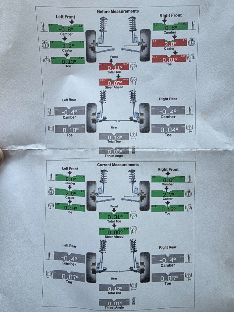

    Has anyone had to get a CMC with 0 offset and 295/70/18's? I had an alignment done yesterday after removing the Toytecs and installing Bilsteins and now I have rubbing while turning in reverse. I haven't checked to see if it's on both sides yet.

    It is both sides.

    I had to CMC with your exact same spec. Sidewall/tread aggressiveness plays a factor, but the basic guidance I give is to plan for it with your offset/tire selection.

    That said... don't you have SPC uppers? Did you have the shop push your tires all the way forward using the lower cams? You should have been able to make a good amount of room there.

    Yes I have SPC's. I'm not sure what they did. I can post the alignment sheet this evening.

    Here is the alignment sheet.
