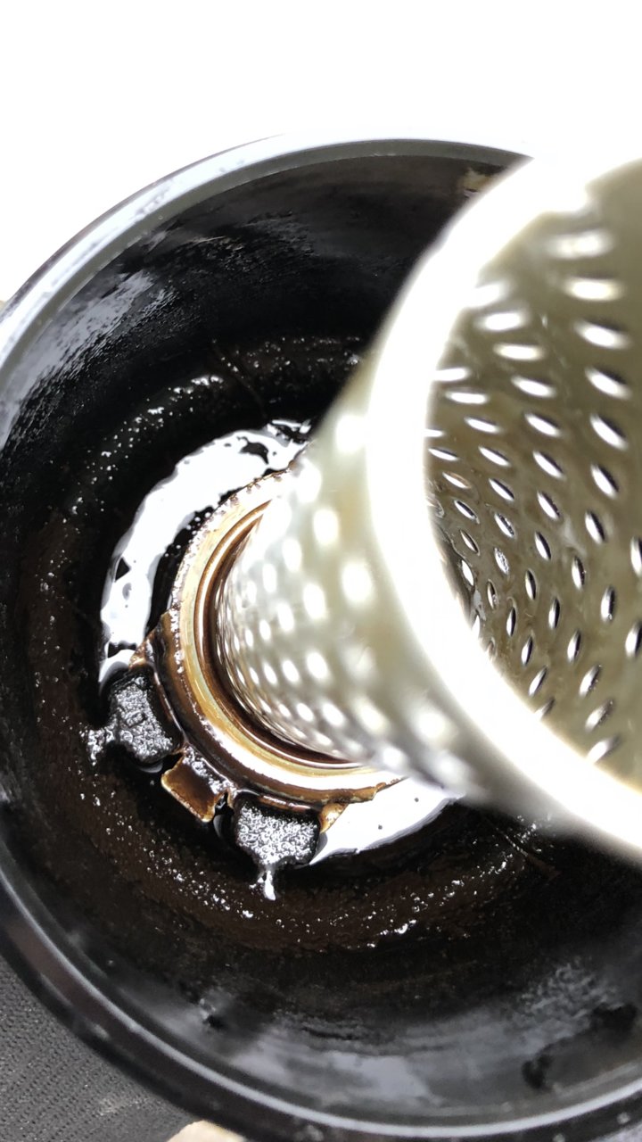

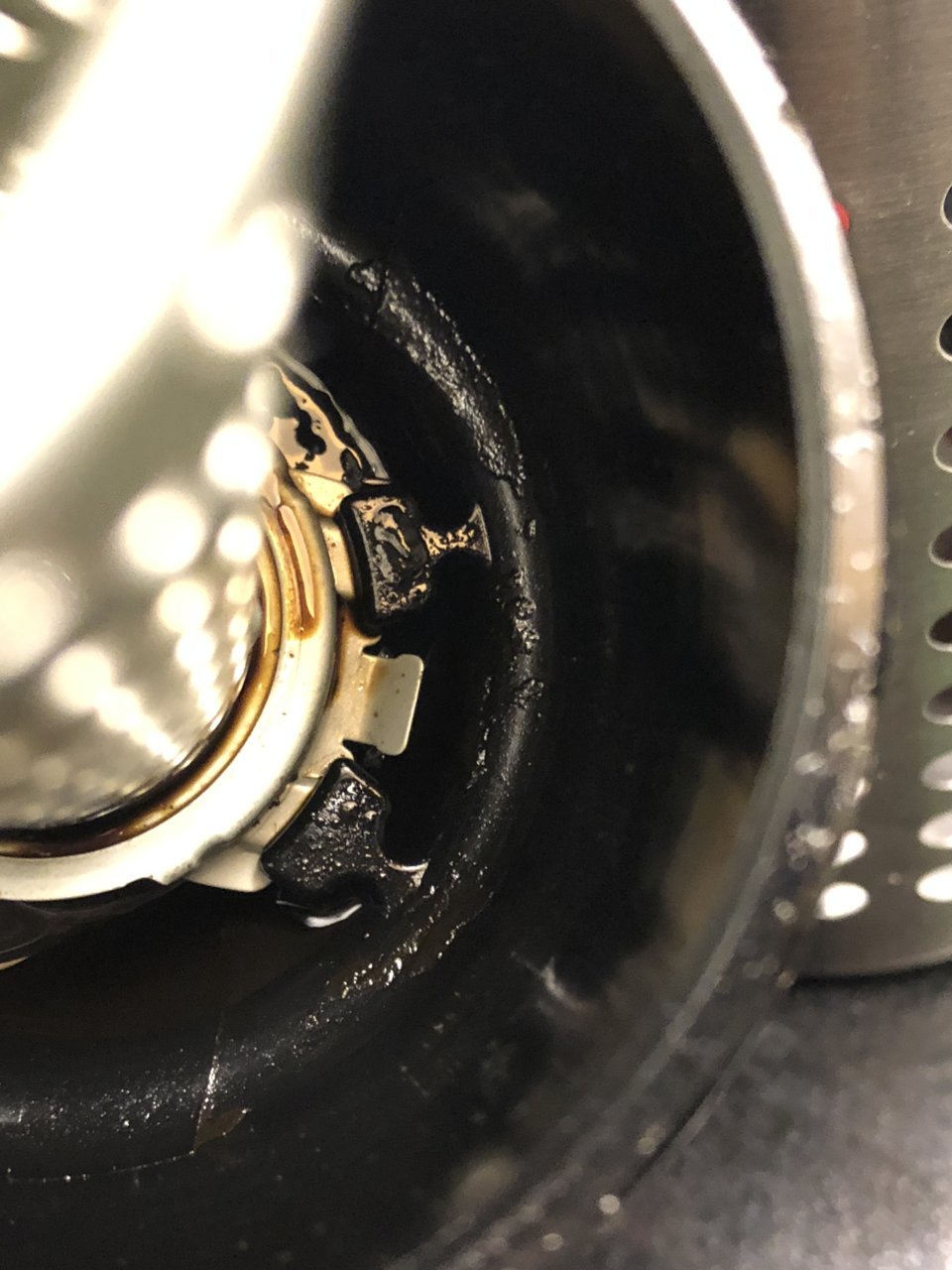

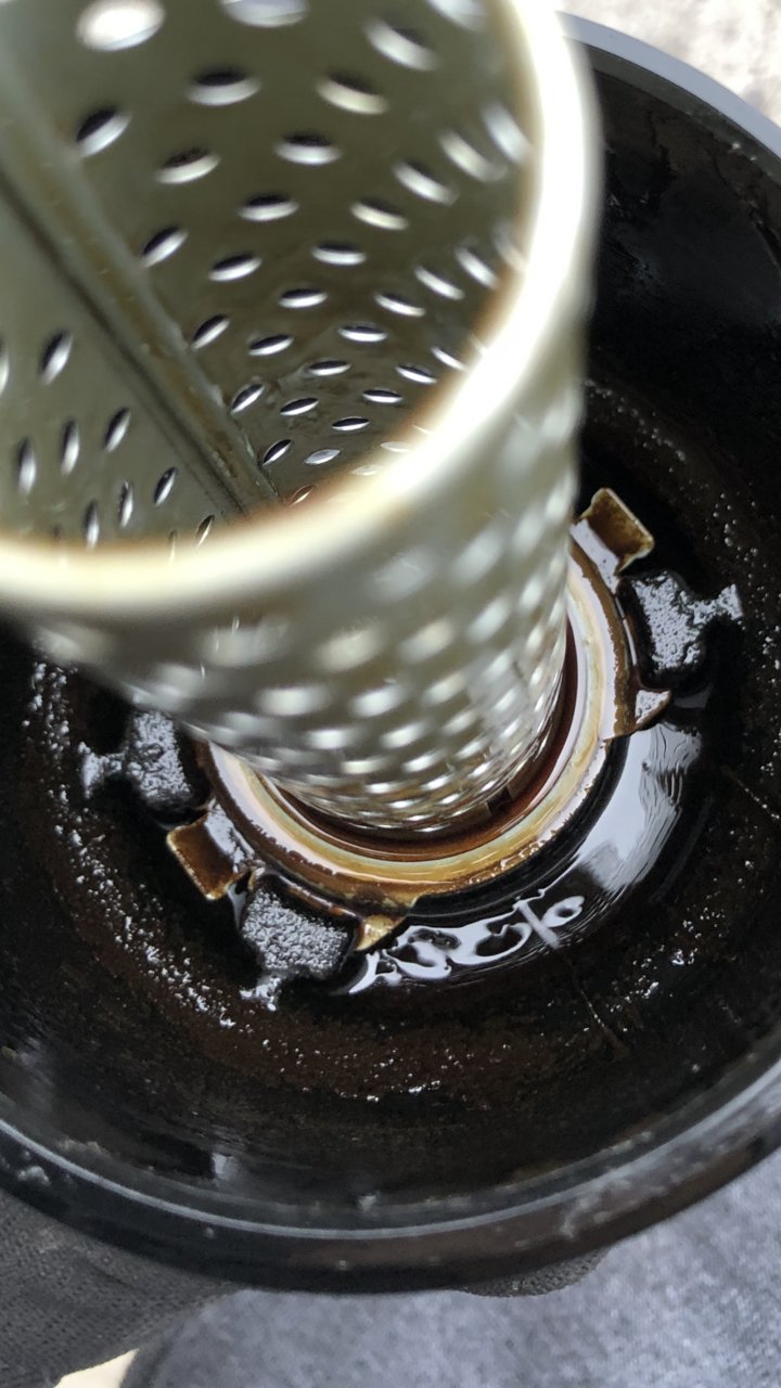

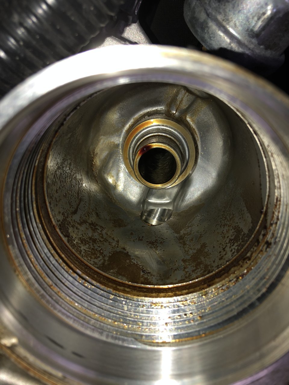

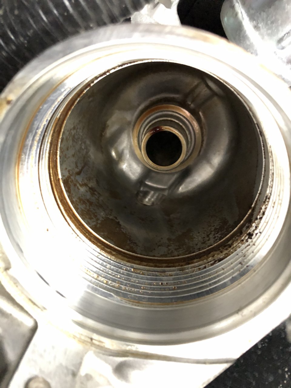

    Hey guys, little worried about what I saw when I changed my oil today. This is the 3rd time the oil has been changed. First two by the dealer and the third by me. Truck has 14k on the mileage. So when i pulled the oil canister that has the oil filter inside I noticed a lot of “grime” on the inside. 482DAC3C-0185-4BEA-8E7D-C0C23C1A3F17.jpg0D4579DF-E9FB-4751-9F47-D7B2B223F0BD.jpg
    It didn’t feel grainy. Not sure if this is normal. I also had some grime all over the walls on the inside, where the canister goes into.
    I know this is the are where the gunk goes to, but this seems like an excessive amount of crap. But wait,

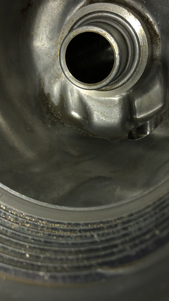

    there’s more! After I cleaned it up I noticed a crack on the inside. Hers a pic. In the other pics there more of the grime on that side where the crack is.
    I hope this isn’t something I need to worry about but something doesn’t seems right to me. What do y’all think!?

    Most likely the dealer never changedthe filter. And you know they didn’t wipe out the bottom of the canister either if they did. They are notorious for being too lazy to pull the skid plate off and change the filter. It’s easier for them to just collect the payment and not do anything. Hopefully they at least changed the oil.

    That’s could be a possibility. Look at the crack I just posted up please. The oil did seem pretty dirty for only 4000 miles of use.

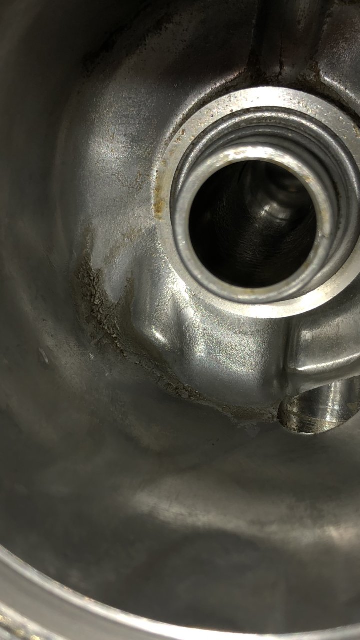

    Is the crack detectable on the outside of the canister?
    The pic on the inside almost looks like from manufacturing, or that is was repaired. If not noticeable on outside and not leaking, probably ok. You may want to get a replacement for next oil change.

    That may just be casting slag on the inside of the block there. Good time to upgrade to the aluminum canister. I’d also be tempted to take it to the dealer and ask them WTF!?

    That's to much grime at 14k, something is unsat..

    Kinda looks like a cosmetic casting blip.

    I’ll tell you this, I never used the free oil changes. And my oil canister never look like that. I change the oil myself every time.

    That's a lot of grime for 14k, I'm at 42k and mine is clean as can be. I'm with everyone else that they never did oil changes, filter wasn't changed or maybe really cheap oil.

    My bad, didn't realize that was engine side. Still think ifrom mfg.

    What is a “casting slag?” I wasn’t aware that the piece could be changed out. Wouldn’t that fall under a warranty?

    Yeah, that pic is the inside of where the oil canister goes on.

    Do you think I should be concerned? It felt pretty ruff. Do you think that could be why there was so much grime?

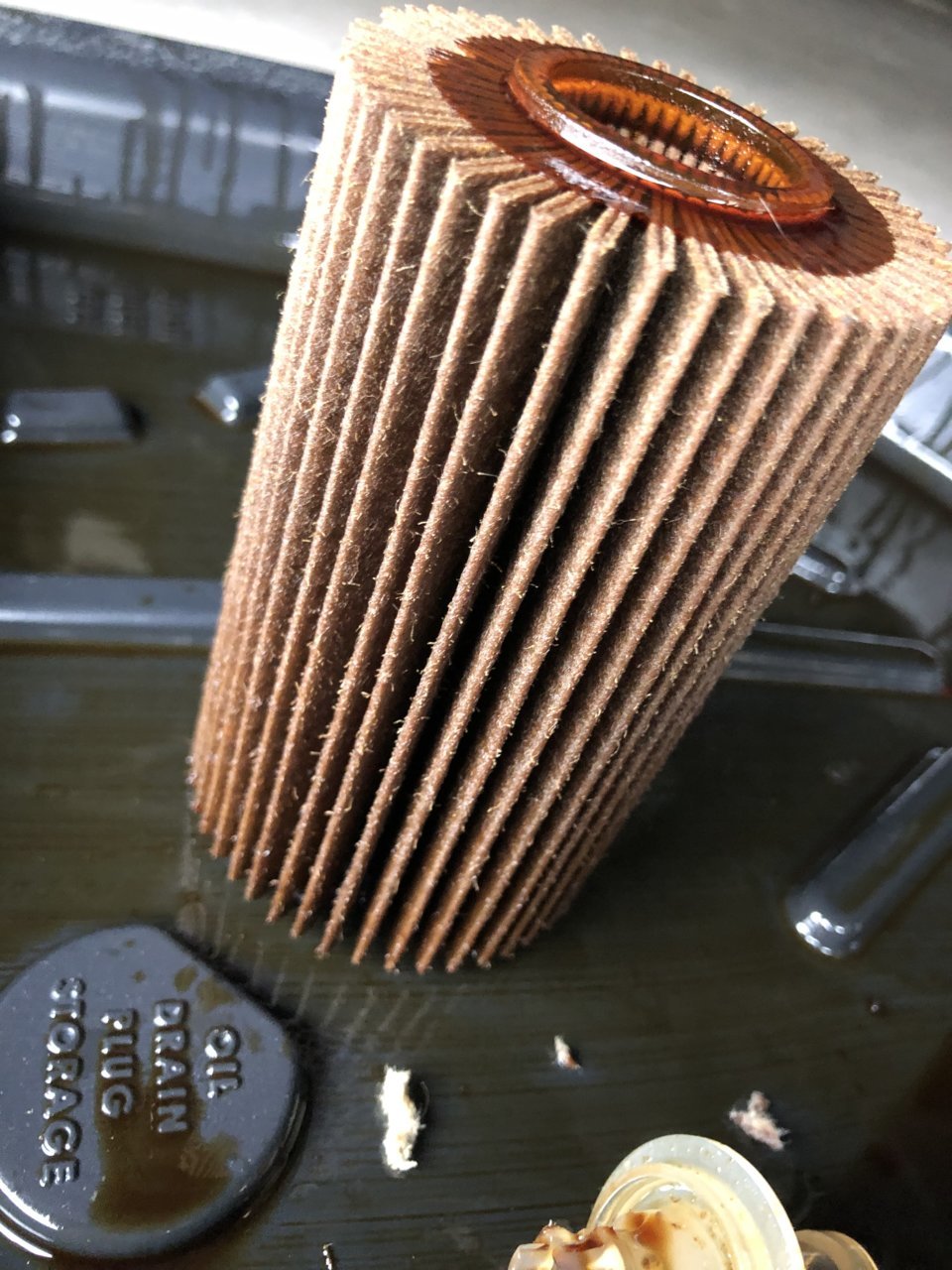

    Here’s a pic of the filter. Those white particles or just napkins I was using to clean up 5FF20E57-9B1A-44FD-9347-C0FF316BB055.jpg

    Yes mostly short trips. City driving. Posted a pic of the filter. Damn that be expensive lol. I use Mobil 1. Like 60 some bucks for the oil lol. I might do that though. I’m someone you like to take care of there things

    Maybe I’m using the wrong terminology. But when they cast aluminum parts there is usually at least two parts to the mold or it’s poured in a sand mold. All the seams and point of pour need to be cleaned up after the mold has cooled. Sometimes they don’t clean it up perfectly.
