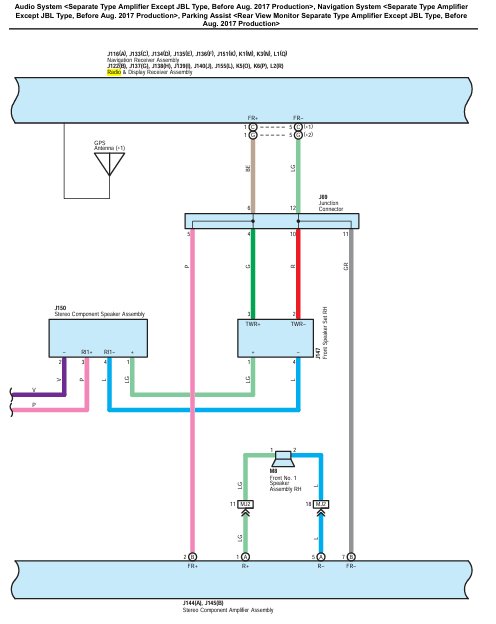

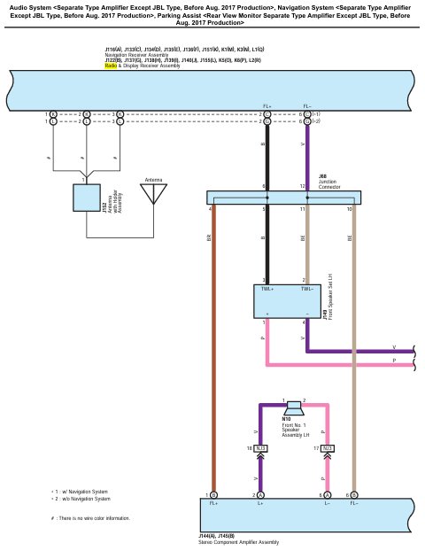

    The OEM wiring has the dash speakers powered straight from the HU and then the signal is split to the OEM amp for the doors.
    The rear door tweeters are the same straight from the HU, then split to the amp for the rear doors...
    That signal should already be full range.
    upload_2025-4-19_16-46-42.pngupload_2025-4-19_16-46-55.pngupload_2025-4-19_16-47-9.png
    As @Tundra1D6 stated, a decent Audio Control LOC/EQ will flatten the signal and also help prevent the bass roll off of the Entune as you turn up the volume.
