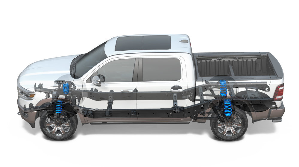

    Apparently there is a coil spring Dodge Ram?!
    If you could find a wrecked Dodge RAM for parts this setup doesn't look like it would be all that hard to weld onto a Tundra really.

    Quite frankly I've heard that the RAM rear coil suspension is nice actually. Rumors are that the tru 3rd gen tunny may be configured with the rear coils ...

    Looks like the Dodge Ram is not independent, so may somewhat limit the benefit? Would be really fun to drive and see.
