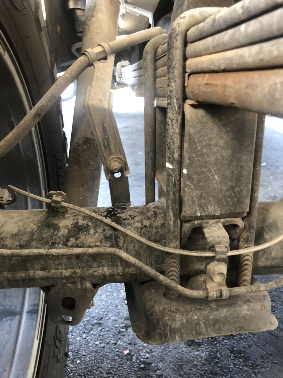

    See that big block under the spring leafs?? That’s evidence of a spacer lift. This is the rear wheel

    Thanks for the photo, Tundra4Pinay. Now I get it. That spacer is huge! I'll take my truck to a shop where they can lift it up and I'll take a look.

    You can just look thru the wheel well from outside, if it's there you can't miss it!

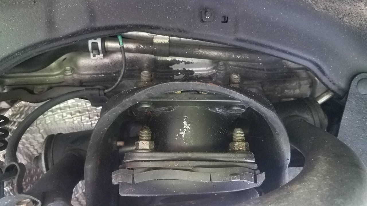

    @LisaM this spacer would be the front of your Tundra
