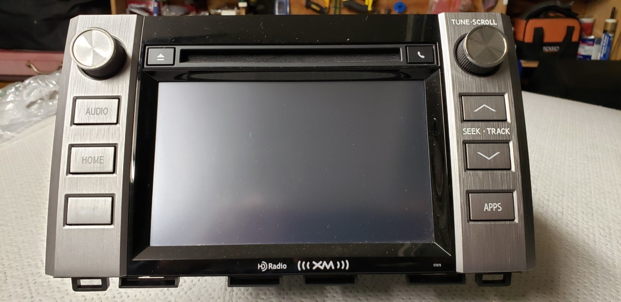

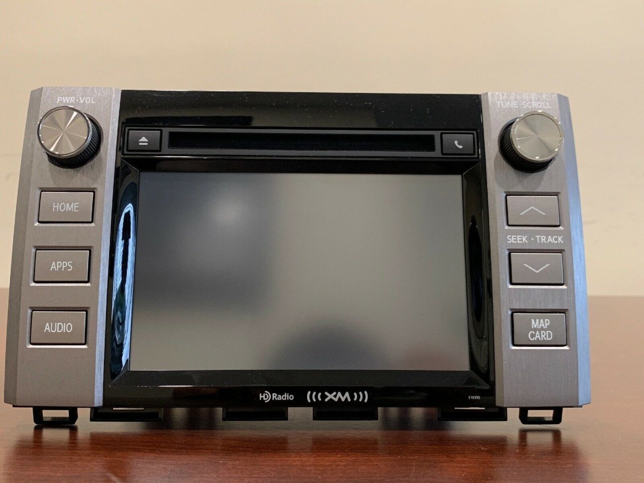

    I did this swap. My original was Entune without NAVI and bought a headunit with Navi (Map Card) button, plug and play - everything works. I didnt need the VIN number of the truck that it came from.
    My Original Unit:
    Replacement:
