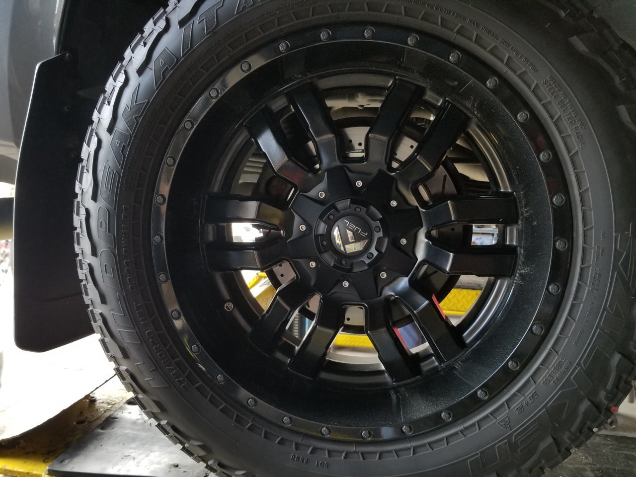

    I have the Power Stop rotors and Z36 pads and would buy them again in a heartbeat. Toyota factory rotors are known to pulsate after a while these never have.
    JoshuaA and 619Tundra like this.
  9. Mar 17, 2019 at 6:31 PM
    58,319
    Oh and they look damn good also! [​IMG] [​IMG]
