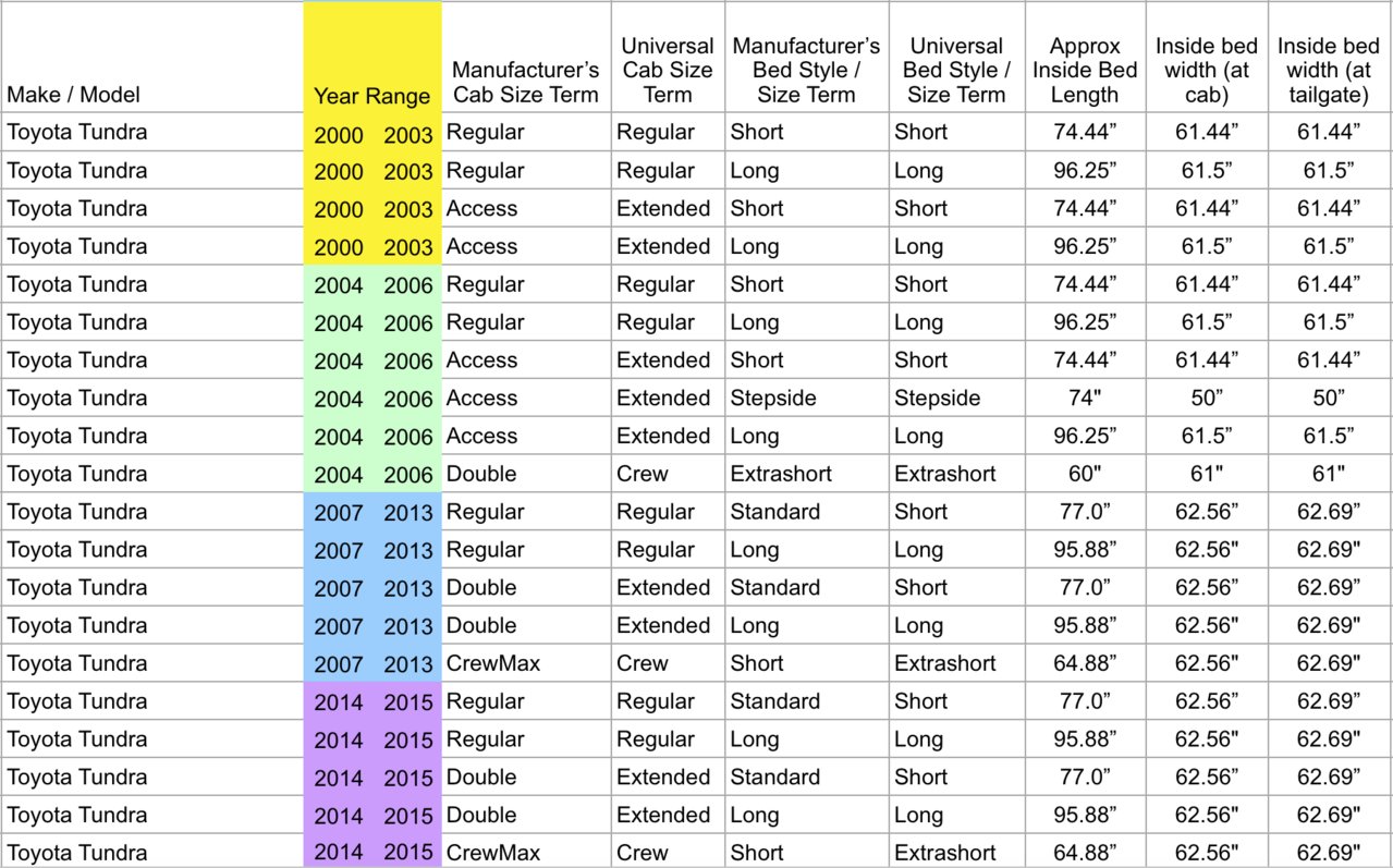

    Would it not matter what Tundra body we are speaking of(AC/DC, SR5, Limited etc.....asking for someone who doesn't know, myself !
    In any case, perhaps the below could help ?

    Well yes. I assumed we were talking about the same cab layout (Access, Double, Regular) and box length (Long, Short, Stepside) on both trucks. If that's not the case, then you don't even need to look it up -- the answer's no.

    Can't answer the question but that chart is not 100% accurate. The 1st gen DC bed dimensions are for sure wrong.

    and there isn't a single cab short bed 1st gen Tundra.
