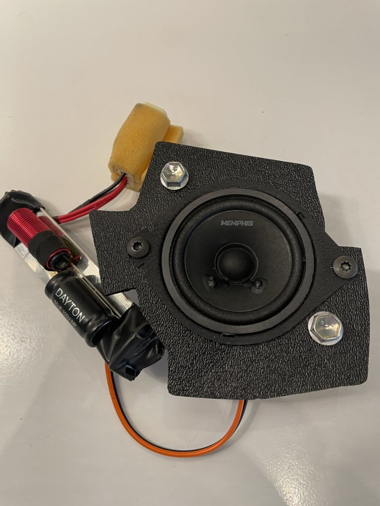

    BandPass Passive crossover for dash and center speaker <800hz>5000hz This will take away lows and highs from distorting stock dash speakers. -$12

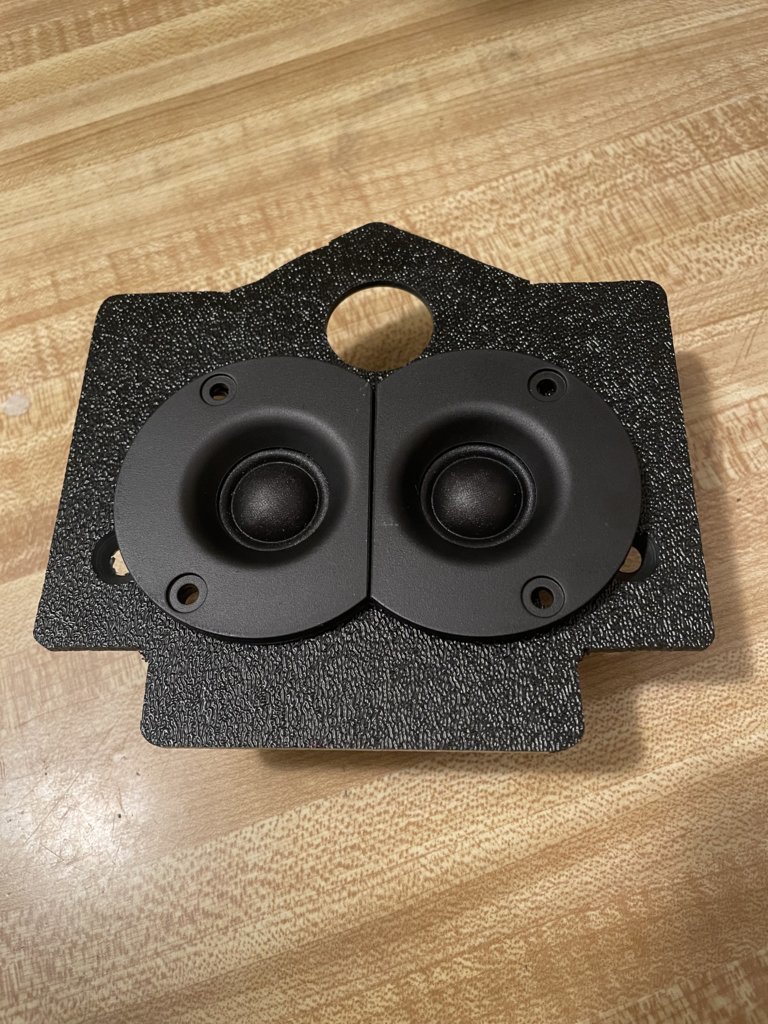

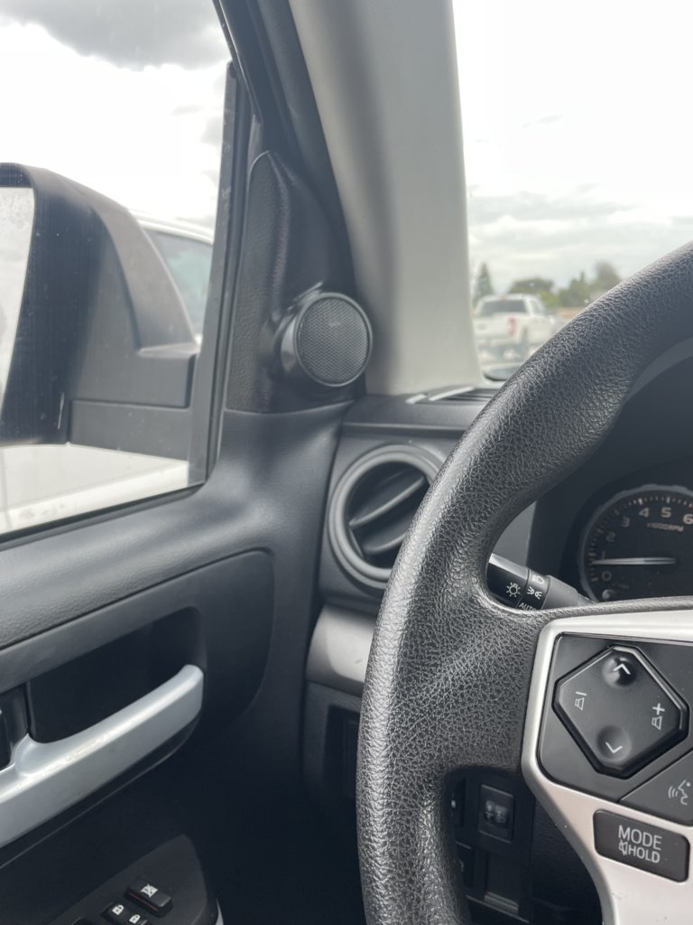

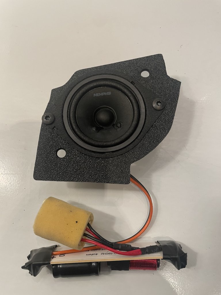

  22. Jul 31, 2023 at 7:51 PM
    SK_MACHINE
    SK_MACHINE [OP] New Member
    May 31, 2021
    #63731
    37
    Wompy
    CA
    2021 DC TRD 4WD
    Scratches on paint, coffee stain on seat, nail in tire, dog saliva on rear windows
    It's been a while but here's a shot of my rear door panels in case anyone wants to know a good location for the tweeter. IMG_4096.jpg
