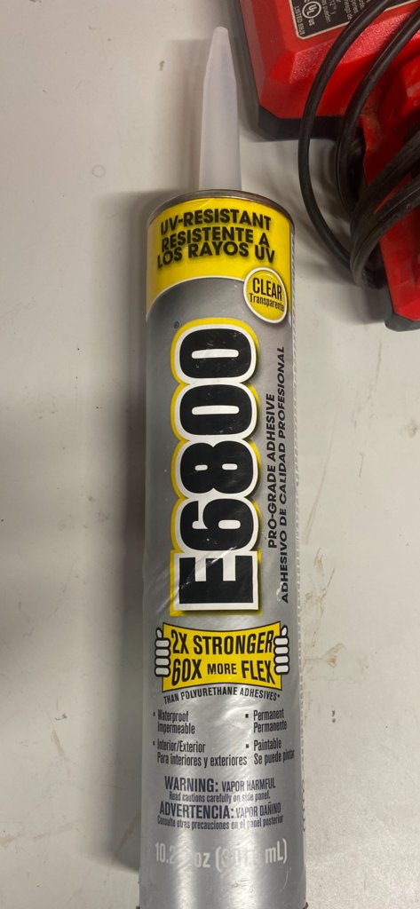

    I think some of this would be a perfect solution. It remains flexible, so you could always cut through it if you need to remove the emblem in the future. It comes out super thick and somewhat tacky which makes it easy to hold a piece in place. I just used some to mount the camera on my front grille, and it's not going anywhere lol. I just put a few dabs on a latex glove and reached behind the grille to put it on the camera.

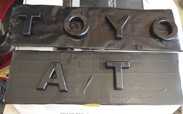

    After having them painted, I used 3M molding tape to reattach my TOYOTA letters on my TRD Pro grille.
    The tape only 'catches/touches' on the inside edge of the letters, but it has held up for over eight years.
