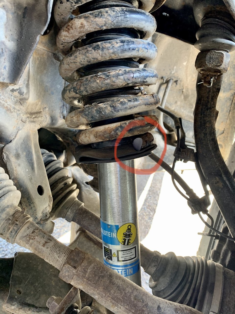

    Mind sharing a pic of this snapped coil?
    You can see where it snapped off the first 3" of the coil spring pig tail...

    Holy crap batman..I would definitely remove that spacer...

    If you have 3” spacers on top of 5100s at 2.5” left setting, there is a crap load of preload in those springs. You’re lucky something else more significant didn’t break.
    I would remove the spacer ASAP. Lots of people sell their stock coils cheap. Check classifieds or Craigslist.

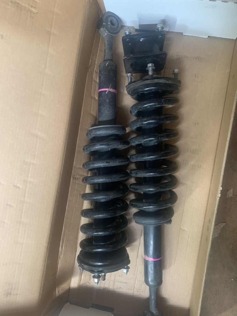

    Here is a picture of a stock coil-over and a spacer. The spacer gets bolted to the top and does not get installed between the coil and top cap of the assembly.
