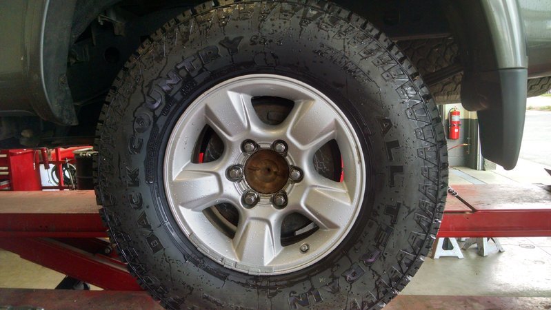

    New tires. It came with Duratracs that were just about carcasses and rode like crap because of it.
    Since this build is headed slightly towards daily driver status, I went with something that was less aggressive and more street friendly.
    Made by Cooper for Deans tires, 265/75-16

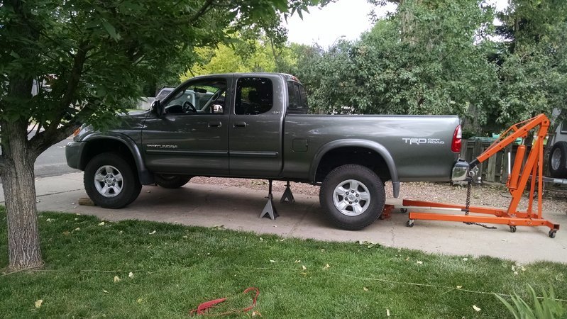

    Safety first, jackstands and tires under the frame in case of catastrophic failure.

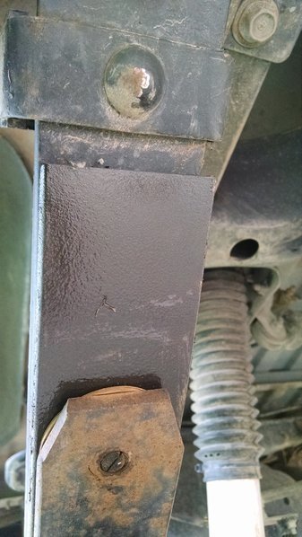

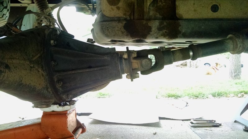

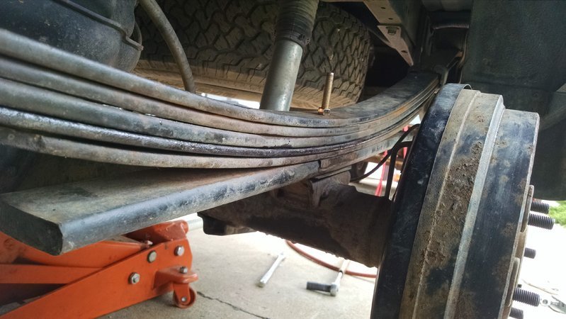

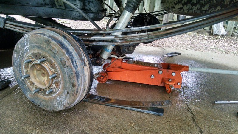

    I added another leaf to the rear pack today. It sits too level for my taste and the load capacity needed to be increased.
    Leaf was a Add a Leaf from a 96 Jeep Cherokee, that received a standard lift pack and I saved the leaf.
    I had to cut the aal down a bit to fit between the stock pack and the original aal from Toytec.
    Safely supported.
    The leaf I'm pointing at is the added leaf from the original lift. The new one will go above that.
    Centering pins rusted all to hell, not surprised. :)

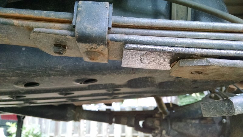

    Overload and original aal out and on the ground in preperation for measuring the new leaf.
    It's wet because I rinsed everything as I went.
    Newly trimmed leaf, I forgot the pic where I had it loosely mounted/clamped to the bottom of the main pack to get the proper marking for the cuts.
    original overload sitting on the new leaf to be added.
    New leaf installed, 4th from the top or 3rd from the bottom, your choice. Yes, it's a little thinner. I wanted just a mild extra bit of lift and a little bit extra stiffness to the rear, it was just a bit soft. Not sure if this will give me what i want, but gotta start somewhere
    Here you can see the distance I trimmed to give it flex room with the stock spring pack retainers. Original aal is back in place underneath the new leaf.

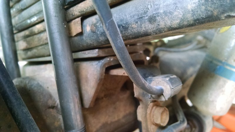

    added a 2 degree shim the rear to get the driveshaft and the pinion in alignment with each other.
    And I was so wrapped up in finishing, I neglected to take anymore pics. I'll get some measurements here in a bit. And some finished pics.
