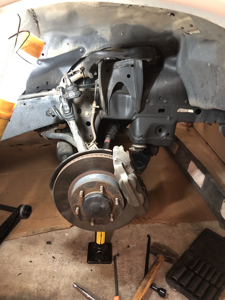

    It's interesting, this just started happening on mine within the last 6-8 weeks. The only maintenance I've done since it started ... I had front passenger side torn down to this point, then re-assembled. Didn't really touch the brake lines or caliper though, which left me scratching my head. Still no clue wtf is going on. Not seeing any leaks or anything loose anywhere. Looks like .
