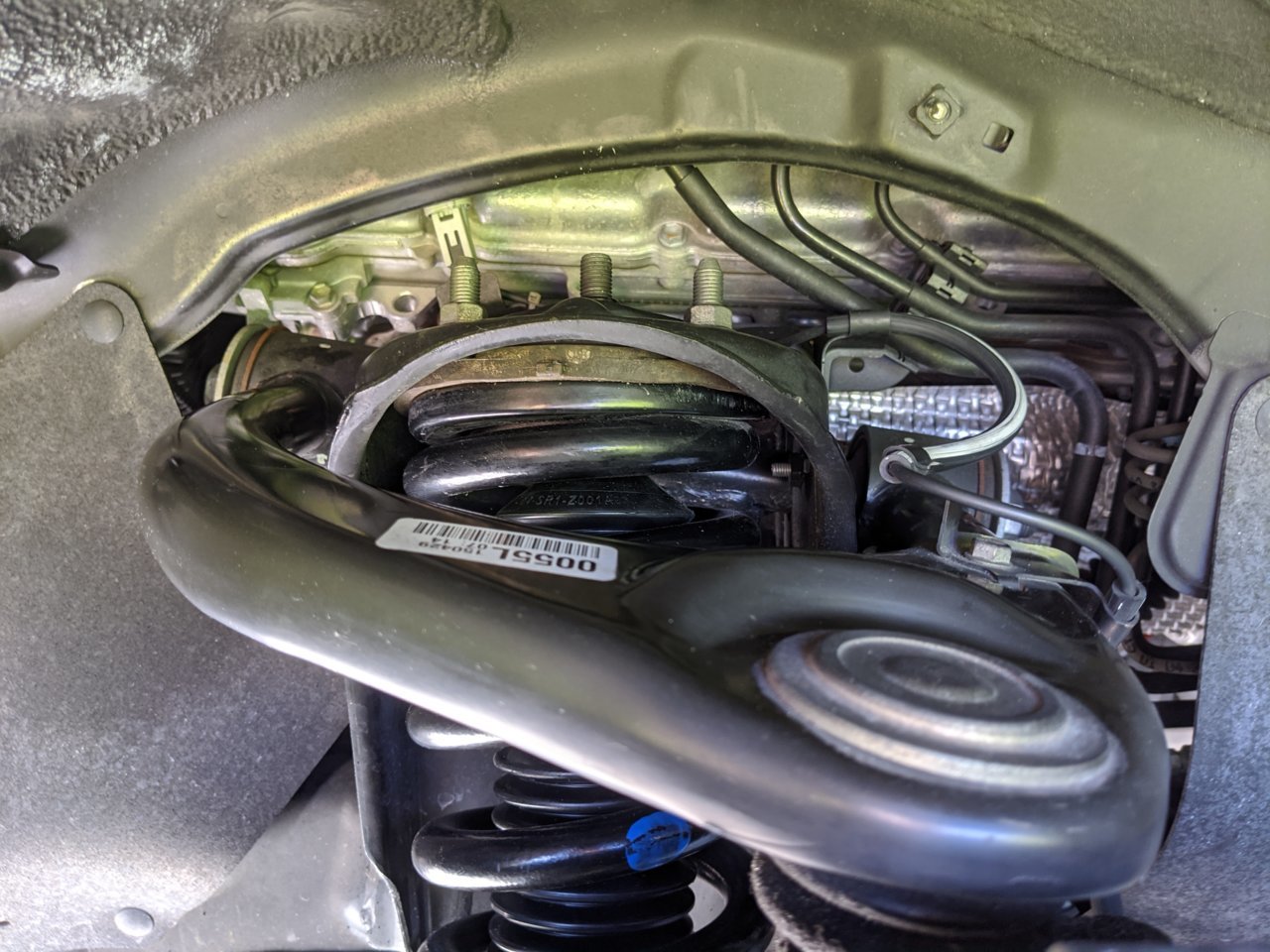

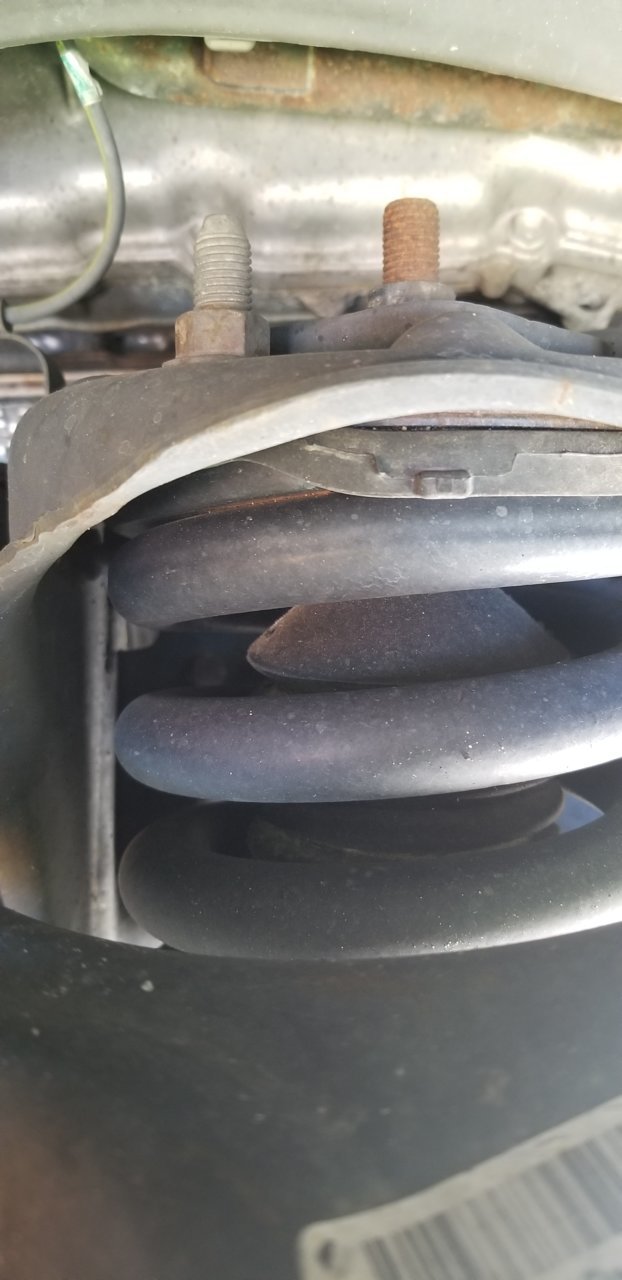

    Hello all. I installed the Blisten 5100 on my 15' SR5 and after a few days of driving I checked and it looks like the rubber bushing that is on the top of the coil-over is protruding downward on the outside on the passenger side. I'm not sure what could be causing this. Any insight? I attached driver side which I think looks right and passenger side.

    Maybe it just got misaligned during the install. Should be able to loosen the bolts on the top mount and readjust.

    Pretty sure you'll have to loosen the center nut that holds top plate on coil over in order to be able to move that rubber. I don't think loosening the 4 mounting nuts will do you any good.
    Your going to need to compress the spring to fix that.

    saw the pictures earlier on the phone but looking at it on a larger screen now and you are correct. The rubber seats between the spring and upper mount so OP will have to basically take the strut apart and reseat everything.

    So... After looking closer once I have it half way apart lol I notice it's in the right place! It looks different because the flat part/end of the coil is on the outside on the driver side and inside on the passenger side. So the driver looks the same just on the inside so you can see it. But I'm pretty sure this is how they are supposed to look. The inside on the passenger is nice and flat like the outside of the driver side.
    Anyone with the 5100's installed care to take a look at their passenger side and see if the bushing is curling down a little?

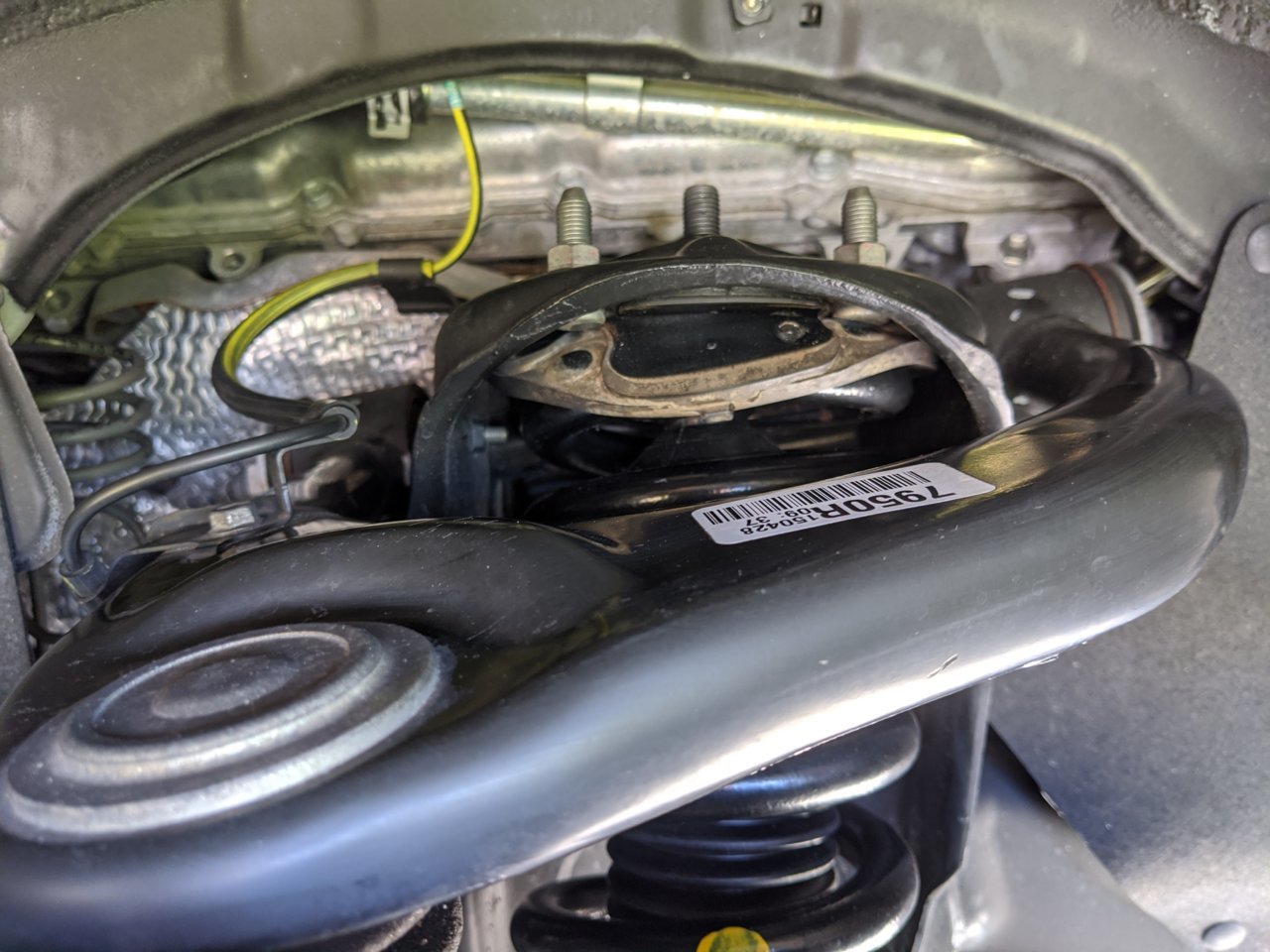

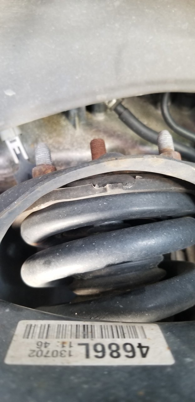

  18. May 2, 2020 at 8:36 AM
    JMB
    JMB Not new, just a little old
    Jan 20, 2014
    #156
    4,658
    John
    Chesapeake, VA
    2013 Super White Tundra DC
    Passenger side
    Driver side

    Wow that was quick! Thank you so much. So I see yours does the same thing as mine just not as much. I'm going to leave it and watch it for the next couple hundred miles and see what happens.

    Mine have been on for a few years now. Never a problem.

    No problems at all. I was reading this thread on my front porch and figured, I can walk 30 feet and get a picture. My son in law put mine on because he has a real spring compressor. I helped some and paid my daughter's phone bill that month. I never really noticed until today. No abnormal tire wear, noises, etc. I've been on the beach probably 70+ times with them. Plus a few trail rides in GWNF.
